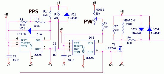

    The problem is when i turn noise pot over the first half of the whole turn for better detection the red led also brightens up and detector just beeps once then gets silent and stops detecting and irf740 starts warming, so when i turn the noise to lower again it starts working normally.
    Also one more thing that may be important the 9v1 zener gives me 8.85v when working normally and 8.2 when this problem occurs.
    Your "noise" pot can be more descriptively called the Pulse Width (PW) pot.
    The Red LED's normal function is to illuminates when your battery is weak, needing recharged.
    But also, for any transmitted PPS (Pulses Per Second) setting, there will be some value of PW that will cause current consumption to exceed the battery's current delivering capacity. When that happens, the battery voltages drops, and the red LED will illuminate. That is telling you to reduce either PPS or PW, reducing battery consumption to a more reasonable value. Or, you could instead decide to live dangerously, and use a bigger battery... but in the case of your FET getting hot that is not a good idea.
    If you have a milliammeter, connect it in series with your DP and the battery. Watch what happens as you change the PPS and PW controls. I have read that a reasonable maximum value of battery current to prevent the FET damage is somewhere around 150mA.
    If you want to be able to have 100% usable range on your PW pot and you know the maximum PPS that you will ever use, you could set maximum PPS, and then modify the value of the PW pot to eliminate your unusable zone. Reducing the value of PW pot (or paralleling a fixed resistor across the pot) will reduce the maximum pulse-width. But you must first determine maximum desired PPS.
    If you want to keep the full range of PPS but also keep the full range of PW, then you will simply have to accept the fact that you cannot use maximum PW and maximum PPS at the same time.
    Increasing the value of PPS pot (or R1) reduces maximum PPS frequency.
    Decreasing the value of PW pot (or C3) reduces maximum Pulse Width.

        You'd better disconnect the FET from 12V drain power and make sure your 556 is working properly. Removing the coil should be sufficient.
        Your current draw should then reduce to about 5~10mA (just a guess).
        Place your multimeter lead on ground, then you should measure about -6V on 556-5 and 556-9. Those pins' voltages should increase slightly as you rotate each's associated potentiometer clockwise. (PPS changes 556-5 voltage, and PW changes 556-9 voltage).
        If you have a frequency meter, you may be able to see frequency changing on 556-5 and 556-9 as you rotate the PPS pot. These two pins' signal duty cycle may be too low for reliable triggering on your F-meter, but try it anyway.

                  Possibly. But first, what do you measure to pins 7 and 14 on your 556? (Those are the the power input pins.) Be sure to put the (-) meter lead at the same place, every time you make voltage measurement.

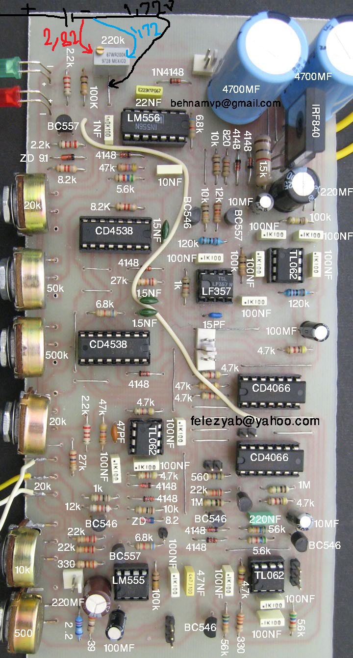

Name:	delta pulse.jpg

                        If you measure 10.76V across pins 7 and 14, that is OK. But that would mean it is impossible to measure from battery (-) and have 1.76V to both 7 and 14, unless you made a mistake.
                        Please show me where to find the exact PCB layout and the exact schematic you are working from.
