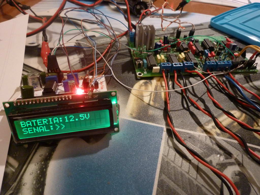

            • PROBLEM WITH THRESHOLD AND SOUND
              Hi to all,
              A Problem:
              - With threshold pot, all left = 0..1 -> No sound - but Detection 100% (LCD)
              - With threshold in 2..4..10 = I have sound and detection = 50%... or less....
              I changed BC557, NE555 and nothing at all ....., a good idea?
              Regards.
              Ger.
              • Originally posted by berreizeta View Post
                Hi to all,
                A Problem:
                Regards.
                Ger.
                in DP THRESH works strange way... you have not be wondered it. always set/leave THRESH in middle position, or slightly left-right. only in the position S.A.T. (or autotracking) works optimally and properly. if you will be hunting and DP will work OK you can note that THRESH is not so effective as at hunting begin. it is normal, do not wonder. that is the normal SAT autotuning.
                • Hi KT315,
                  My DP worked the same as yours: perfectly, with a low and deep sound, but now he has gone crazy.... looks like Maria Callas !
                  -> 8V2 zener, what voltage should be , in mine = 0V ¿?
                  Ger.
                  • Zener solved.... Maria Callas still singing....

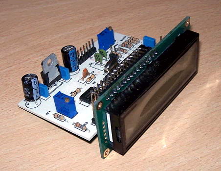

                      • Hola José,
                        Lo he terminado hace un par de dias, a que te refieres con el forum ??
                        (Google-trans):
                        I've done a couple of days, do you mean with the forum?
                        Saludos
                        Ger.
                        • Hello Berreizeta
                          He asked if the LCD seen in the photo, is the version published dom44 forum. Or if other version, you are using?.
                          thanks
                          Jose

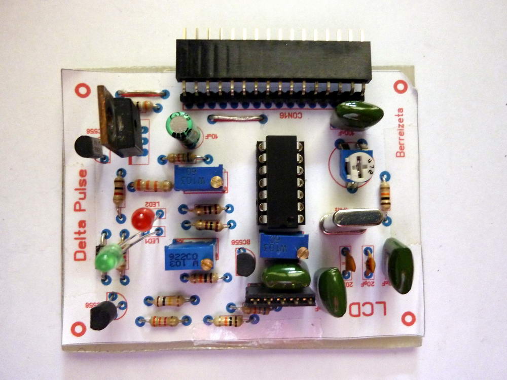

                          • Hola José,
                            No encuentro ese Foro, si puedes ponme el link.
                            Este LCD es el mismo de teknolojibiEkibi (sin discriminación!) y ligeramente modificado para mayor facilidad de montaje.
                            I can not find this forum: Dom44, if you want to put me the link here.
                            This LCD is the same teknolojibiEkibi (without discrimination!) and slightly modified for easy of assembly.
                            • Sorry José, Dom44 located! yes is the same circuit.
                              LCD Teknoloji Ekibi "with discrimination" ::
