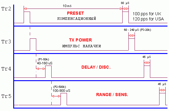

            1.My DP if work at 100 Hz then the period is 1/100Hz, = 0.01s = 10ms
            The frequency of original DP is 100Hz, so
            2. Tx Power.... I measure 140 ... 410 uS. Before 1 week a friend sent me a DP on the Turkish one side pcb. I measured the Tx and it worked at 60 ... 350 us. Maybe the component tolerance gives these diference.
            3.All the DP that i had had a delay sample of 30 .... 110 us. But you did not answered me if you find the 90 ... 170 us delay time OK?????
            4. Second sample delay.... At XR71 the potentiometer is 220K and at DP is 500 k. So the problem is what potentiometer do you have. I use a 220k potentiometer so my times are OK. And at on the other side on the field if the 2nd delay is > 300 us it is Ok for every electric field!!!

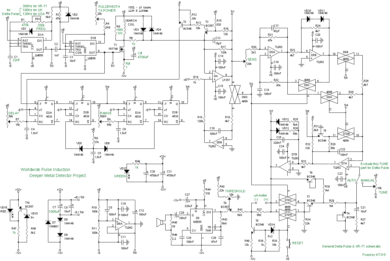

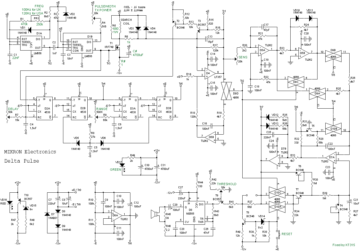

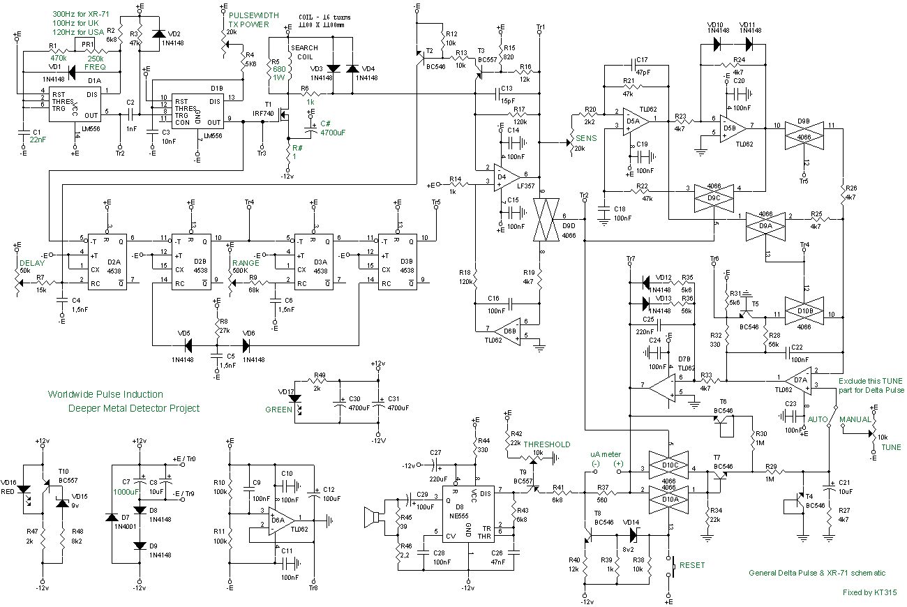

                • uuups! SORRY THAT I DID NOT FIX THE TIMES!!! I was thinking it is not so principially, but see you are so agressive I fixed it!
                  i give also right schematic.
                  • Hi KT315, i build deltapulse and work very well (mounting plain of elbombaci alt_yol.pdf, yerlesim.pdf, renkli.pdf). I see your new schematics but i dont see the big electrolitic capacitor of 10.000 microfarad. were is it?
                    excuse my english
                    • fixed again. connect capacitor what you have of amount. it is not principialy but take it on maximum. you mean probably C30 & C31.
                      • FIXED DeltaPulse SCHEMATIC ?!!!
                        Hi kt315
                        i see your new fixed deltapulse schematic...
                        did this fixed schematic is better than older? in performace and depth ?
                        i want build a good MD for best depth... did deltapulse is good for building or you have a better idea? please guide me ...
                        thanks...zenit52

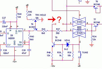

                        • What are these points?
                          please guide me about this,
                          in deltapulse schematic what are these points?
                          thanks...zenit52
                          • Originally posted by zenit52 View Post
                            thanks...zenit52
                            the points are to connect the meter

                              • look fixed DP & XR-71 generalized schematic!
