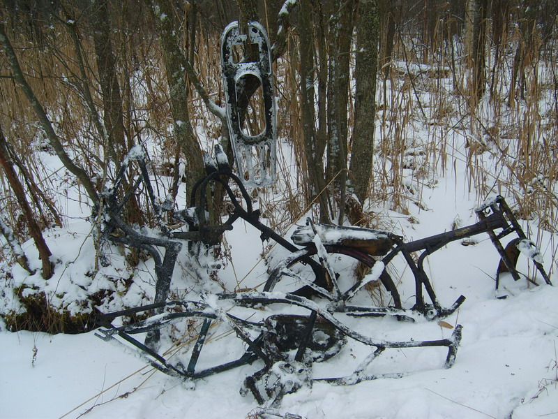

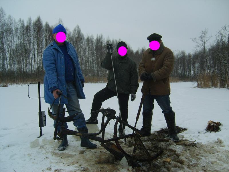

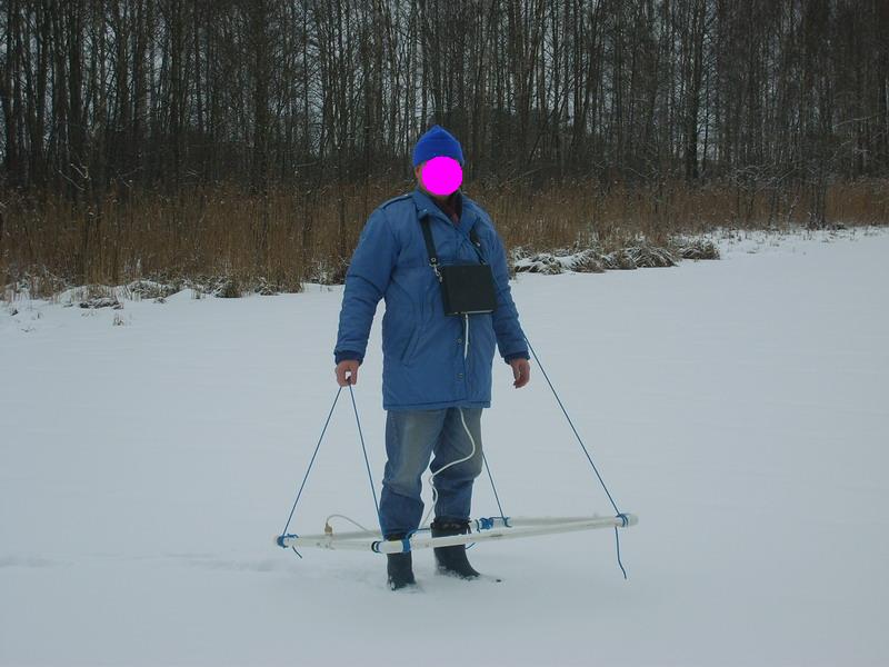

                  as I promised to demonstrate some result with DP so you can see that. but enough poor on value the things has of DP shows fantastic sensitivity. seems there was not limit on a deep it does. it took a bike carcass on more than 2,5 m. DP has really more sens than TF-900, all signals were been searched by both detectors.
