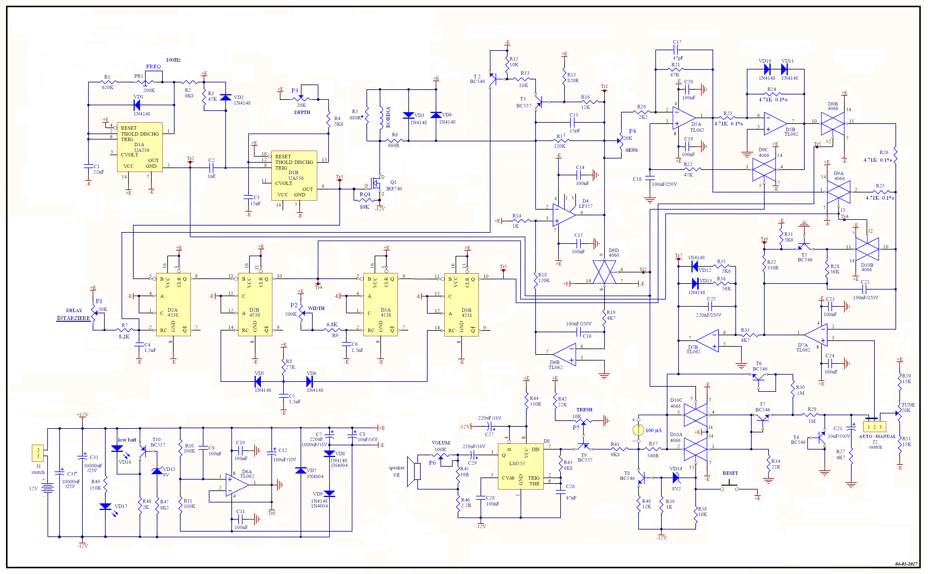

        Q7, R36.
          SNIFFER XR71 in brutal force style. okey. принимается. кто хочет - тот увидит. кто не хочет... значит не Судьба.
          Q7, R36.
          I may be wrong but...
          Mistake №1 pnp transistor Q7 will be all time closed (untill button presed) and feed true tiny 100uA uMeter about 3000uA. Transistor Q7 must be NPN version.
          Mistake №2 Any zener diode (and ZD2 too) need some minimal current bias to work properly that is usualy at least 0.5mA for 1W zener
          Lets calculate current with 12k resistor U=12v-8.2V=3.8V 3.8V/12000 = 0.0003A 0.3 mA! to low!
          Voltage on uMeter will be very temprature dependable.
          Did Q7 PNP will go in open state if "Fast zero" presed?
          Lets calculate voltage on R37 12K*0.3mA= 3.6 milivolts. 3.6mV will do nothing with Q7 even if "Fast zero" presed
          "ZD2, R37, R36, Q7" dont make any change for main functionality, except they add battery udervoltage monitor, and do that with Q7 NPN version usualy.
          Sorry for my leakage of knowledge if so i was wery bad student indead.
          Did i passed your examination?

              • Mr. kt315 I only analysed schematic Sniffer_XR-71_sch.pdf which was new for me, and "trying to see " as was writen in the post #3693
                If i had this schematic in 2002, or MD pirat at least... I soldering as hobbyst already ~25 years (from 7years), but all circuits i have was only soviet books about audio and radio, radio and audio until 2008, let all them burn in hell... My closest to pi detectors circuit was Chemelec battery desulfator in 2015, then was SurfPI, last year Clone PI-W and Delta.
                Offcourse if i don't understand circuitry for at least by 50% - i don't build it.
                Yours respectfully.

                      • Vadim 18 .... This scheme I made myself, check the values ​​and I assure you that you will have the highest performance.
                        Have a nice day.
