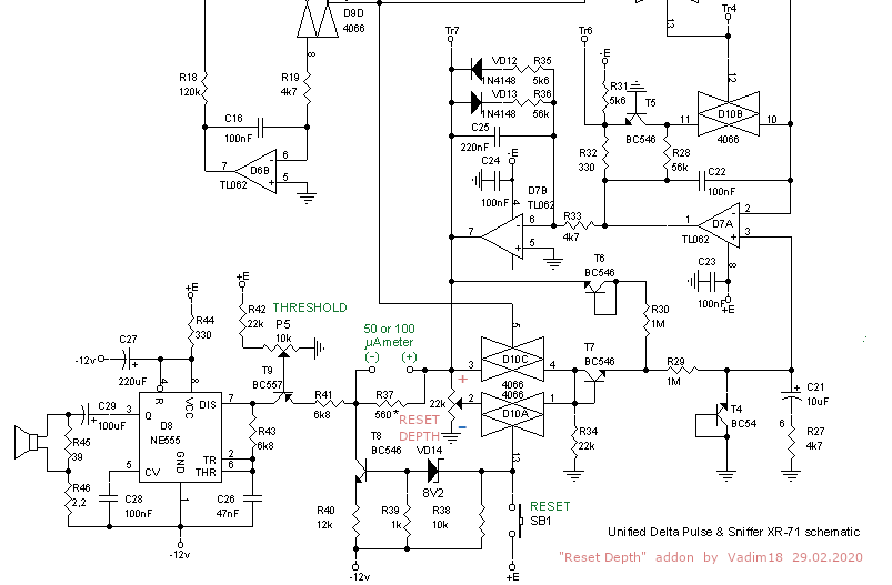

    • My small contribution to Delta Pulse (D.P.) "Reset Depth" addon.

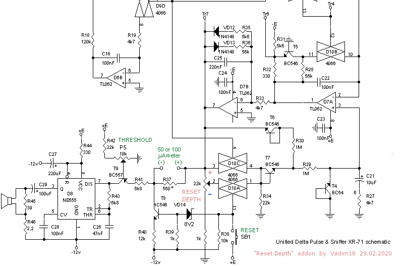

      Problem
      long time for treshold recovery needed after pressing "RESET" button, which are usualy more than 5 seconds.
      Final sensitivity in D.P. are very treshold level dependable. Sensitivity are optimal when VCO click rate are about 1-2 Hz, which is corresponds to more than +1 volts on pin 7 (D7B)
      Reset button usualy do deep reset, down to minus 0.3 volts on pin 7 (D7B), thus long time needed for recovery to optimal voltage and click rate.
      Solution
      Added trimpot R 22К to negative feedback loop, to adjust final "reset state" voltage on pin 7 (D7B).
      Changes in schematic
Name:	Delta_Pulse_XR71_ Reset_Depth_Addon.png

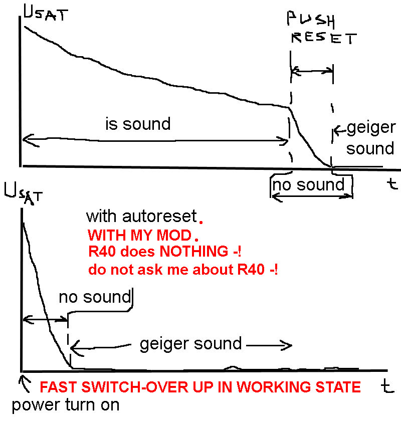

      • you need pressing RESET, i do not. second pic shows how mod works. Click image for larger version

        • If i proper understand, you telling about Autoreset at power on, this is 100% must have.
          My addition will help to limit or fine tune reset button to not let "over do" reset work.
Name:	Delta_Pulse_XR71_ Reset_Depth_Addon_v0.2.png

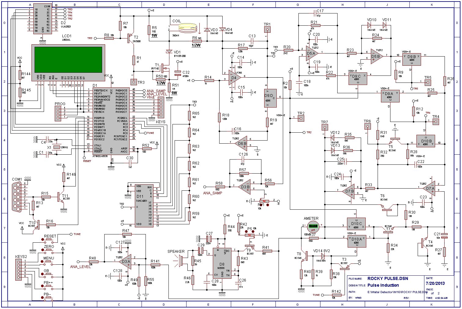

            • Thank you, another question, how can we eliminate the noise generated by the irf740 switch?
              • where you get a noise?
                  Both ends of the coil output a large noise glitch signal, and the entire signal must be jittered.

                            • hi anatolij
                              can you give me more info about rocky puls?
                              • ahaha! and free HEX with board for 5$. nice deal bro.
                                sorry, thats all i have - those files. try follow all way turkish guy had passed - from DP2 to DP3S.
                                you had learned DP work and now you can do microchipo project. and never share HEX with us! this is main rule!
