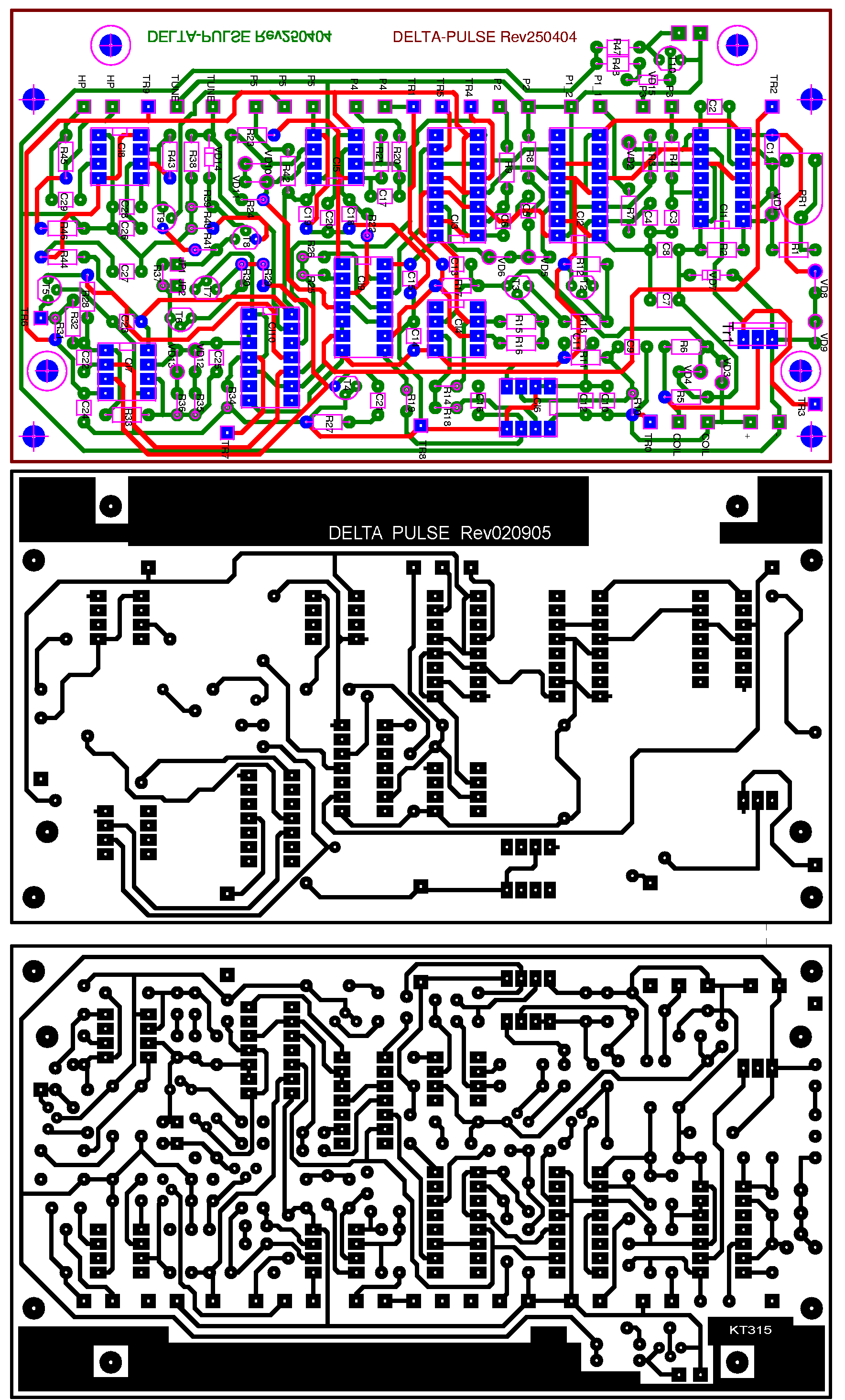

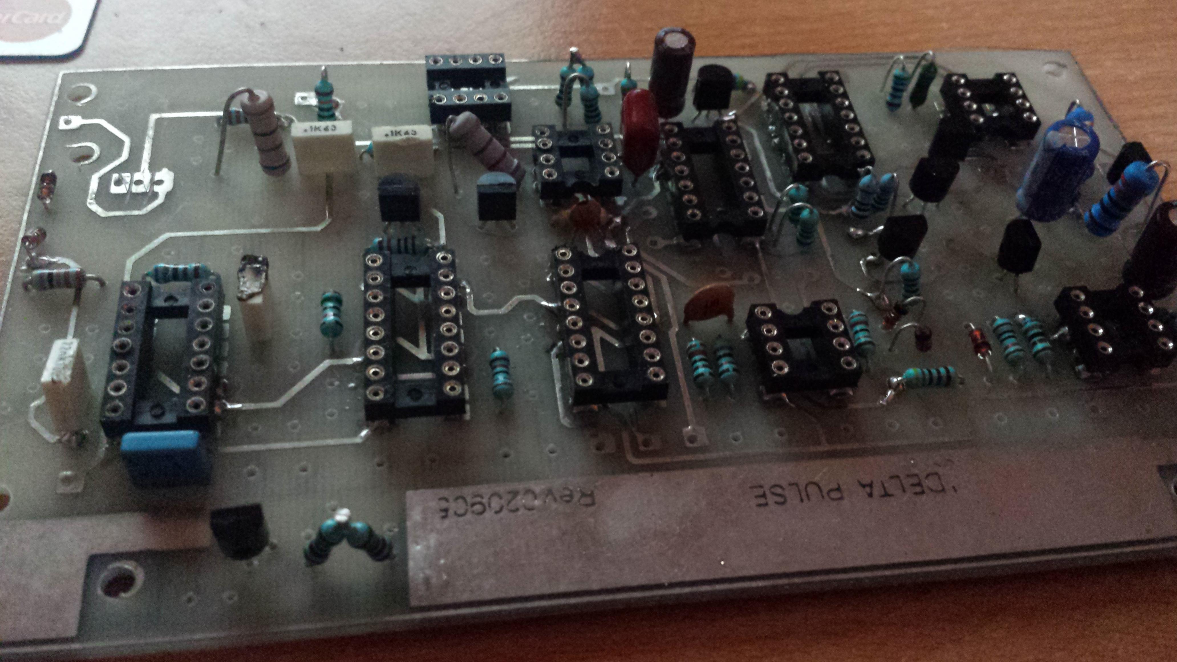

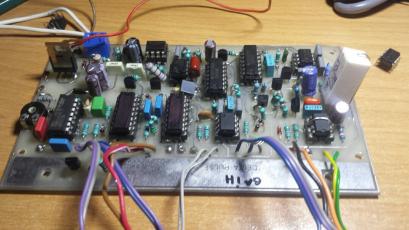

              • Does any have closer photos of this delta board? It is 2 sided board from 2006. year.Click image for larger version
                  This?
                  • keep all in one place.
                    • Originally posted by DELAY888 View Post
                      [ATTACH]43096[/ATTACH]
                      This?

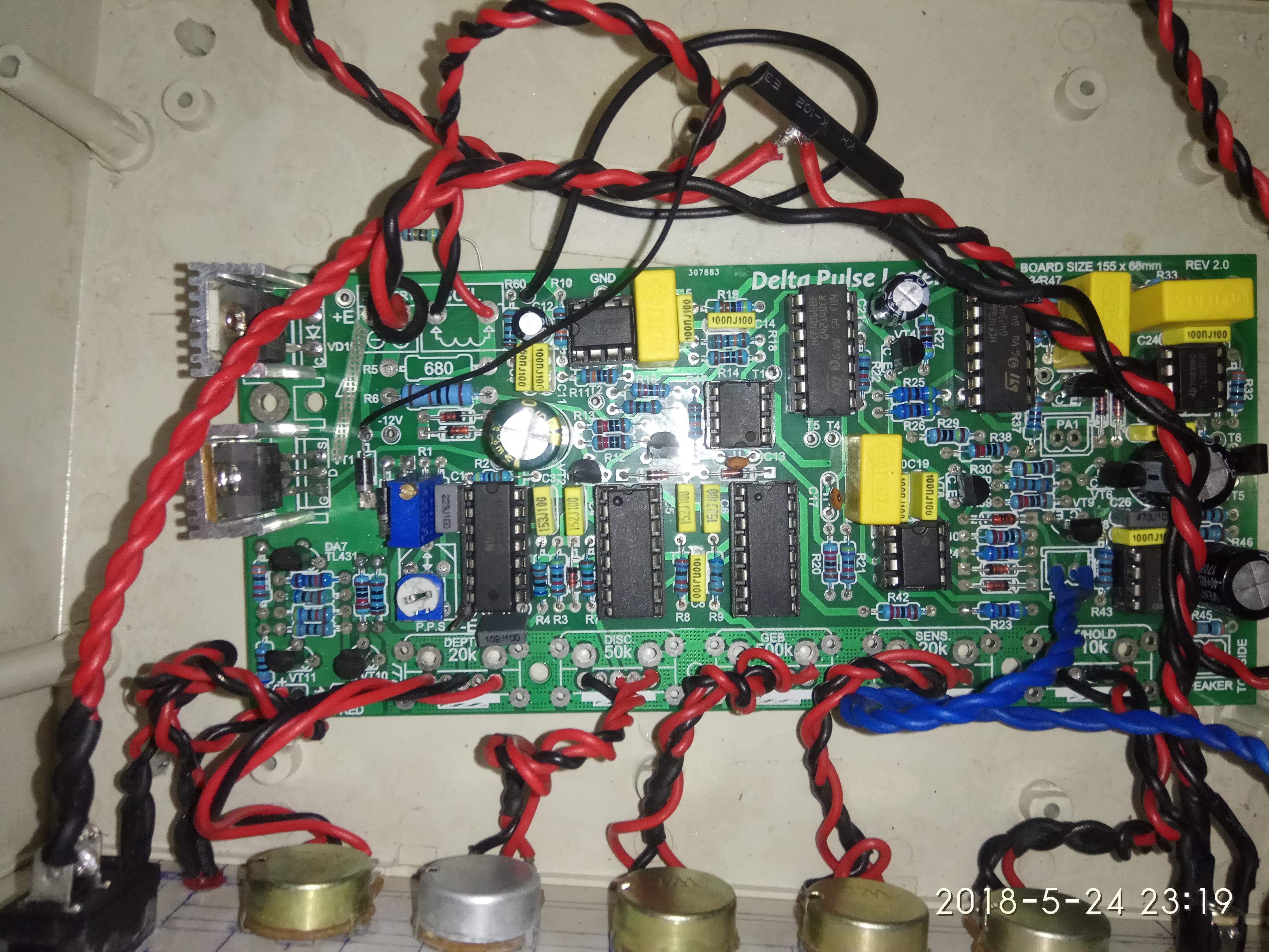

                      Yes, exactly that version. I have problem, board is not dead, but missing some voltages.
                      Also, thanks kt315 for those photos.

                        • Nice board the original drowing is made by kt315
