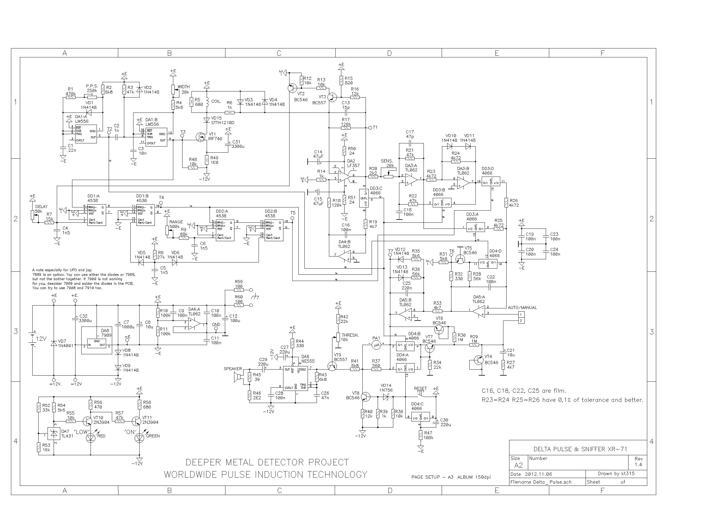

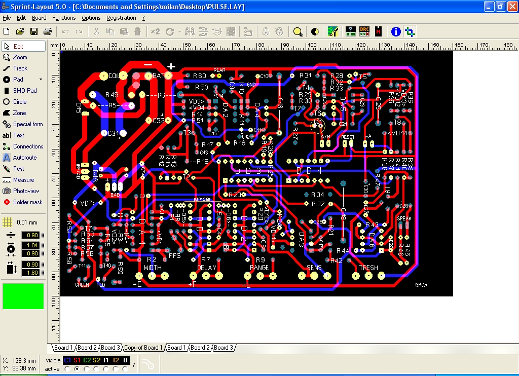

        • Hello KT315
          It's almost over, so if you have the time check and I'll finish it tonight kit
          I'm glad that there are people on GeotecClick image for larger version

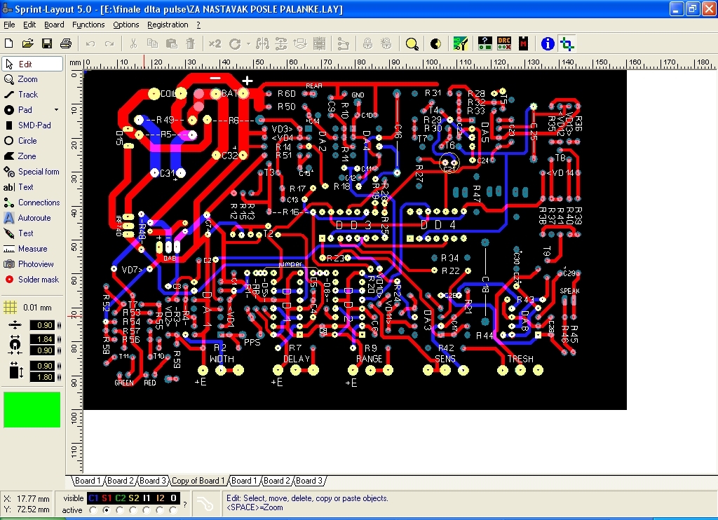

              • still not finished PCB but there is still little to zavrÅ¡i.ko ia a Greco tell the correct time to
                question:
                DD2 goes where pin 7, 8
                DD1 pin 7, 9
                Which is better IRF740 IRF840 or
                C14, C15 reverse the poles sematić
                DA1 goes where pin 7
                DD1 pin 8 goes to the E-SE does not
                DD2 pin 8-E or not
                VD12 R36, R35 VD12 way or the error
                Thank you for your answers

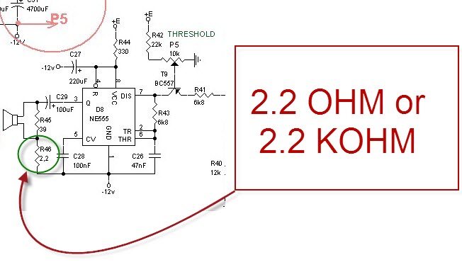

                      Hi Jap
                      still the same problem I have tested almost all
                      let me know R46 = 2.2 Kohm or I misunderstood 2.2ohm
                      it is a confusion

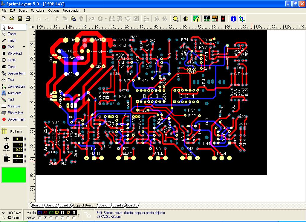

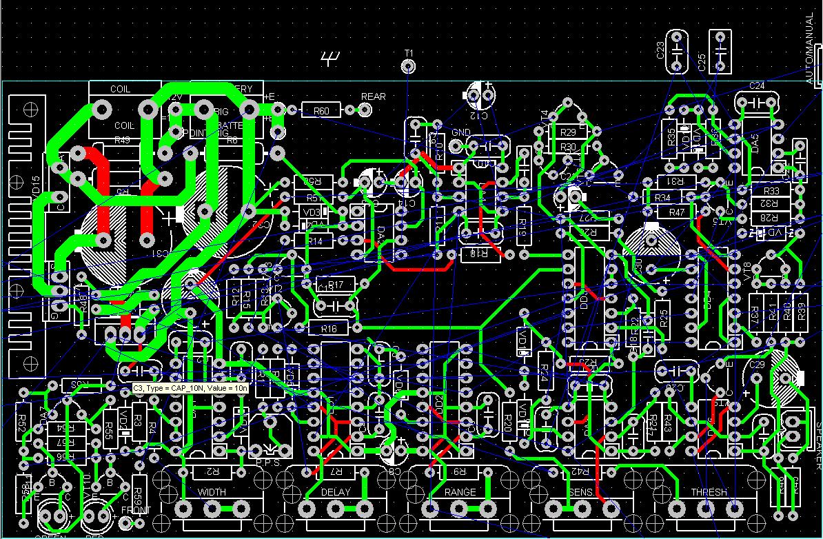

                      • Hi all
                        I finally finished the PCB design for the KT315.
                        question
                        free pins of the IC remains free to them or something goes
                        vd12-r36 and r35-vd13 wrong or vd12-r35 and r36-vd13?
                        DA3 and DA5 (TL062) to E-5 to pin or not?
                        C14 replaced iC15 place or not?
                        Does anyone can hang a picture C16, C18, C22, C25, and STTH1210D 7909 because it is in this crazy looks Serbia components purchased by first vendor show a picture and then he also seeks orderHere is the PCB, so if something does not wave a fixClick image for larger version

                        KT315 thanks to the scheme

                            It is 2.2 ohms.
                            • last revision I play with.
                              yours
                                It is 2.2 ohms.
                                Hi Ivconic
                                Thank you for answering
