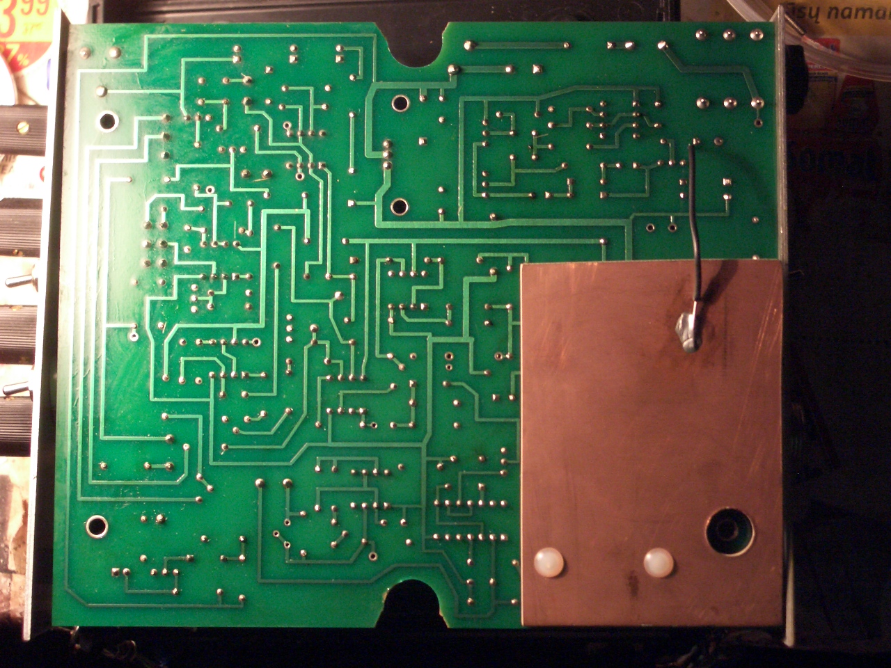

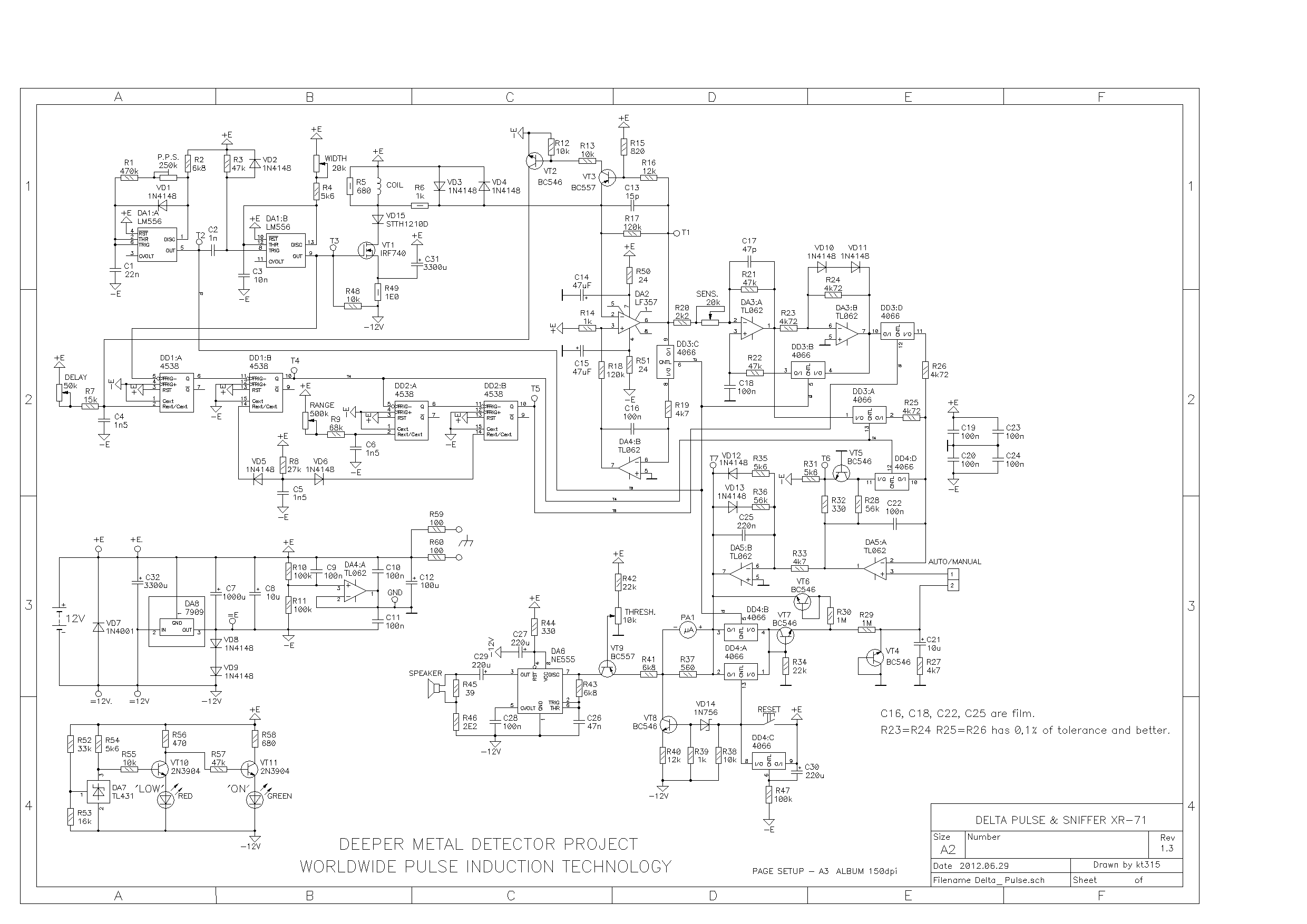

    About one unstability I did meet of and fight with.
    On winter Delta worked only good, but now not I waste much time on a decision, but seems have got an answer. There is some kinda pickup from operator body. You have to shield the PCB. I did put a copper foil under the PCB, clued it to bottom of box and grounded by wire to schematic's (-E). I also grounded falsepanels via resistors 100 Ohm, those are aluminium done. Now DP works great.
    yours

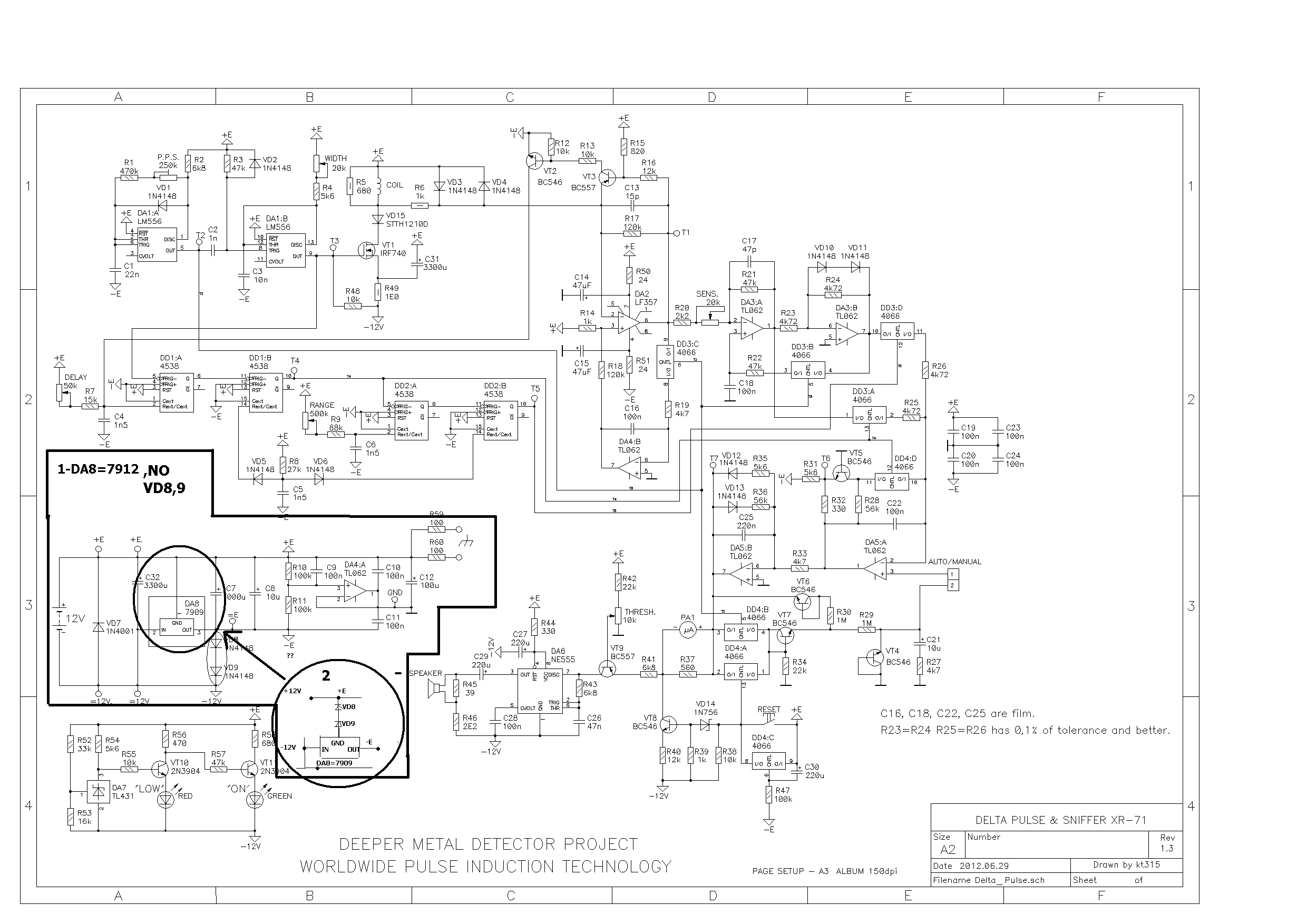

          hi raf33,
          I am glad you appreciated my note. because the shielding is REALLY IMPORTANT for the stabile work. I did due like it is done in Deepers 10DD. here is fixed schematic - R59 R60 has to be connected to +12V like to Deepers. look my photos in Deepers thread, you have to notice the wires between the points at PCB and falsepanels. there is a shield plate under the PCB - look at photo. it is grounded directly to +12V.
          • That schematic is full of errors.
            • It seems pretty doomed this project, ever since the first version came out a few years ago, its been full of pitfalls errors, but saying that, them who dares wins maybe oneday.
              The Minipulse 3 was full of half truths and failures but with determination and not giving up, I turned it around and made quite a nice machine, far as I know proberly the only engineer thats actually made a fully working version of it on Geotech.
              All im doing now is perfecting a nice coil to marry up to it, then shall post a fully working project of it on here with all the errors missed out.
              O and by the way this one does detect small gold rings etc even with a very basic 6" coil unlike this project.
              • the schematic now is ABSOLIUTELY and CLEARLY without mistakes.
                do not abuse the people, PLEASE.

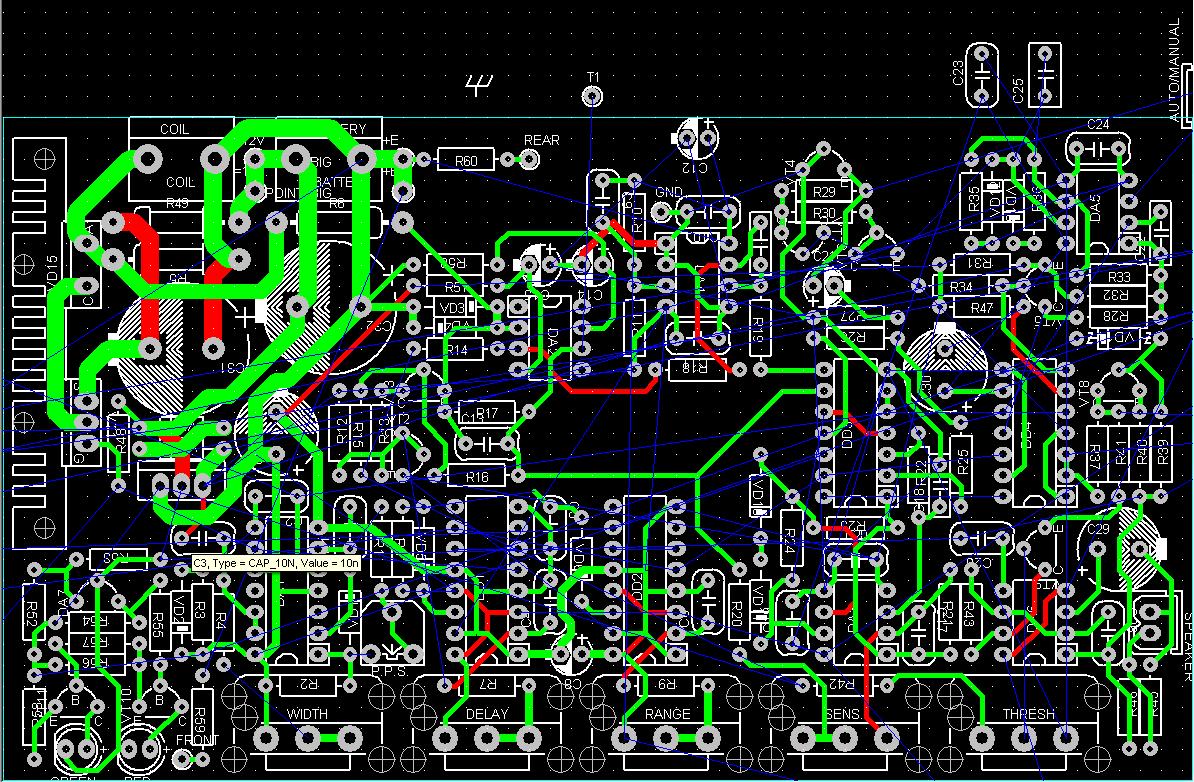

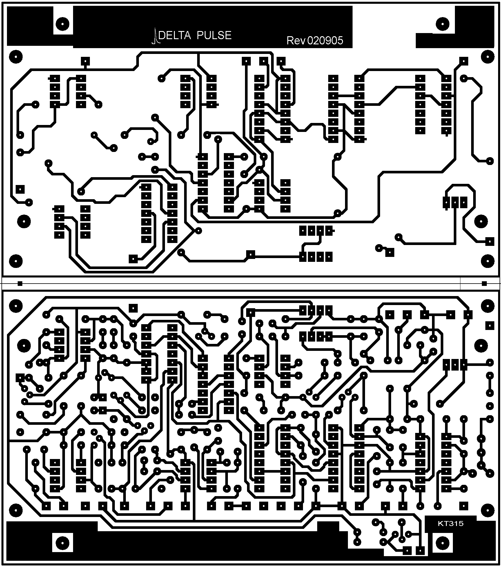

                    Hi KT315
                    is this the last revised PCB ?
                    • PEOPLE, CAN YOU WAIT A LITTLE? I do all as far as in me lies you all will get NORMAL WORKING AND TESTED PCB.

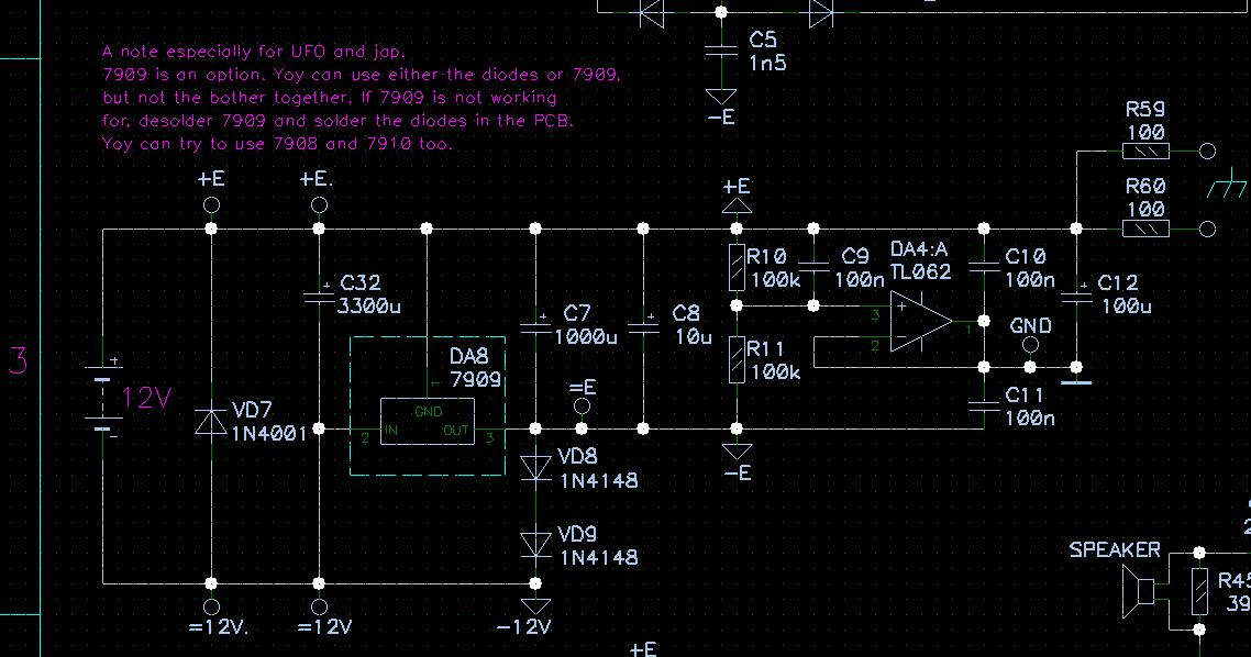

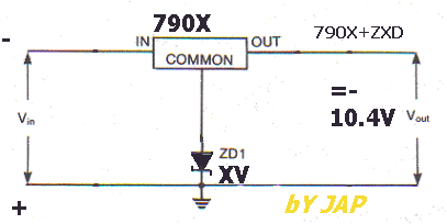

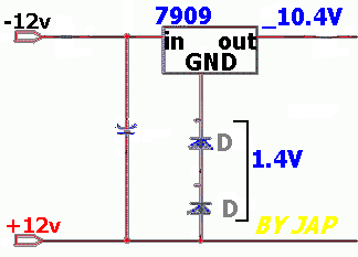

                      • Hi kt315
                        I have two choices 1 , 2 to get a -E.
                        I hope their research.
                        best time
                        j.
                        • Originally posted by jap View Post
                          Hi kt315
                          best time
                          j.
                          whether the two diodes facing correctly?
                          • mistake for VD8,9.
                            Correct the mistake for VD8,9.
                            Can be an alternative to the two by zd.
                            best time
                            j.
                            • Originally posted by VUJO View Post
                              fixed.
