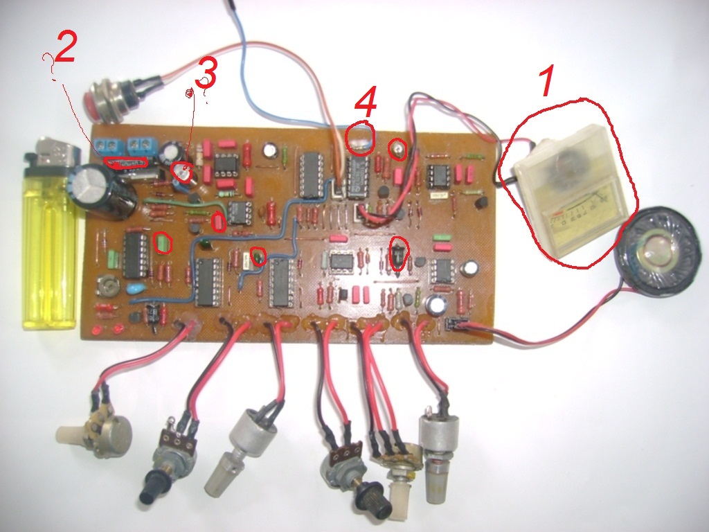

    I test the circuit and (IRF740) heat and smoke ............ I dont know where the problem
    ______
    1-can I dont use the ammeter and replase it by what??
    2- is this Diode ?? what is the type of it ??
    3&4>>>> ???

      set trimmer POWER or PULSE WIDTH on MINIMUM before you do anything. in another way you will get that Magic Smoke out, living in the transistor but leaving the body out if his owner does not wish be teaching.
      1 - certainly. do not use uAmeter.
      2-4 - turkish people are TOO active in this thread. they had made NEW DESIGN, I do not know it and will tell nothing you about their PCB. it is why I call this PCB design TURKISH (ie absoliutely unknown for me). please ask turkish men directly.

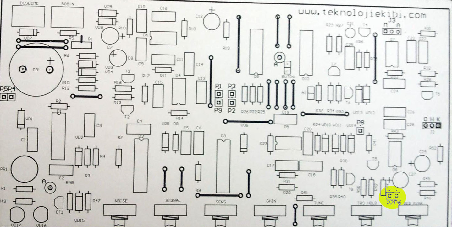

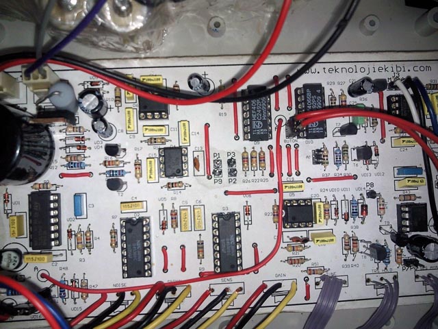

            • Hi to all
              I had a bad mistake
              I had a Short circuit between p6 and p7
              I replace any components and my delta work now but it didn't sense gold only
              It detect Iron , silver and ... but not gold !!!!
              its decrease on depth and sense
              I'm confuse
              please help me

              • Originally posted by freedan3d View Post
                Hi to all
                I had a bad mistake
                I'm confuse
                please help me
                Freedan3d
                how much a size of coil you use? do you not see a reaction on gold or there is poor reaction but you are waiting more?
                • Hi kt315
                  It's my honor to talk you
                  I use a rlc meter and winded my delta coile with 475 mh
                  I tried a several coil and it had a good resolt
                  My delta detected a 90% gold coin (16mm diameter) from 25 cm in air befor my fault.
                  In lcd install process i connected p6 and p7 for 1 minute or more and after that my delta dosen't detect anything.
                  At last i changed t9 and d8 and it come back again but it sense is now weak and it dosent detect gold only too.
                  Please help me to fix my dear delta !!!
                  Best regards
                  freedan3d

                        Please explain something. I found P6, but where is P7?
                        • In lcd install process i connected p6 and p7 for 1 minute or more and after that my delta dosen't detect anything.

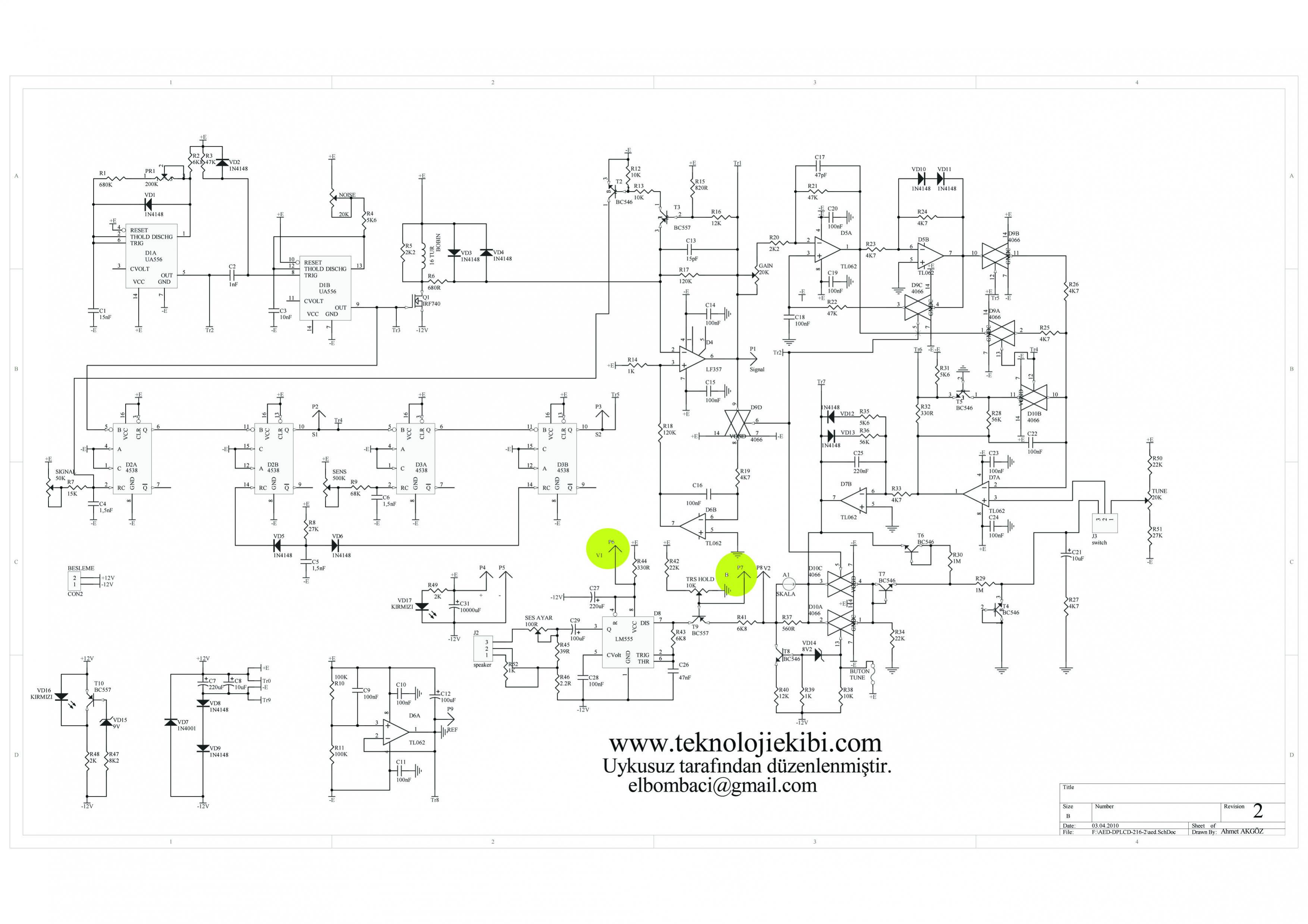

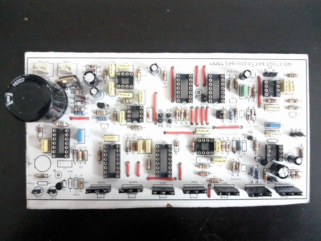

                          I am not following the update with LCD PCB... can you explain what is p6 and p7 (test points? connector's points? pots? jumper? LCD pins? IC pins?), give a schematic of LCD board and all connections LCD board with the analog main board? then I maybe able to give you a prognosis in your trouble...
                          • Hi kt315 and porkluvr
                            Thank you for your reply
                            I show this points in schematic and pcb view
                            this points connect together for a short time (about 1 minte) in my mistake
                            I want to fix it
                            best regards
                            freedan3d

                              P6, P7 for speaker or not?
                              • The speaker is on J2
