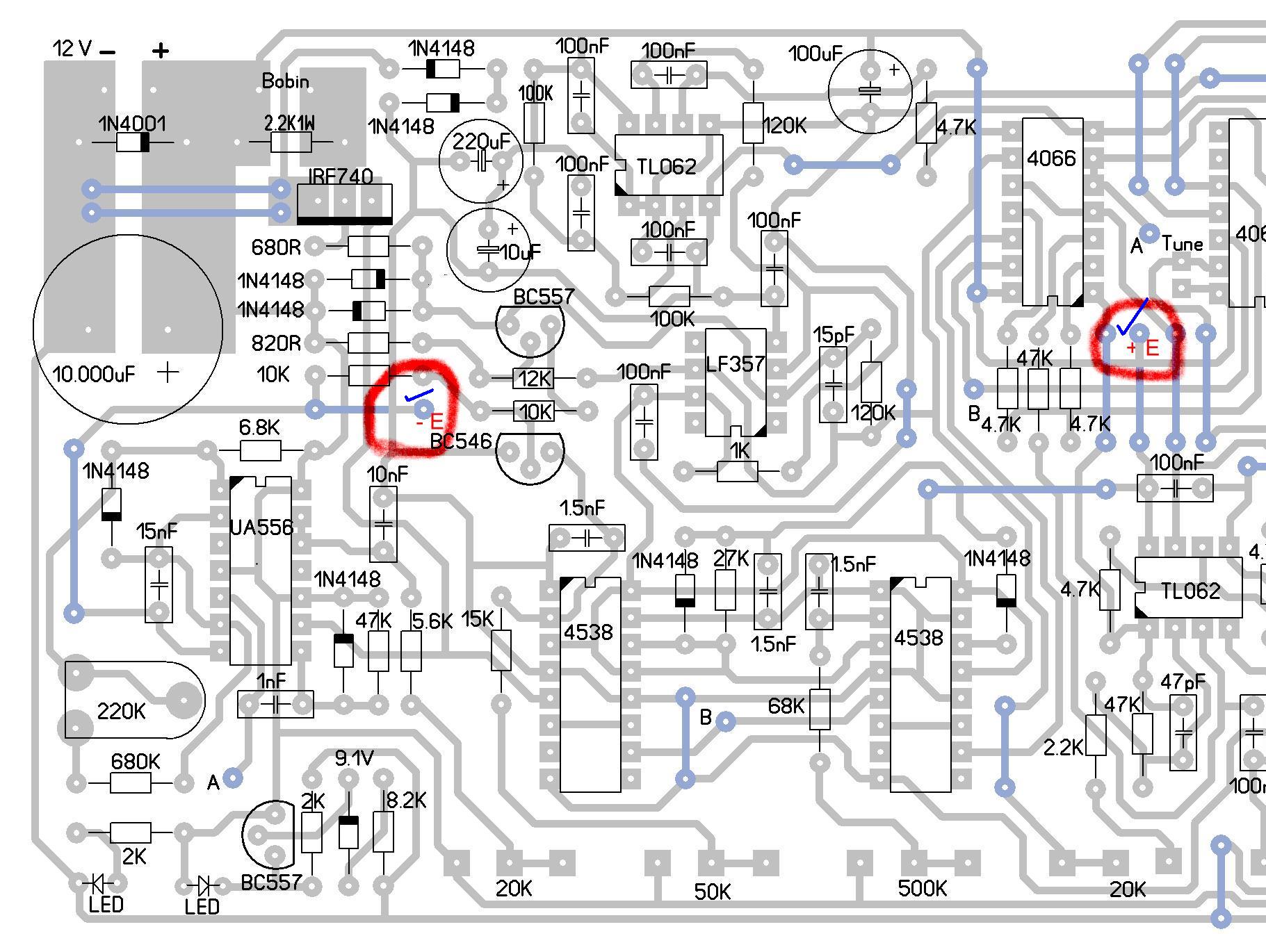

                • Hello to all
                  What are the two straps? According to the diagram, they are connected to the + and - E. Is this correct?
                  All photos there is no visible connection.
                  With my thanks and greetings.Click image for larger version
                  • Hi Freddy67
                    Yes,,,two are OK
                    best time
                    j.Click image for larger version

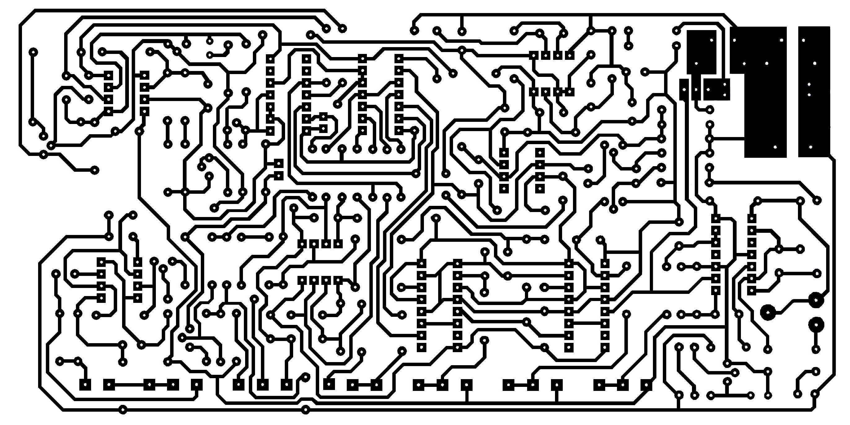

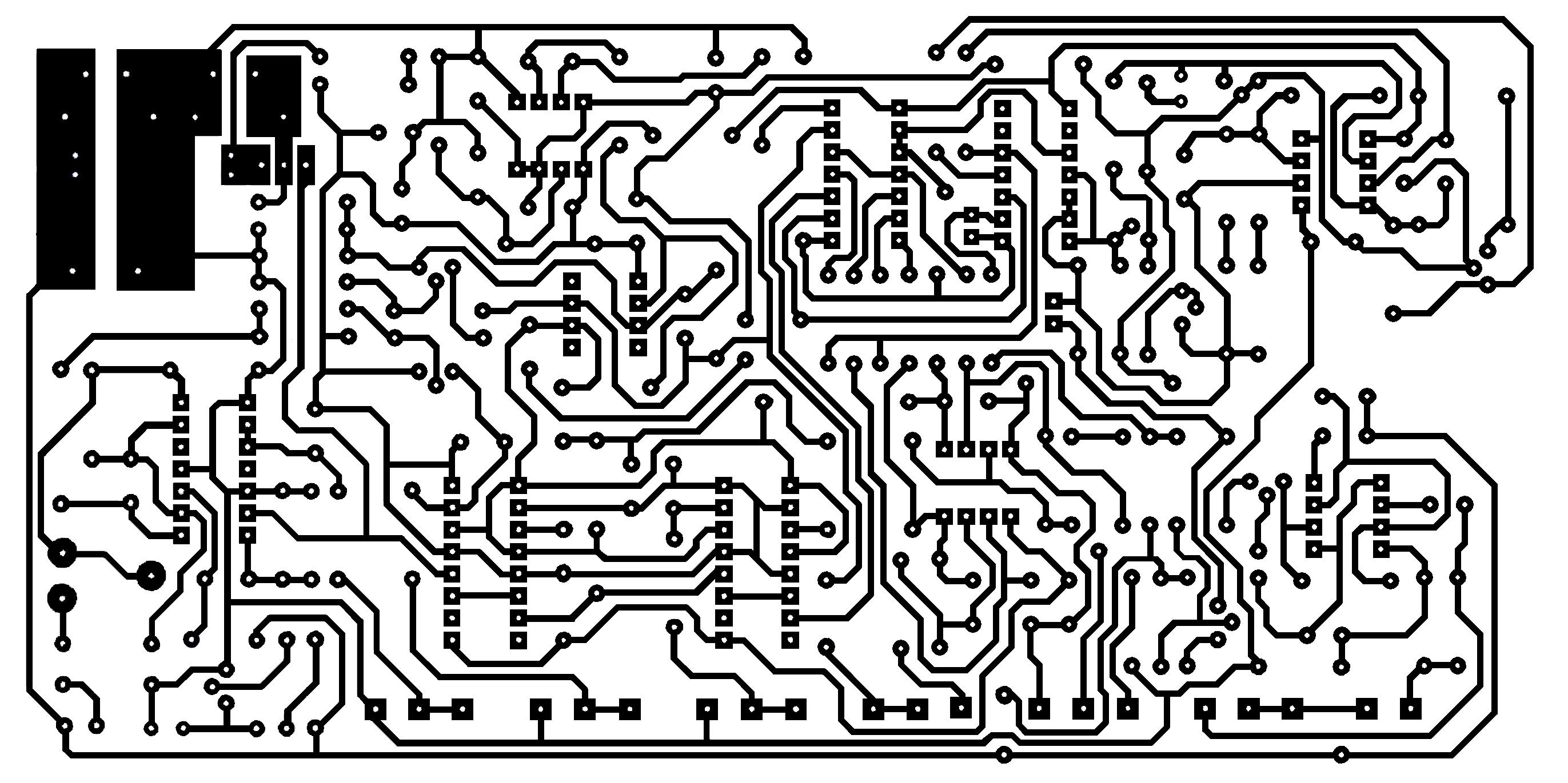

                    • Hi and thank you very much Jap.
                      It was to be sure.
                      Enclosed the circuit Jpg. As I can not open the file .. lay, I am amused to remove all the components and redraw the circuit in black with Paint .
Name:	Delta Pulse.JPG
                      And reverse
Name:	Delta PulseReverse.JPG

                          • Hi Freddy67
                            THE First will be used directly for printing and does not need to be reversed
                            This importance,,,,
                            best time
                            j.
                            • Hi Jap
                              It depends if the circuit is irradiated, if we use the method of iron or if you draw by hand. It is better to have the two versions.
