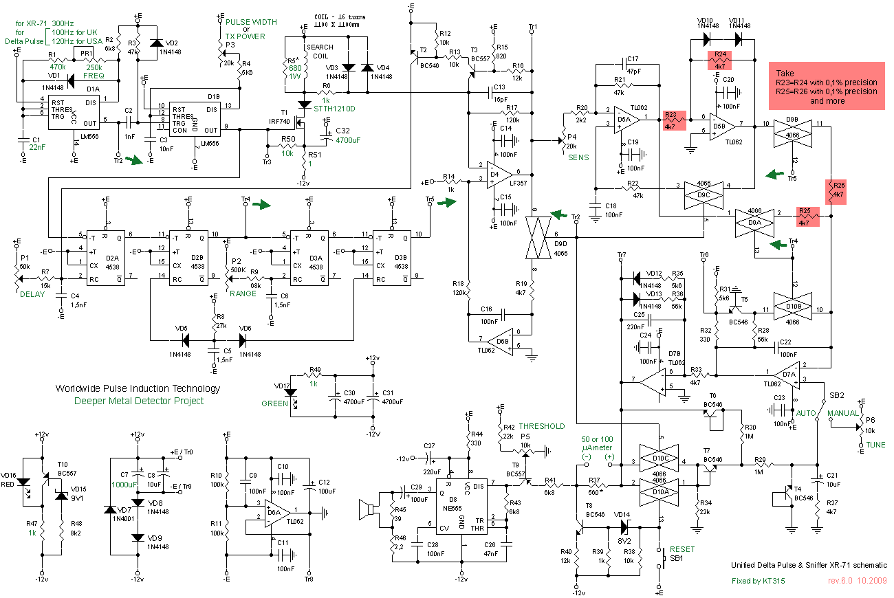

    No! You must realize that by using the IRF740 the circuit will usually have a peak voltage close to 400V. That would destroy the 1N4001 very quickly. You also have peak current somewhere around 2~3 amps depending on your pulse width and coil. That also eliminates other 1N4001 series devices. Don't be cheap, or else you will blow something up! Also, soft recovery is recommended in addition to being fast.
    Digikey carries the STTH1210D diode for about $2.00 and they ship to most countries if I am not mistaken. This particular diode looks like a very good choice. There is nothing wrong with using a bigger diode than needed, so long as it can fit.
    THANKS ..i will try to make it best as possible,,any cost lol I have my hand on STTH1210D where to put it.? and have they used 1n4001 as replacement for stth ?

      I believe the 1N4001 might be the reverse battery protection diode VD7 and has nothing to do with the IRF740 drain circuit.
      You should correlate your PCB parts placement with the schematic diagram. It looks like your schematic and the partial parts placement diagram you posted are for two DIFFERENT versions.

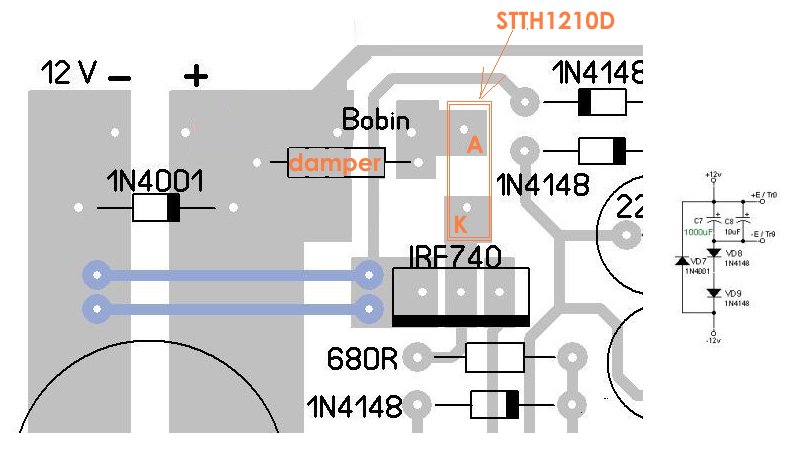

      I am showing how I think you need to modify the PCB layout if you want to incorporate the STTH1210. It is not on the original PCB layout so that means you either need to change the layout or else 'kludge' the diode in.
      I make no guarantee of accuracy but am trying to point you in the right direction
      My picture does not address the 1 ohm resistor which I believe is missing from your PCB parts placement guide. You might need to make another change on the PCB to accomodate that resistor and the 4700uF connection!
      It is up to you to correlate parts placement with the schematic if you intend to build this project. I don't think it is a beginners project, even more so if you choose to implement modifications that have not been designed into the PCB!

            Yes, I only just now drew that placement modification - just so you can see how I might do that. I am not extremely familiar with the DP PCB layout so I can only hope that I did not make a mistake.
            Sometimes it is not worth the time it takes just to make something look pretty. Better: be practical, and do whatever it takes. To "kludge" is OK if it works!
            Just start with the basic plan and analyze each modification piece-by-piece. You'll get it!

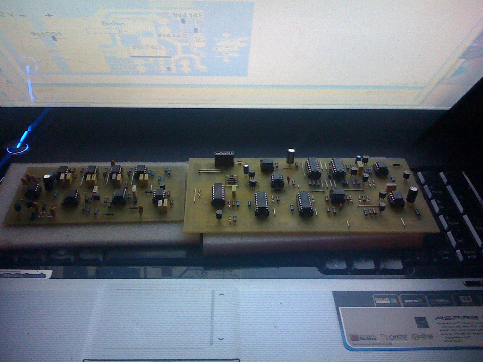

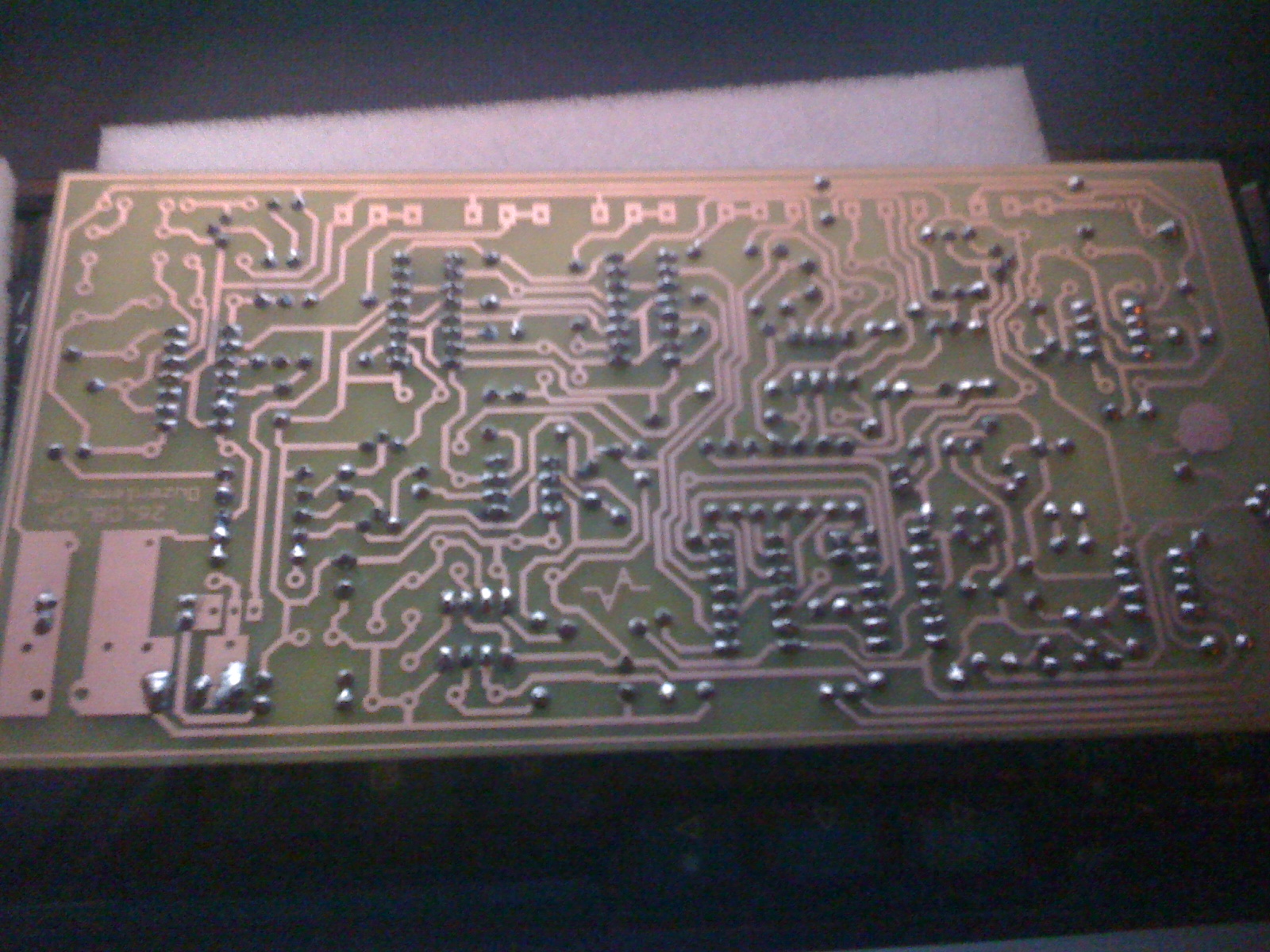

                    • I built delta pulse, with my own designed schematic and PCB. its PCB was designed with a lot of attention to noise and quality. it is two layer metalized board with ground shielding. I used high quality components because I hoped I can get even better results with this method.
                      Result : it doesn't work!.
                      when you power the circuit ON, the speaker makes noise and a VU_meter acts and goes to end. it works like you have a metal near the coil, but without metal. no action when you change the potentiometers. I adjusted the frequency to 120Hz. I put a lot of time for this circuit. Unfortunately, I'm little disappointing now. it consumes the current between 90-100mA.
                      its photo is here. although it doesn't have a good quality, but you can consider all over the circuit.
                      if the Delta Pulse has a correct designing, its PCB should have some differences with the schematic which is posted here. because I designed the new PCB exactly based on the last provided schematic in this forum.
