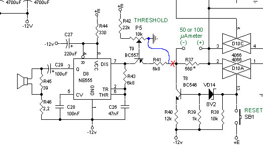

  • When I turn it on, the red led turns on, the coil sends out pulses (When placing some metal inside the coil, the object starts to emit a sound)
    norm
    and the irf720 gets a little bit warm,
    norm
    but I get no sound or current at the Ameter. I tried all pots and the tuning button, but nothing worked.
    When I touch Pin2 at the D9A 4066 with my finger (tried it accidentally) the speaker starts huming and when i touch Pin11 of the same or push tune, it stops again.
    you use a strange way in my opinion. it is not an radio... but if this is working for you...
    My coil is around 1,4mH and 4Ohm and I'm running it at 120Hz.
    unnorm. DP can work with the coil, but norm is 350-500 uH. (MICRO-)
    disconnect NE555 sound part according to attached schematic and try to get the ruffle sound via P5 pot - from nothing to rare clicks and further hight tone.
    • Did it, same as before, no sound at turning on or adjusting pot P5 and now no sound when touching Pin2.
      This means there is something wrong in the 555 part, right?
      Shouldnt the sound start by itself, without touching with fingers? :S

        no sound when touching Pin2 because you disabled the sound part from all. something wrong in the NE555, you are right. check pot P5 itself.

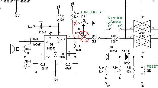

        • desolder T9 off, connect accordingly a schematic here. you must get A CLEAR tone. THAT IS SIMPLE CLASSIC GENERATOR ON 555.
          let Qia or whom yet with perfect English to tell you how the generator works!
          • did it, now 555 creates simple sound like a monostable multivibrator.

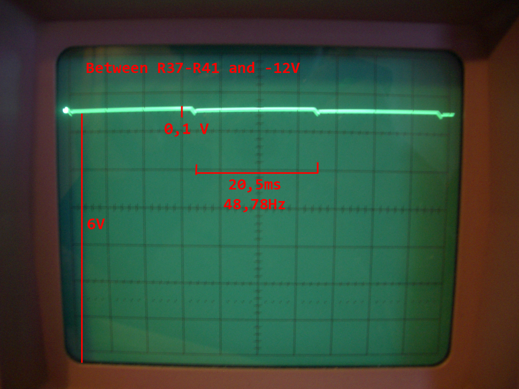

            I also checked the coil with my scope, between the two ends.
            Is it even detecting? The difference seems too small to me.

                stay o-scope probe in R37-R41 point. you must see some slightly negative noised level. if you bring a metal over the coil coil you must see INCREASE voltage level in the point. it is normal working state of DP.
                tried that advise, I get NO change, when I move something near the coil, I just get the following signal.
                I guess its just the gap when smoothing voltage with capacitors, right?
