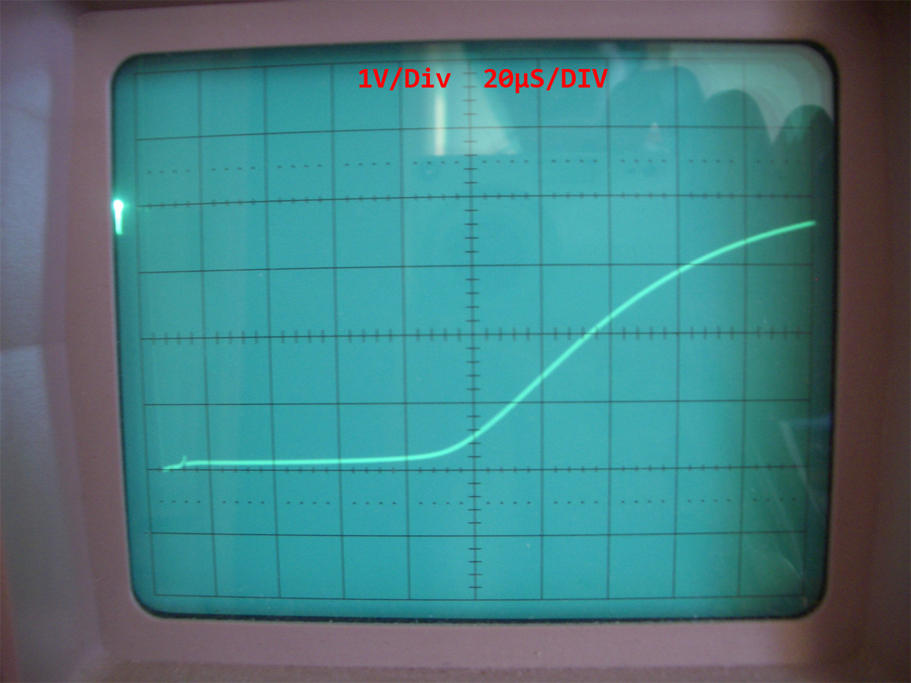

    This pic shows the output of LF357 at pin 6. I searched all across the board, but couldnt find an explanation of this signal. As far as I know, this shows the signal the coil recieves after turning off, right? The first ramp is the decay of the field, about 2µS after turn off it is at the minimum and then the circuit waits about 80µS till it takes a sample of the signal? I already changed the main frequency to about 900Hz and the delay time to be adjustable from 1,5µS to 65µS and the delay width to 1µS to 10µS, but I still get this long time before the ramp goes up again and i can take a sample. Is this long time in conjunction with the decay-speed and thereby the quality of the coil or is it set somewhere in the circuit. As I read on the internet, I need to take a sample after about 15µS to anything golden.
    Btw, is it possible to take the sample on the "ramp" or before the "ramp" or just "ontop" of the ramp?
    Sorry if my questions sound stupid, but I couldnt find relevant information on the net or on the board explaining this signal.
    I use a 2,3Ohm 469µH 24cm coil.

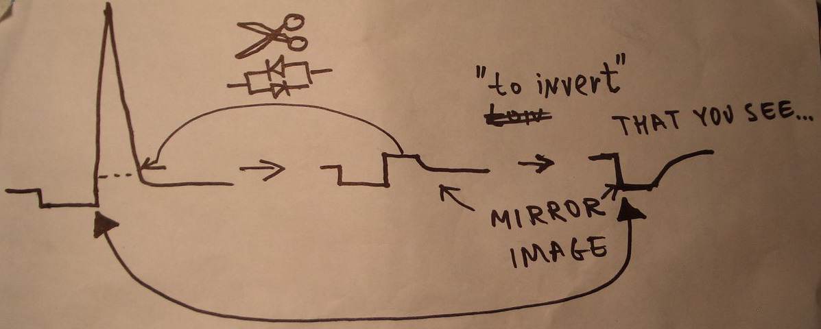

    • stupid. really. open Carl's Moreland's HAMMERHEAD article and you will see where you do. look last #15 page. FIG 24 and 25.

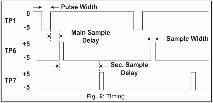

        i have already printed the whole article out and readed it twice before asking this question. Its just not clear when the sampling takes place, is it in FIG 26 15µS after the start of the ramp or is it 15µS after the end of the pulse? Its hard to tell, because there is no timescale.

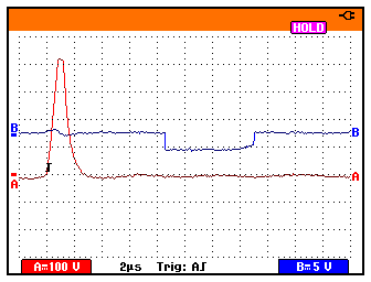

        • hmmm... for Delta... with comparatively huge MAIN SAMPLING DELAY... that you ask is not so principally... if you do Hammerhead... with only 10 (minimum) us... and you want particularly repeat Eric Foster legendary 5us MAIN DELAY... it is really worth-while.
          • I took the timing pix from the article of Carl...
              • Ohhh...now i see... The flyback signal is just cut. Then my coil seems to be pretty aweful if he has such a long flyback signal and I should decrease the pulse width. Thank you very much kt315, now I finally understand what this means
                What should I try to decrease the time, till the flyback drops beyond 0.7V ?
                • Found the problem, the coax cable was a piece of crap and tripple the decay time >.<, now with simple wire I find a gold ring 22mm at 25cm and at 20 with fast movement
