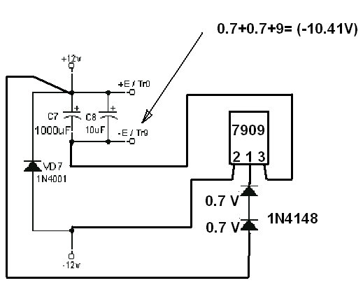

          • Hi jose, kt315 and ousama , many thanks for help
              I am experimenting with this circuit to slightly increase the tension of 7909.
              nice work kt315

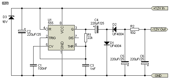

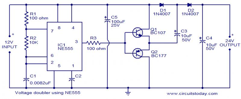

              i was think that the voltage between E+ and E- should be so stable and requlated
              and i was think to make circuit that provide -10.6 by 555 TIMER AND voltgae multipler
              and requlator
              so if battery fall from 12.5 to even 11.6 volts this -10.6 still stable
              because 555 timer can be used give -20 volts from 12 volts and then we regulated -20 to -10.6
              i copy this idea from pulse star power supply circuit
              pulse star use requlated power
              i will post schematic soon
              i have question
              my question to any one have scope to see if there is noise from LM556 in the e+ and e-
              and ground?
