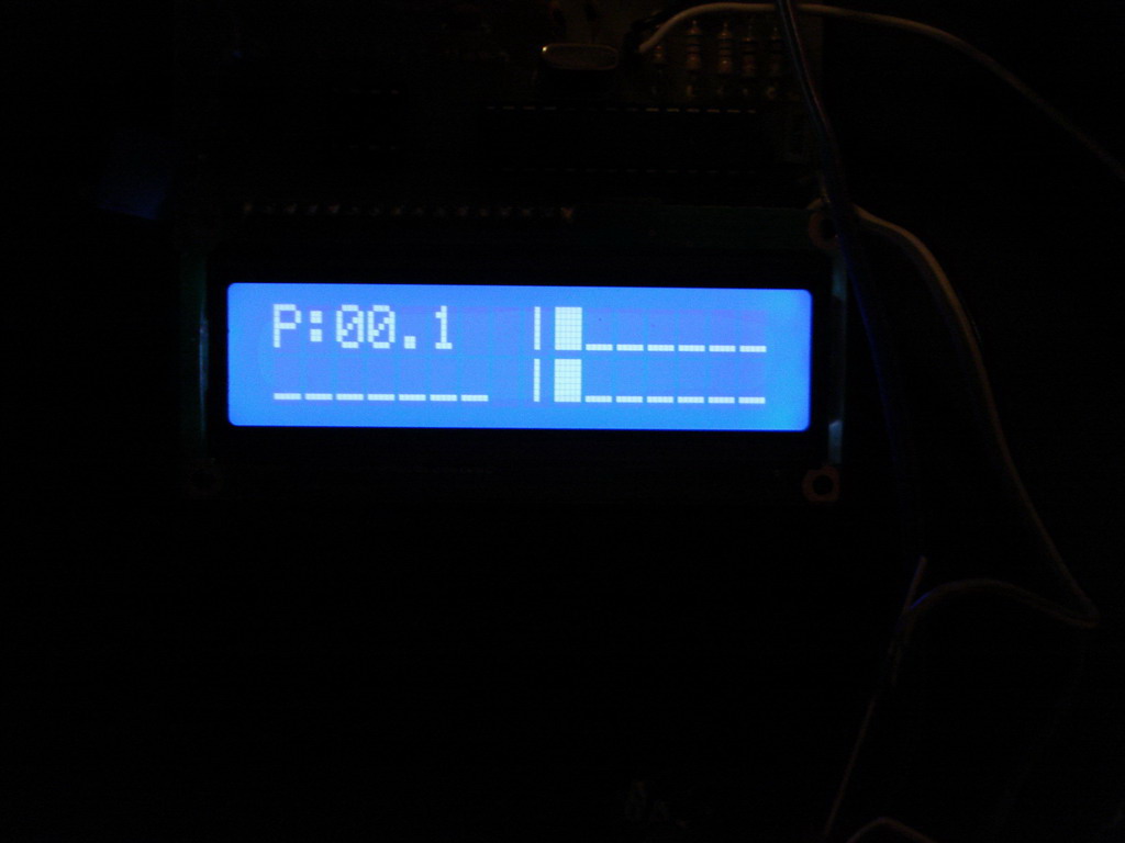

    • I did not use PIC16F676,however the code works fine,displays battery voltage and signal strength.
      • Originally posted by Saromines Ramiel View Post

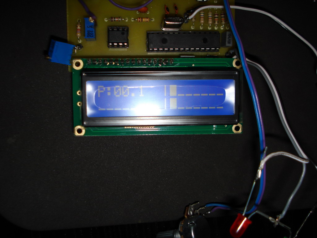

        Hi! Nicolas did you solved the problem of your LCD discrimination? what programmer you,re using? I have the same problem,.
        Hi Saromines Ramiel
        Yes I Have resolved that... I use programmer type PICkit 2 v2.61
        But not again stable with frame 1x1m. it's ok with coil 40cm
        A remark to not: put potentiometer to determine the value of RX. So that the program is displayed on the screen.
        Best time

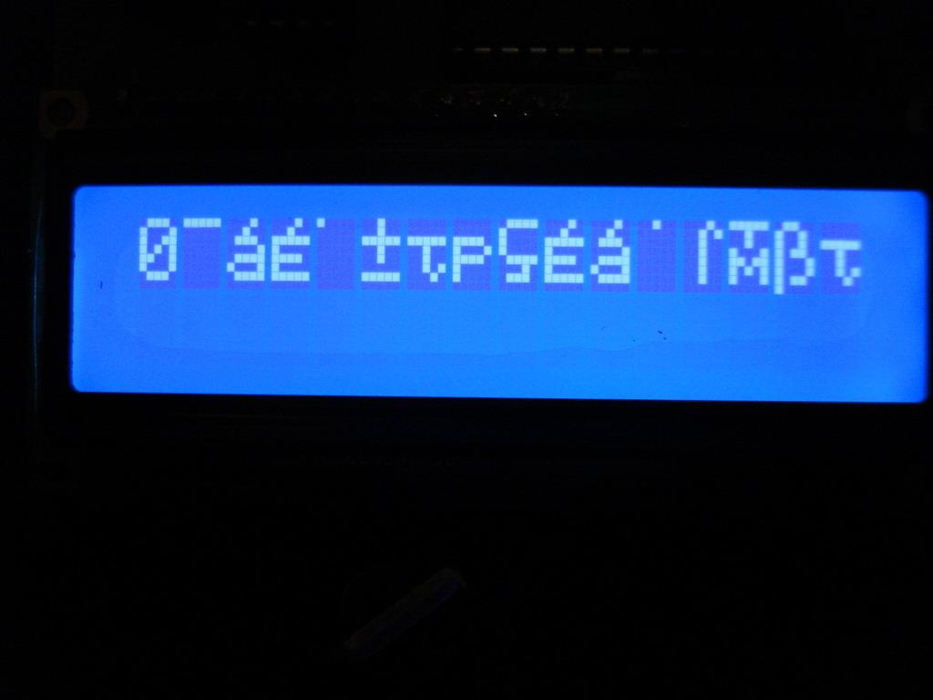

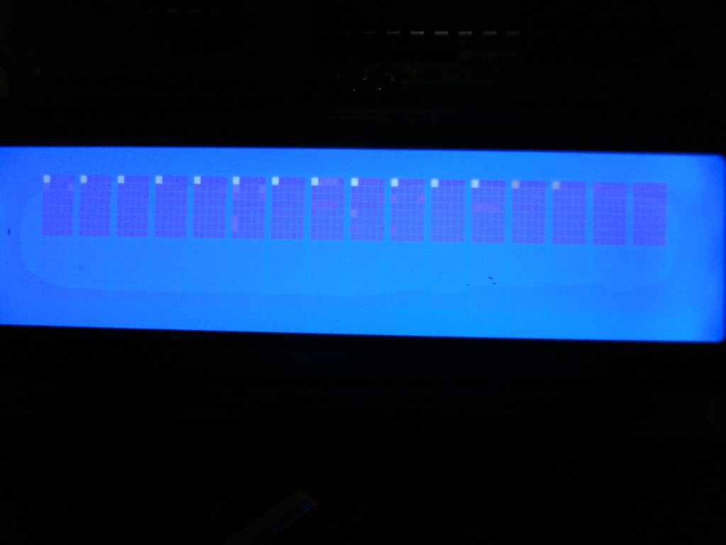

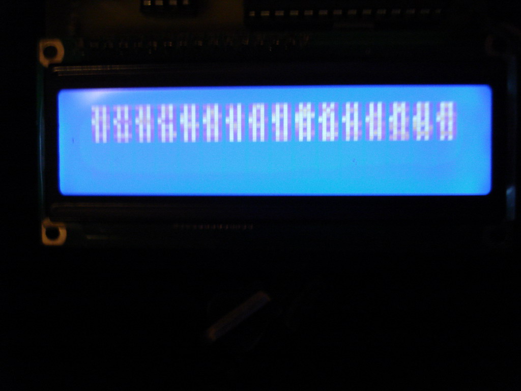

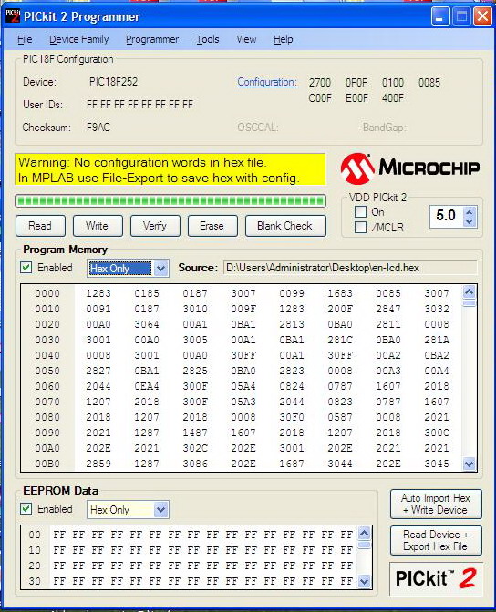

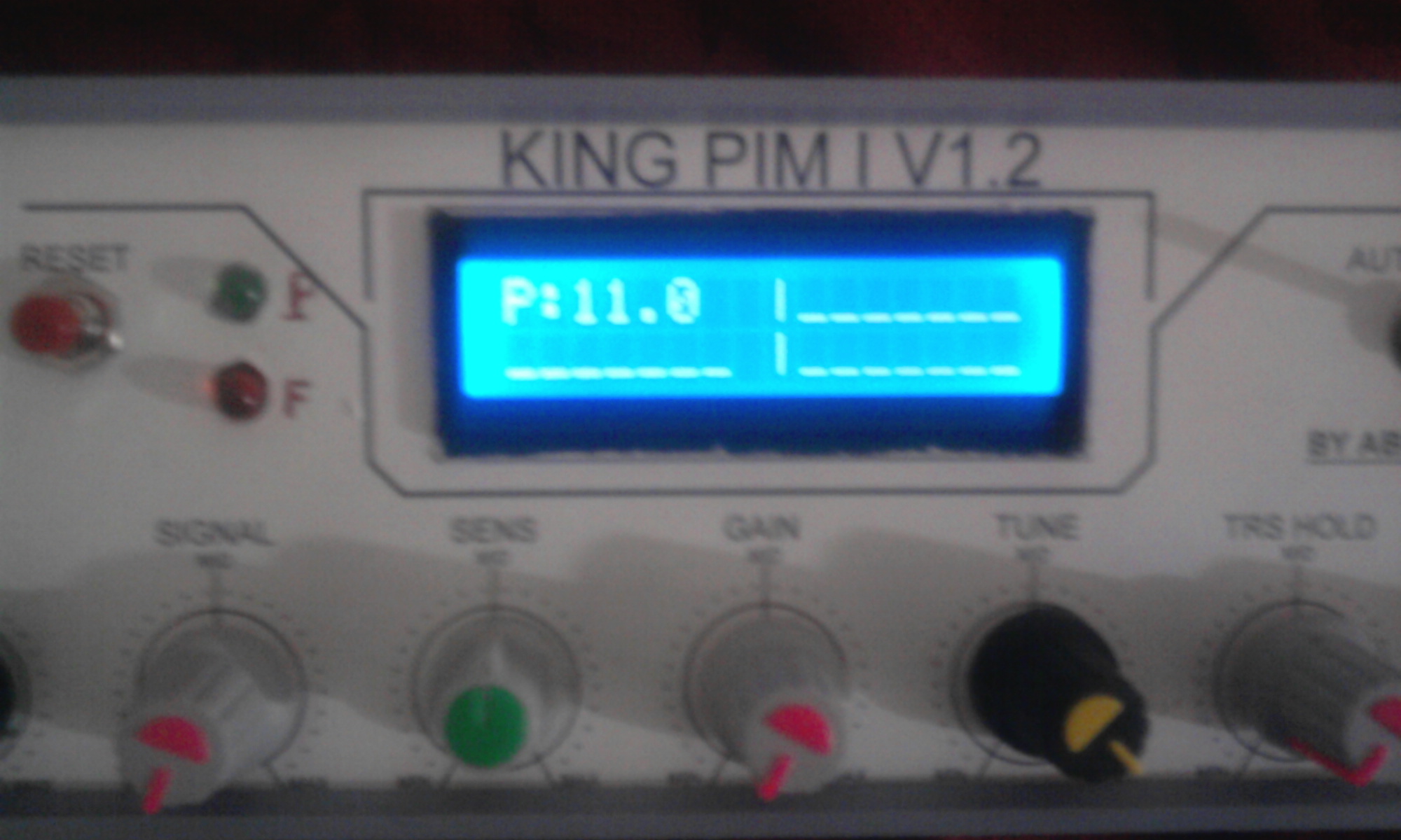

                • Hello folks, i have made lcd display for delta pulse with pic 18f252, but there is a problem! I think that hex files are not good!
                  I am using files posted by JAP.
                  First when I put hex into my pickit2 programmer i got this warning as you can see on the photo.
                  Second,at first I tried to use en-lcd.hex but i got just a blank screen, so i tried with disc.hex ( turkish version) and I got this what you can see on next photos.
                  I have reviewed pcb few times in detail, and everything seems ok.
                  Does anybody have the same problem and how can I resolve it?

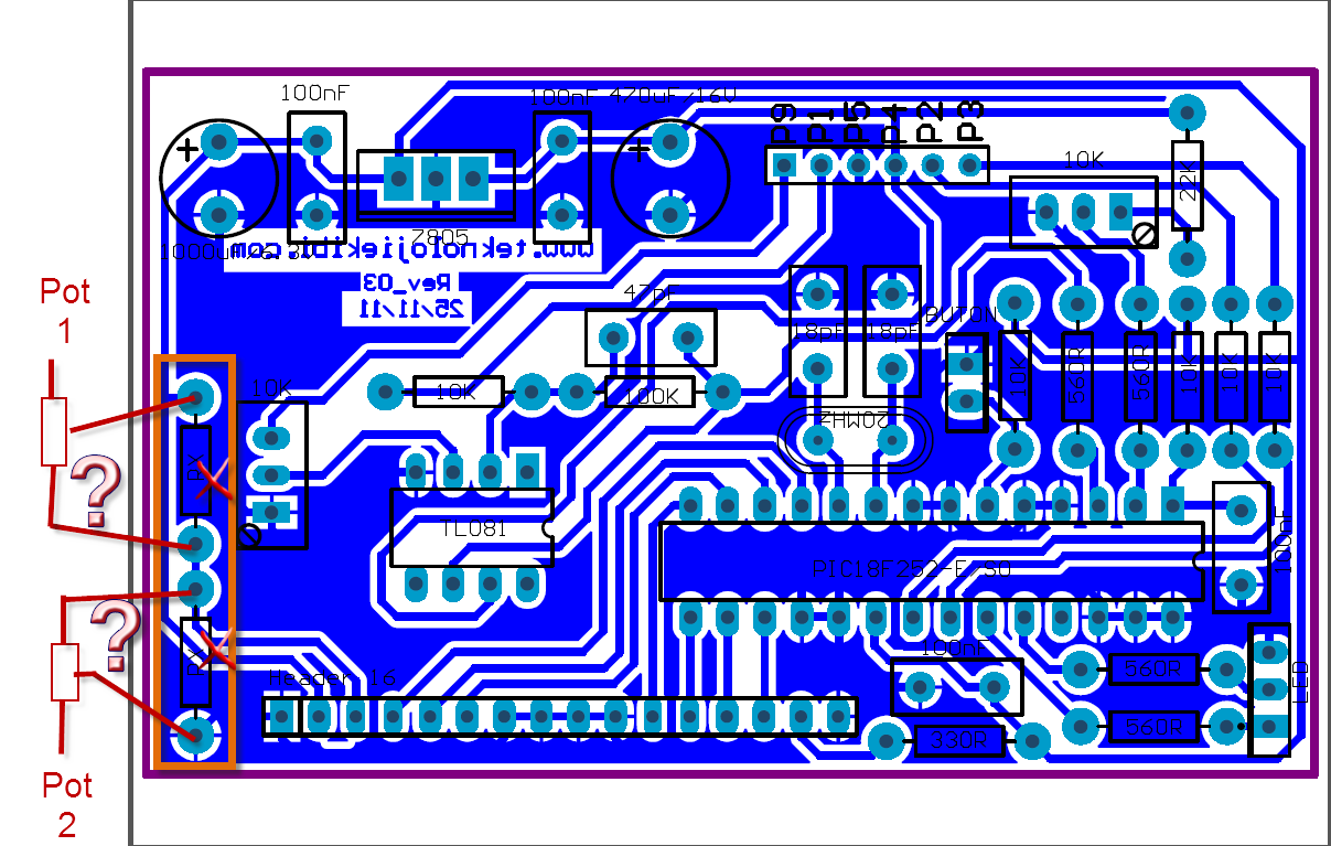

                    HELLO FRIEND
                    YES I HAVE THIS PROBLEM AND I HAVE RESOLVED IT
                    THE PROBLEM IS THE VALUE THE RX
                    PUT TWO POT IN PLACE THE RX
                    RX1 = 4K7 .. RX2 = 600 Ohm
                    FOR THE PROGRAMMER IS GOOD NOT WORRIED IS GOOD
                    THE HEX FILE BY FRIED JAP AND TURKUSH IS GOOD ALSO
                    -----Note-----What you see in yellow on the program does not matter
                    You can ignore this message ... the file
                    s is downloaded as no Error message Error.
                    THIS IS MY RESULT
                    I WISH YOU GOOD TIME.
                    NICOLAS
                    • Nicola
                      I do not understand that you mean circuit resistance, when you say "RX"?.
                      Is the damping resistance? any component or module of discrimination?.
                      thanks
                      Jose
                        Nicola
                        thanks
                        Jose
                        Hi Jose
                        But we speak about LCD and module descrimination my friend
                        • Thanks for responding Nicolas.
                          This module is a demo, how many times you can use the discriminator module?
                          • Thank you Nicolas, but I don't have problem with contrast. Today after dozen times of turning on and off my lcd finally gave signs of life.
                            Only turkish version of hex works and not always, often i got the same hieroglyphic signs as on photo above and sometimes is normal.
                            I don't know what is the reason for that?
                            Bad microprocessor maybe, or?
                              200 times, after that you must reprogram the chip
