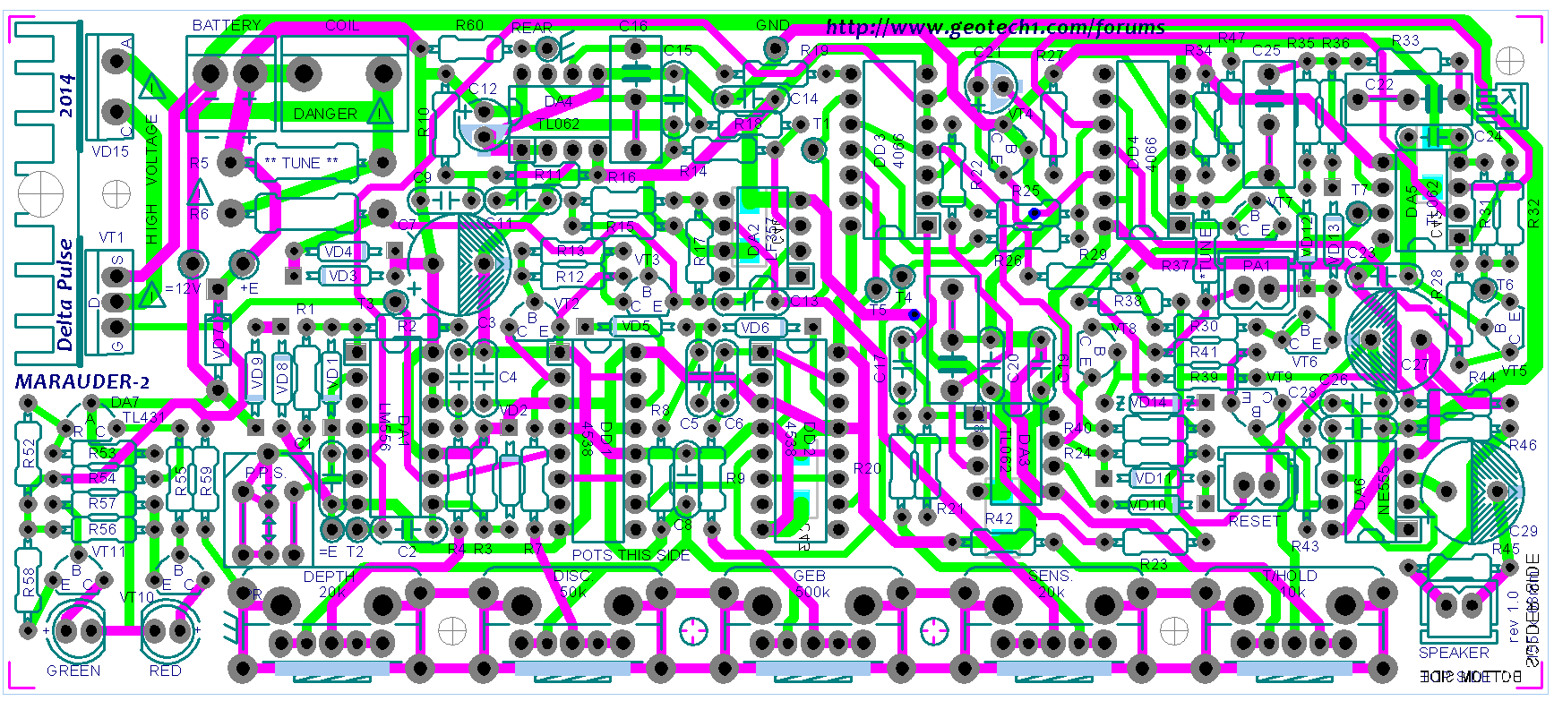

  • mohandes the pcb YOUR sucks. WE DO NOT say this from bad course, As far as I can discern found something Look image for...

    • sorry but why your DP in THIS state would be working? this is something from kinda garbage... so it seems... throw out this board.

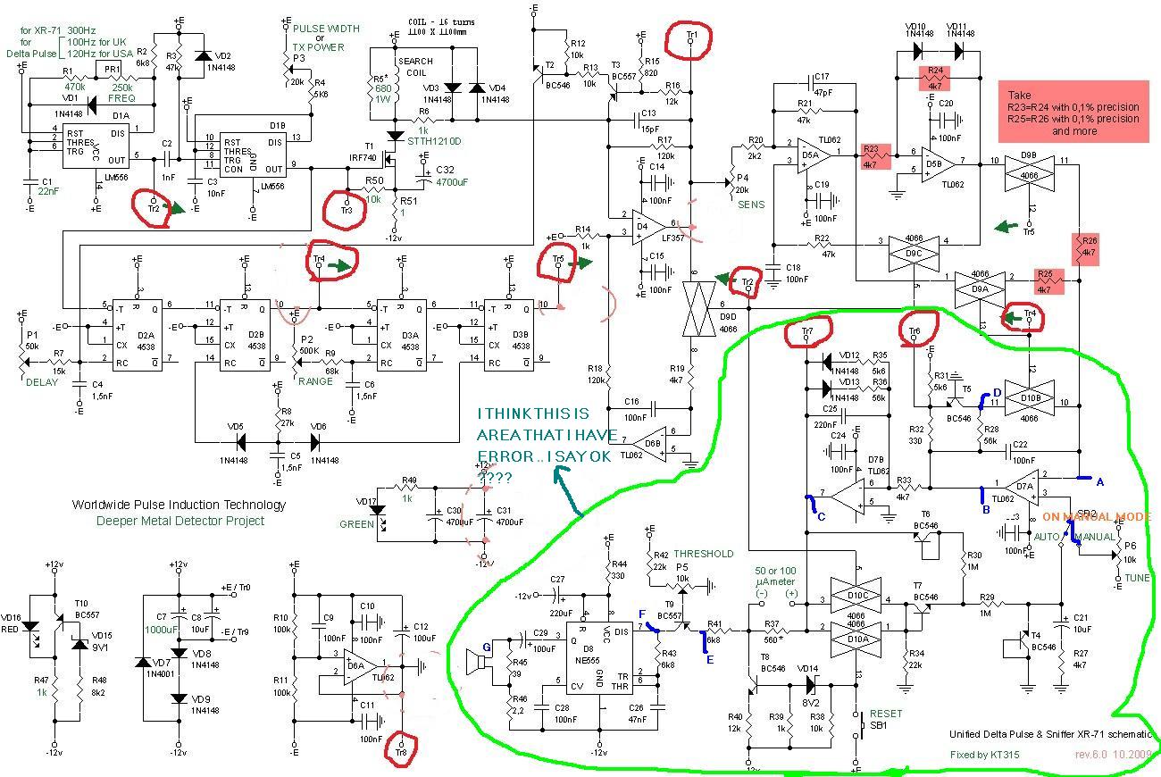

        but all GROOVE ( copper ways) , oh i do this by soldering and check and connect.it is Dirty but ok .
        i have 1.2k hertz in speaker but speaker not work ??why
        for increase freq i have to change R43 and C26,which one reduce and which one Increase

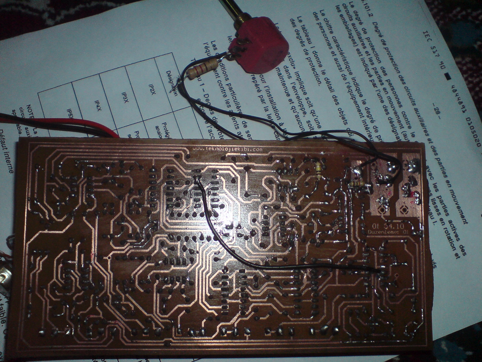

        look kt and g.s (before soldering )

        • Do not think I need to change anything in the audio frequency 555.
          Check with oscilloscope if you have pulse audio pin 3 of the 555, if so check the continuity of the cables and speaker.

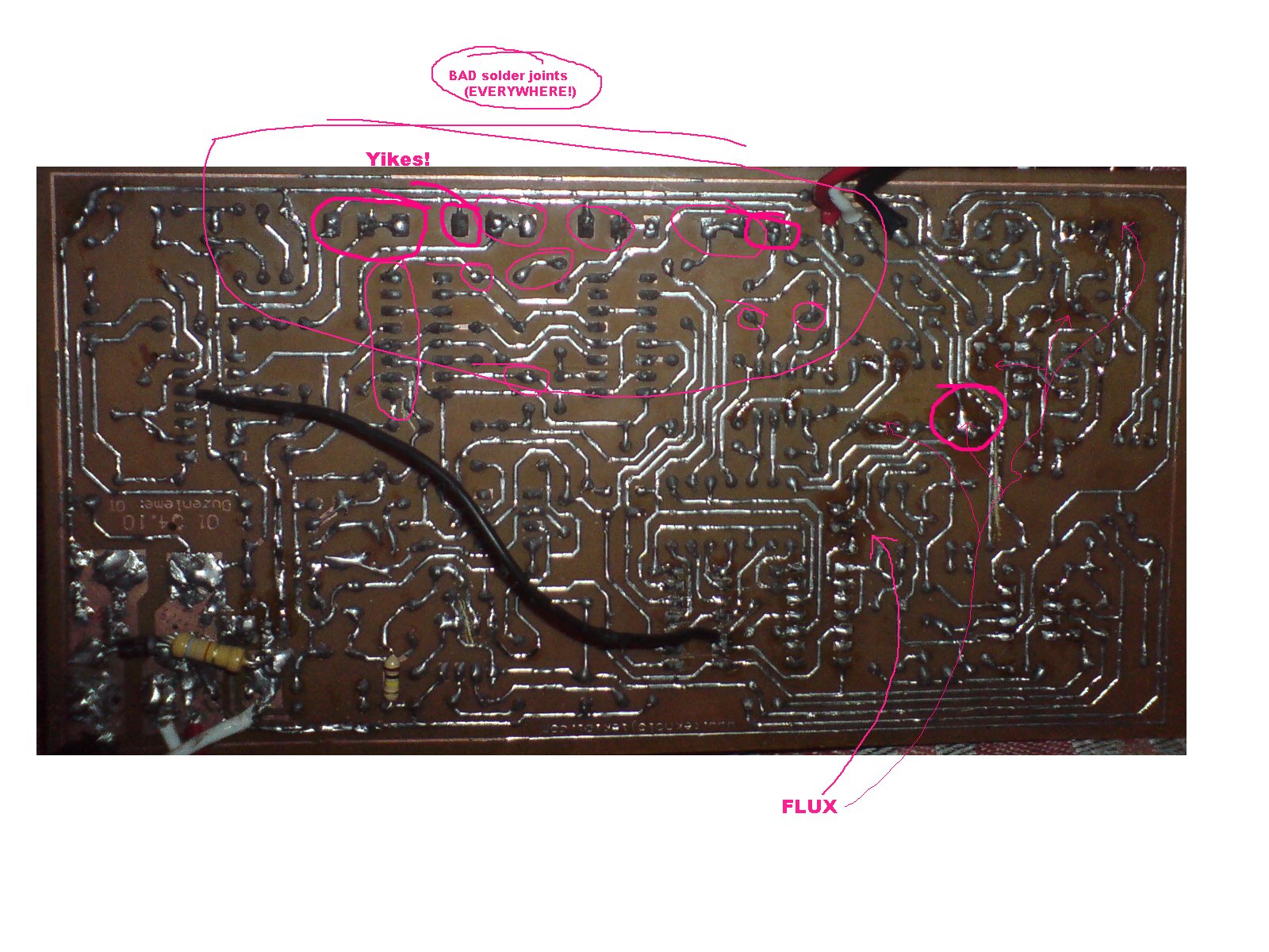

              • Mohandes, here are two things I notice about the back of your board.
                1. Too much solder on the joints. LESS is better. Do not leave globs, or blobs of solder when you make a solder joint. You can have a bad solder joint and just because it has gobs of solder, that does not make it good. Make it look nice. It works better that way.
                2. PCB needs to be cleaned with alcohol or water, or whatever it takes to get the solder flux off your PCB. What you use to clean flux depends on the type of flux. Even "No Clean Flux" should probably be removed. Rosin flux absolutely needs to be removed 100%. Ditto water soluble flux (get it off)!
                Do not let flux sit on your PCB for more than a couple of hours before you clean, it will be very difficult to get it off if you do that.
                Unless you are absolutely sure that the flux you use does not adversely affect the operation of the circuit it is used on, then CLEAN IT OFF.

                  but if you see my out put you can see all out put NEARly ok , and before i soldering the copper lines i have not value or frequency in speaker .
                  when i remove coil i test D7 by Tune pot but i have not change in pin1 ,6 ,7 ,so i have a problem them.so what do you think ??

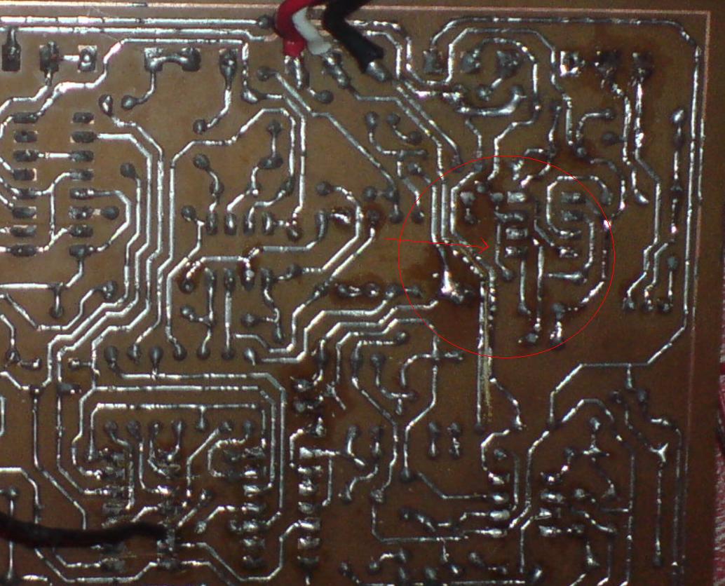

                  i clean board (GASOLENE ) and again check these points that you certain .
                  but real question i ask you above , SINCE when i am not soldering coppers line i have this problem , and i think my problem in 4066s or D7 or any thing related to D7.

                  • i clean board (GASOLENE )

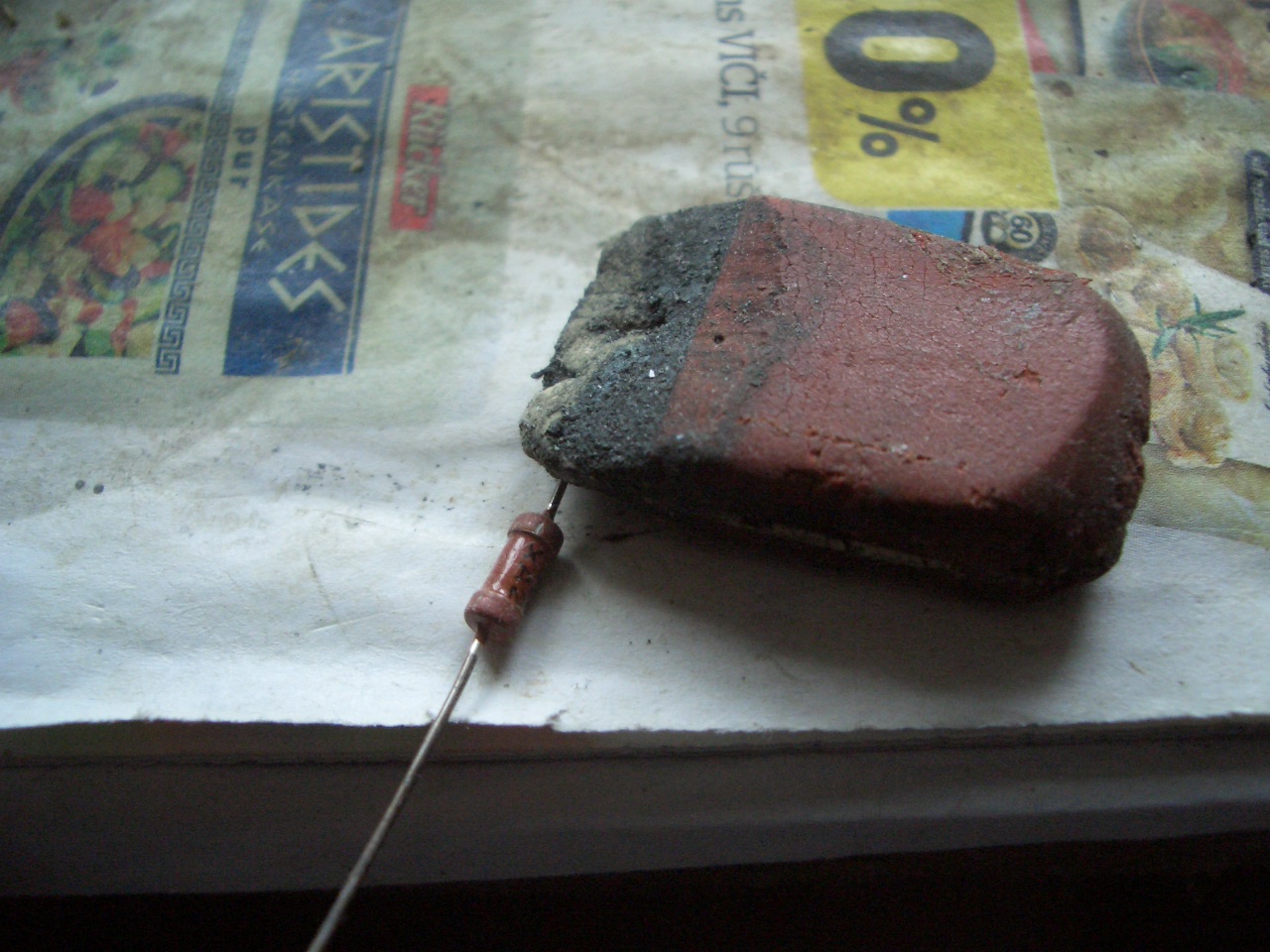

                    clean all pins of resistors caps transistors etc BY ERASER BEFORE THE TINNING!

                      it is yet not ready... do not do... I have to check the layout on mistakes... wait a time the board will be made and tested.
                        look this photo!

                        very incredible i do this , and i wait here to my friend to find my problems
                          You will use gasoline to clean PCB??
                          Alcohol is the preferred substance to use. Isopropyl alcohol, methyl alcohol or ethyl alcohol etc. ALCOHOL
                          I think gasoline will leave a residue.

                            • I think gasoline will leave a residue.
                              to clean by gasoline last time and to fire. burn it out. with a residue. i can not see calmly a trash (
                              • Some things are just plain wrong. Using gasoline to clean a PCB is one of them.
                                Ethyl Alcohol is best. And then if you have any left over, you can drink it mixed with your favorite beverage... enjoy it along with your favorite tobacco substitute.
