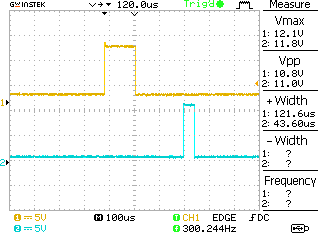

            i have pulse in TR2 TR3 TR4 TR5. 80US ,150US , 44.5US , 44.5US
            well , where is wrong , i measure speaker point and have 0volt and not frequency ?????!!!!!!!!

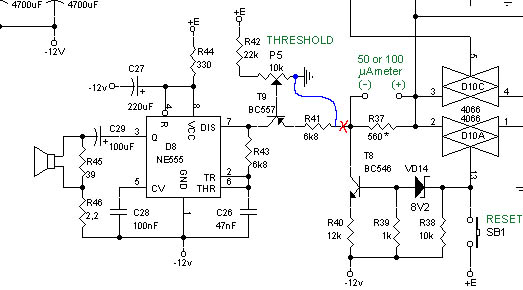

                  • try check the sound

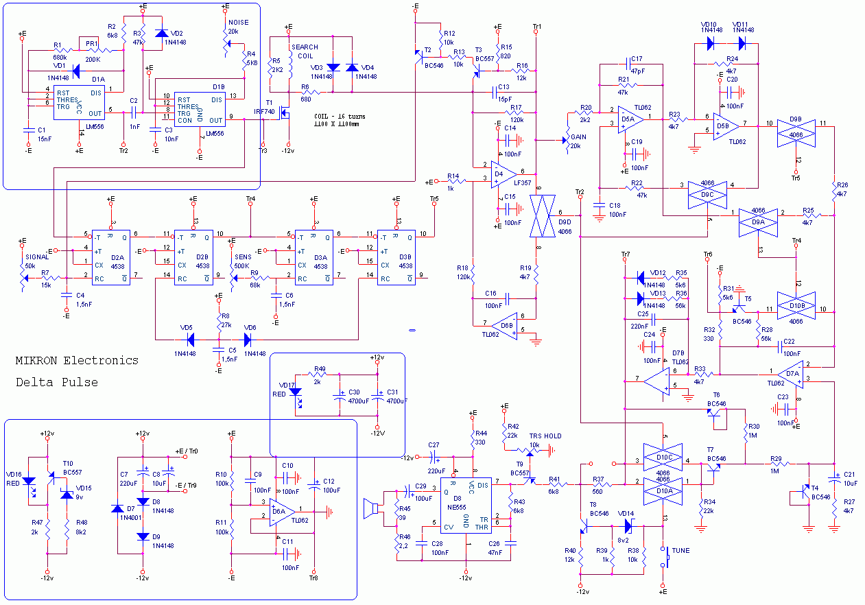

                      i DITINCT by blue OBLONG shape on this image
                      please remove all ics except 556 then if ok add another ics.

                        try check the sound
                        [ATTACH]27397[/ATTACH]
                        [ATTACH]27398[/ATTACH]

                        my problem this is :
                        i set in manual mode for voice then when pot the Tune pot in D7-3 have VARIATION for voltage so i measure D7-1 and again return in max and min SITUATION Tune but for all mode i have 10.9volts (and another pins )so i think maybe problem in these PLACE:
                        1-D7-2 , i should check 4066s but i give true waves ,or maybe i am mistake ????
                        please guide me

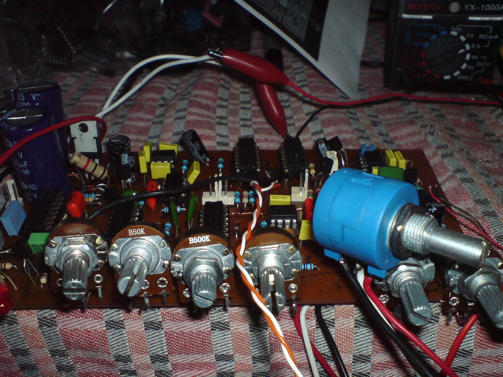

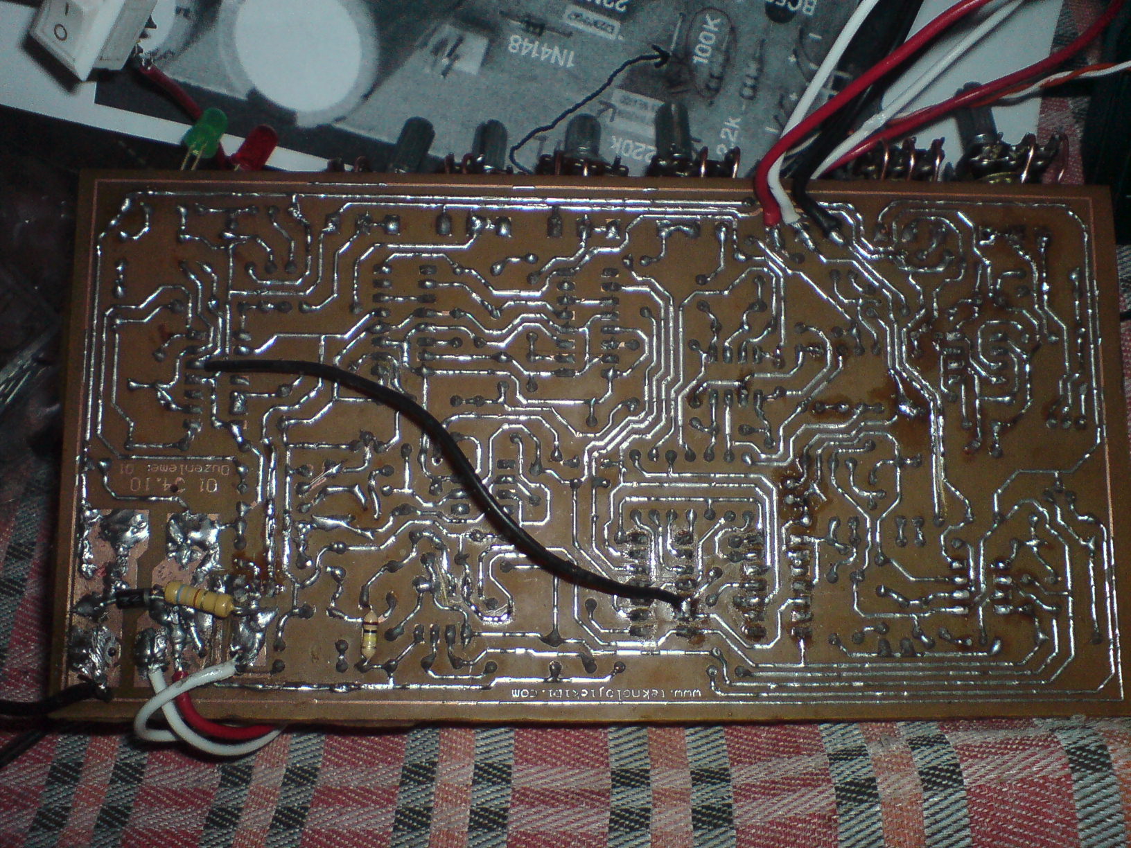

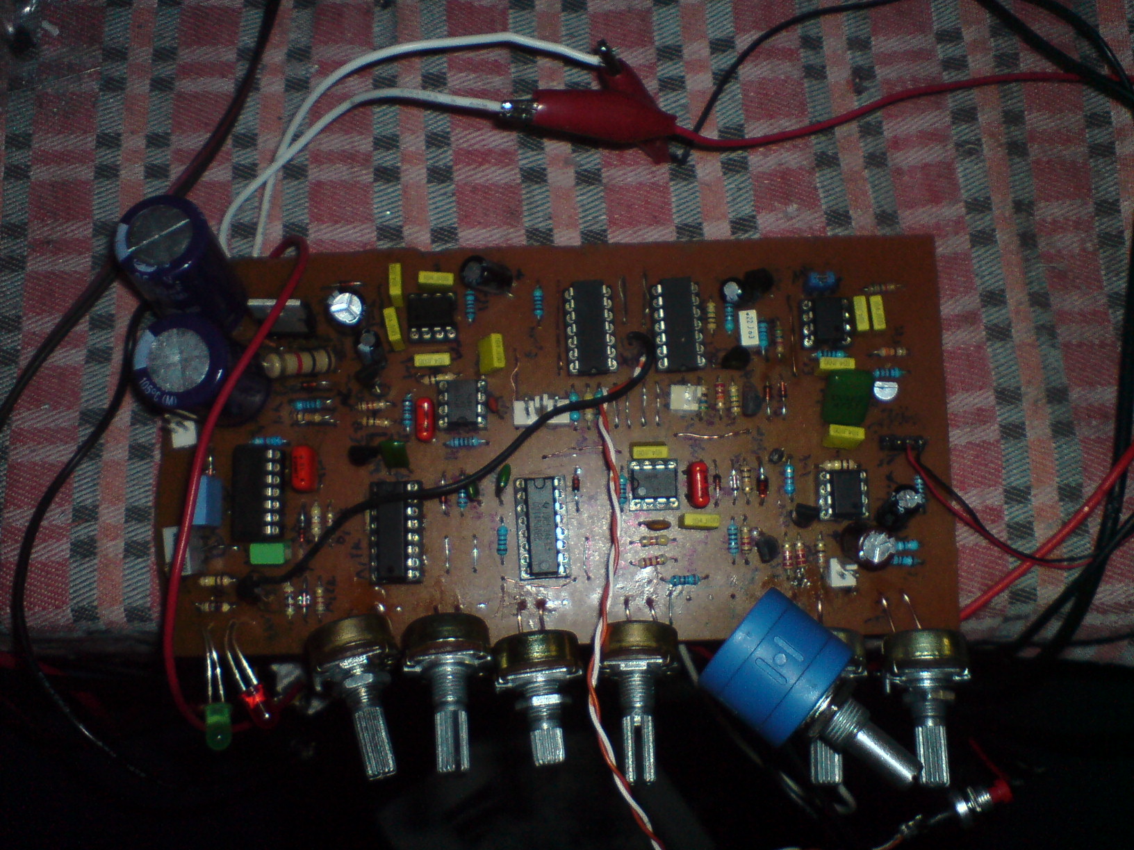

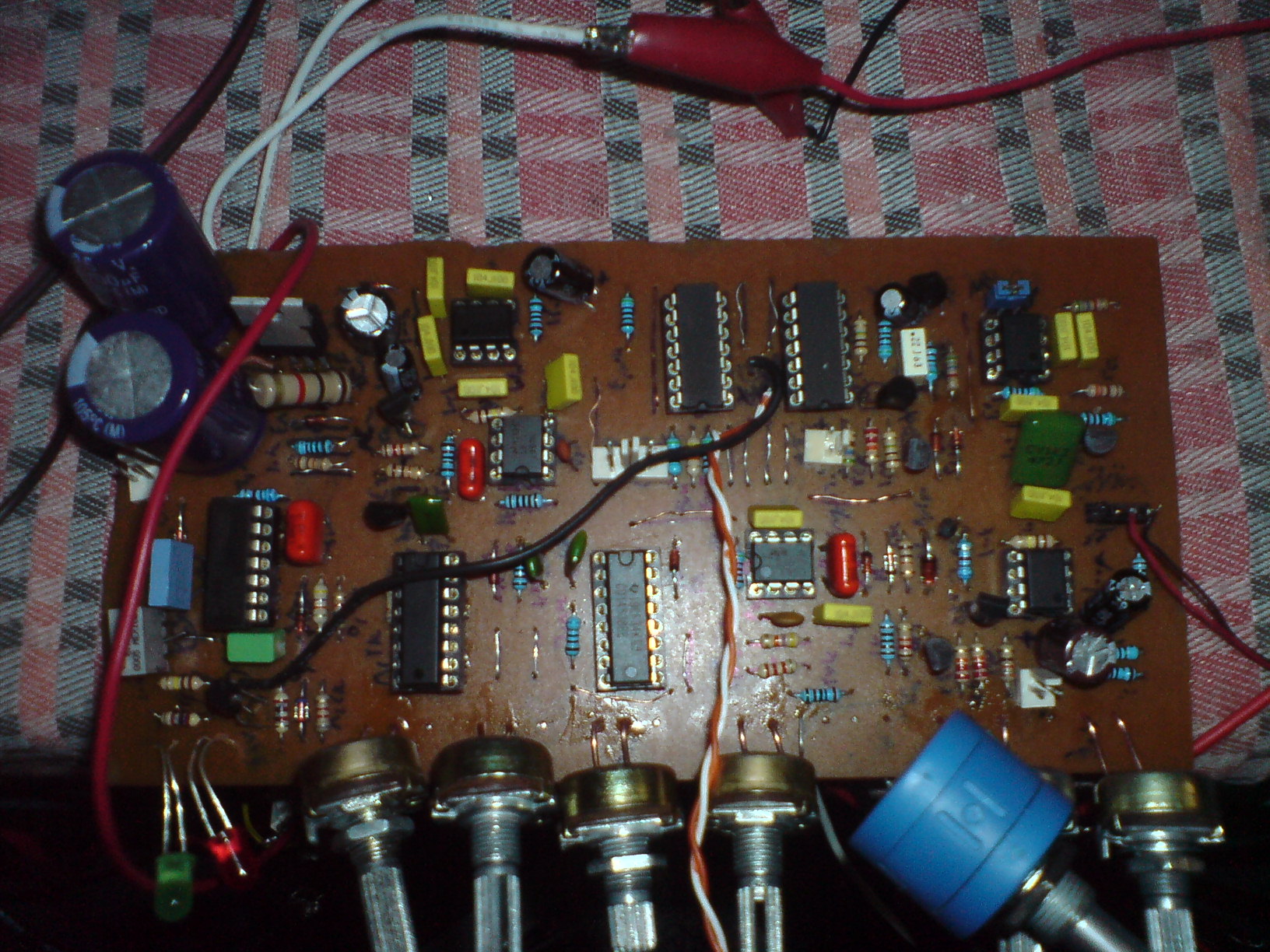

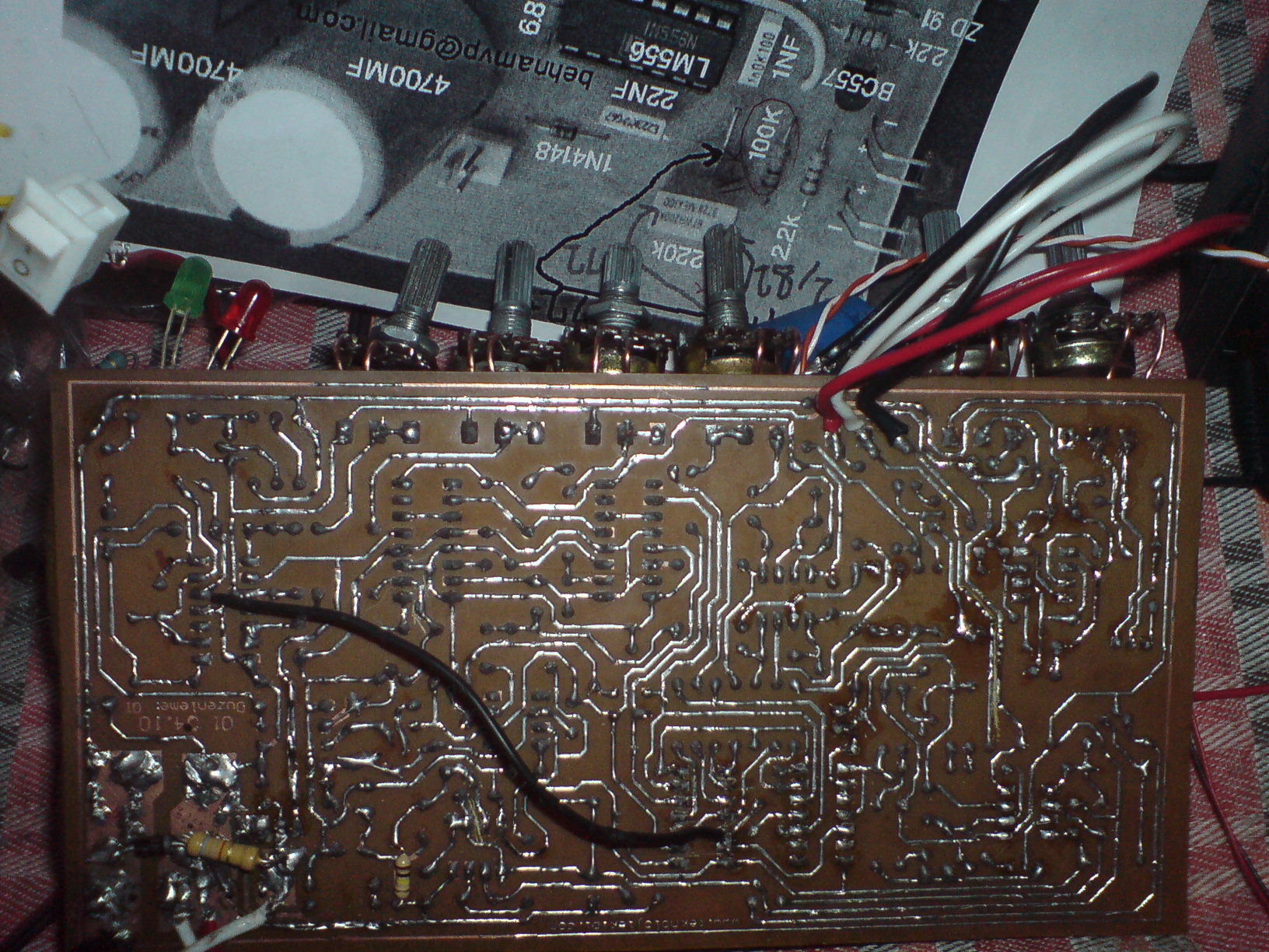

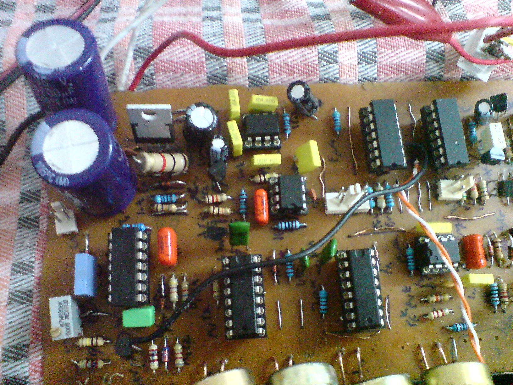

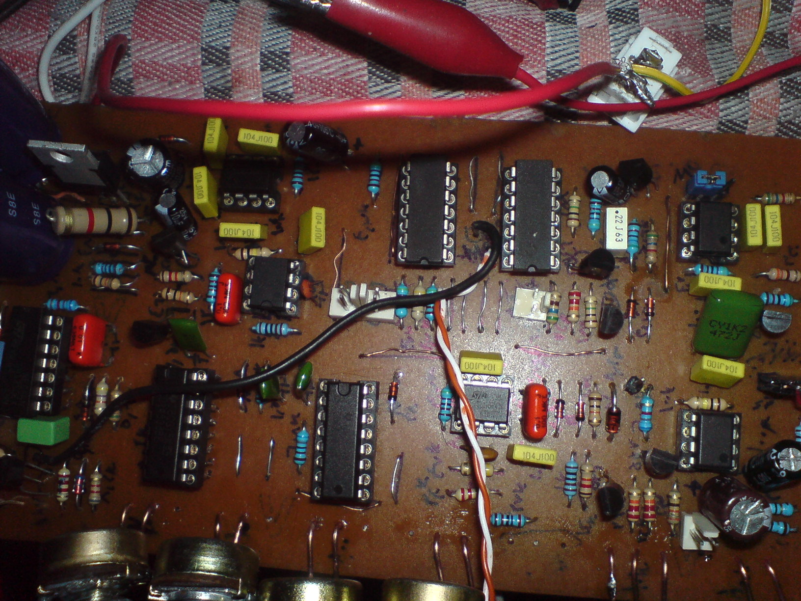

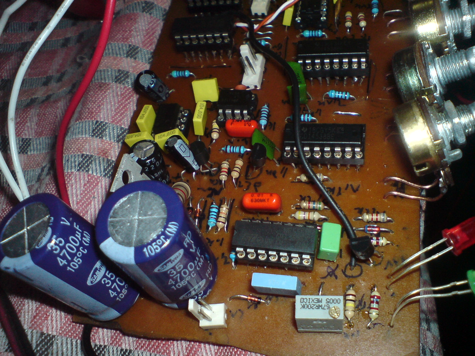

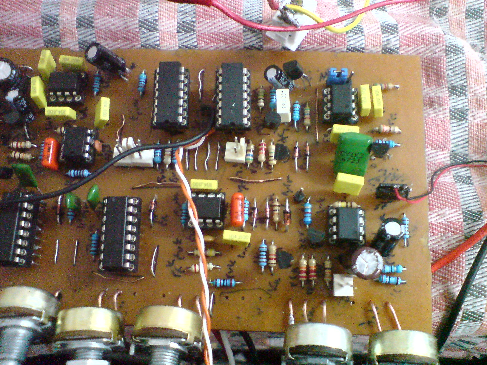

                        • hi i upload my pics.
                          please help

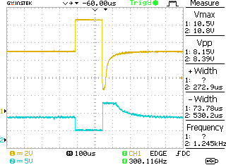

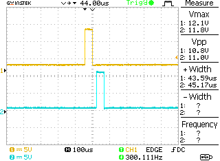

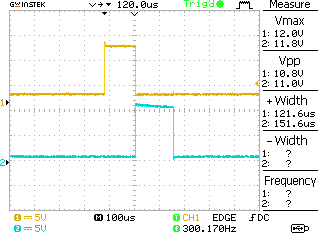

                            • first wave (yellow )for first write , for example ne556-5 yellow and another is blue for ne556-9
                              ne556-5 ,ne556-9

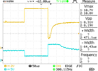

                              ne556-9 , 4538-10(TR4)
                              4538-10 with another 4538-10

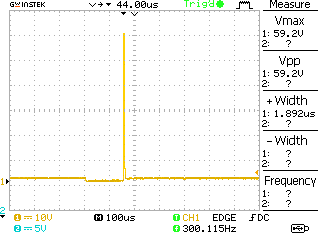

                              irf840
                              lf357-6 , tl062 -1
ID:	338562Click image for larger version
                              see the photos and guide me
                              dear g.s
                              i change it by another ne555 and lm555 and not work
