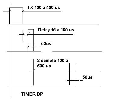

            I want to use the microcontroller instead of LM556 and 4538, please provide good suggestions, I would like to share
            If I could be scheduled for the DP, would do the following:
            Pulse TX adjustable, varying between 100 and 400 us. 100 to 500 Hz frequency varying
            First sample from 15 to 100 us, taken after the end of TX pulse with a pulse width of 50 us.
            Second sample taken after the end of the first above shows, varying from 100 to 500 us. with a pulse width of 50 us.
            JoseClick image for larger version

              • Thank you for your participation, I will focus on the DP program development, I have a question do not understand, the connector between T2 to 4538 what role in the development process is that this is not to cut some features do not, please provide a good proposal

                      • Originally posted by liudengyuan View Post
                        T2 is preset signal to nulling all LOAD-KEEP CIRCUITS. ie DA4-B, DA3-A and SAT. no need in balancing of preamp like you see in Surf PI, Hammerhead. all balancing
                        AUTOMATICALLY and dinamically makes on work circle period timing start.
                          T2 connected to 4538.
                          When the coil is on a large metal, T2 together with 4538, the delay time changes, by increasing it, in order to avoid overloading.
                          I have disconnected the manifold T2 in my DP, (open collector) that allows a smoother delay control.
                          In my personal opinion, I would not mind that this T2 detached from 4538, I find no difference in my DP, on the contrary there is more adjustment range for the delay.
                          Jose
                            Please explain the function and role of this part of the circuit, if you can do it
                            this part protects TX part from overloading. it moves PRIMARY and SECONDARY STROBE DELAY, the strobes itself, in range of more less level on 'delta' pulse timing at right side. this part turns up and reacts on big amplitude TX signal only, big target near touched a coil. OVERLOADING TX PROTECTION.
