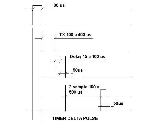

        For the particular case of Delta Pulse, another 80 shows us the beginning of the cycle timer job.
        This pulse is used according to my poor understanding, to reset the operational amplifiers.
        Ended 80 us pulse, the pulse begins TX.
        Apologies for the error.
        JoseClick image for larger version

                I do not understand the question.
                The minimum delay in the DP , is around 30 or 35 us . and adjusted with P1 50K and associated components , R7 and C4 .
                This is not good for non- ferrous metals, which require less time delay .
                However, you can change the time base to work with delays of up to 17 or 18 us , because the design of the front preamplifier stage , does not allow fast responses .
                The DP was not designed for small objects and fast driving,
                But 17 or 18 us , it's pretty good for coins, but not for the small gold.
                The advantage of DP is its high sensitivity , but is slow to respond, is fixed in part, by increasing the frequency of transmission TX .
                DP Another advantage is that it is less sensitive to ambient noise , unlike what is commonly said .
                Just compare the DP with other detectors in the same environment , where you can check which other detectors of similar sensitivity are more susceptible to noise.Click image for larger version
