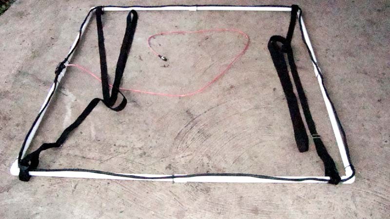

    • here is for M. a pic with coil from pvc. this pic is NOT MINE and not mine coil. only as an example.

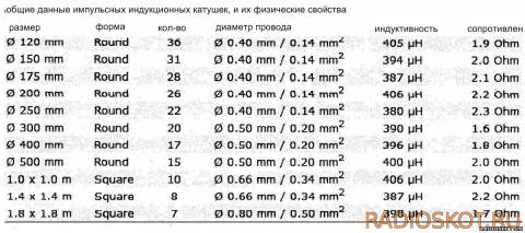

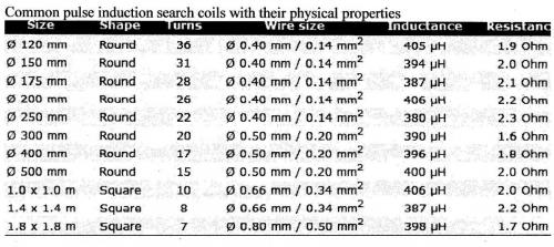

      • The parameter I need a one meter coil
        • the table had been uploaded probably 10s times.

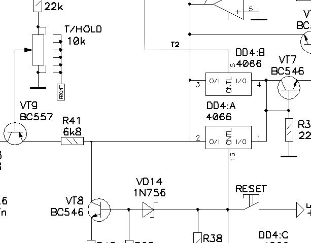

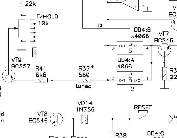

                    I got a question:
                    I won't be using uA meter, so should I bridge the +/- pins of PA1 and remove R37 (560R)? or should I keep R37 with the default value?

                    • briefly, you have to keep R37 with the schematic default value.
                      all the best
