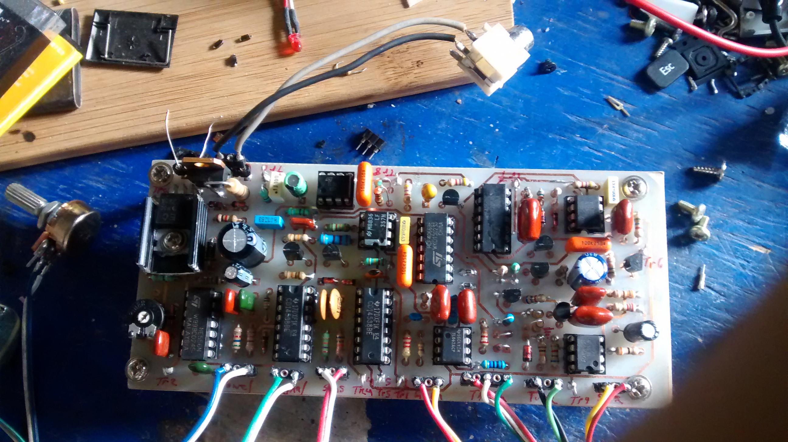

    i can thank you
    • Originally posted by seras05 View Post
      hi this is my DP I build 2 work ok the coil is 76x76 1.3 mH and 4.5 ohms
      i cant post images can you helpme
      your coil have more.400 to 550mkh and res 2 to 4 ohm.
      can you tell us about your detection?

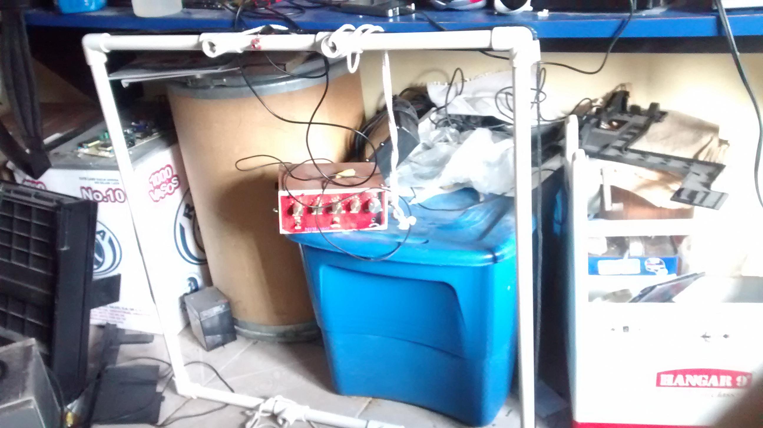

      • The device is working now. Basically i didn't have lf357 so i used Opa637 and ad845. Those 2 didn't work also had 1 burnt diode. Im testing the device with 22cm coil and depth is very good 60 cm beer can, 120 cm for 35cmx25cm tray. Ill be making large coil next perhaps 35-45cm.

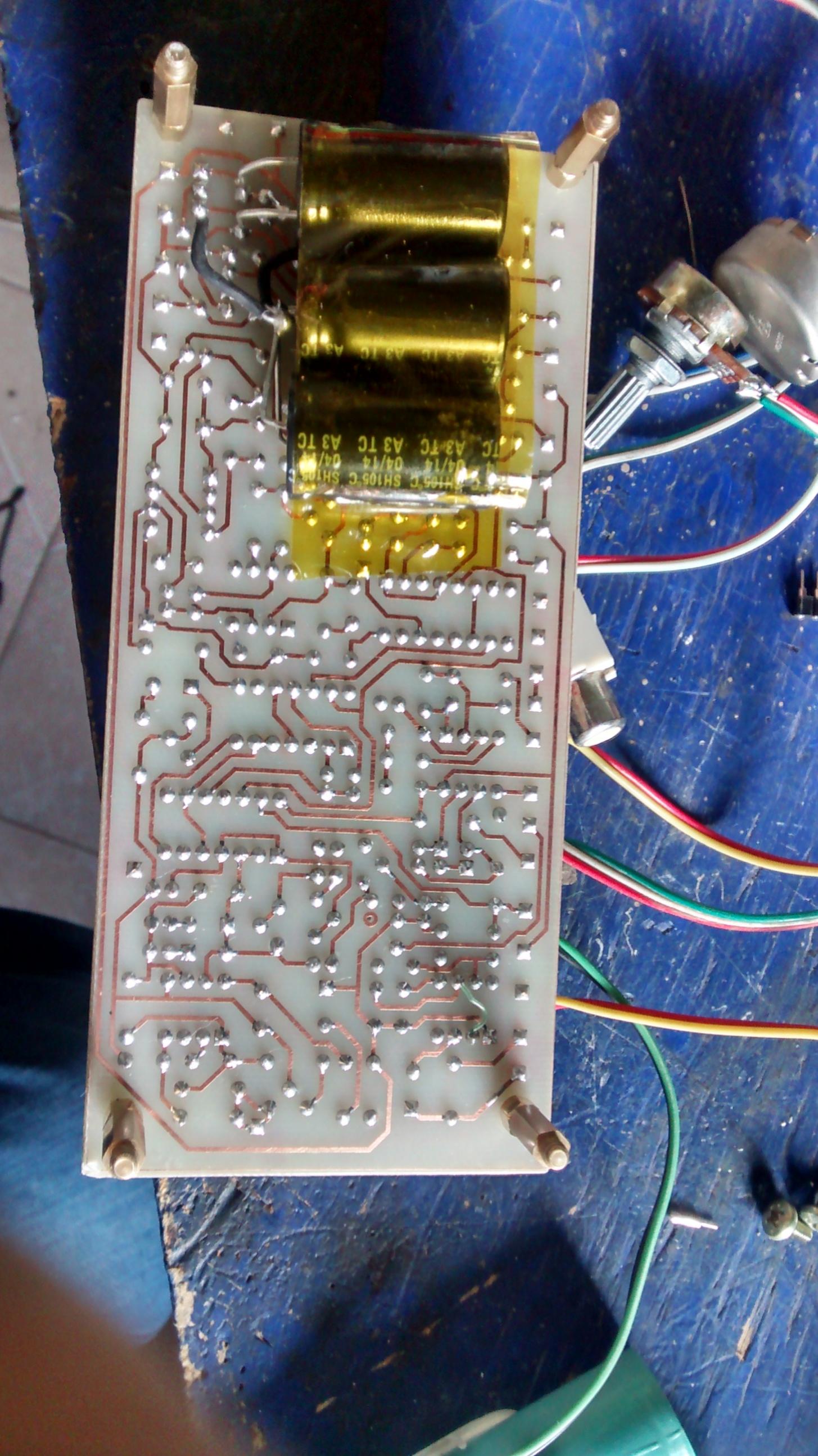

        • This is my dp2 work okClick image for larger version

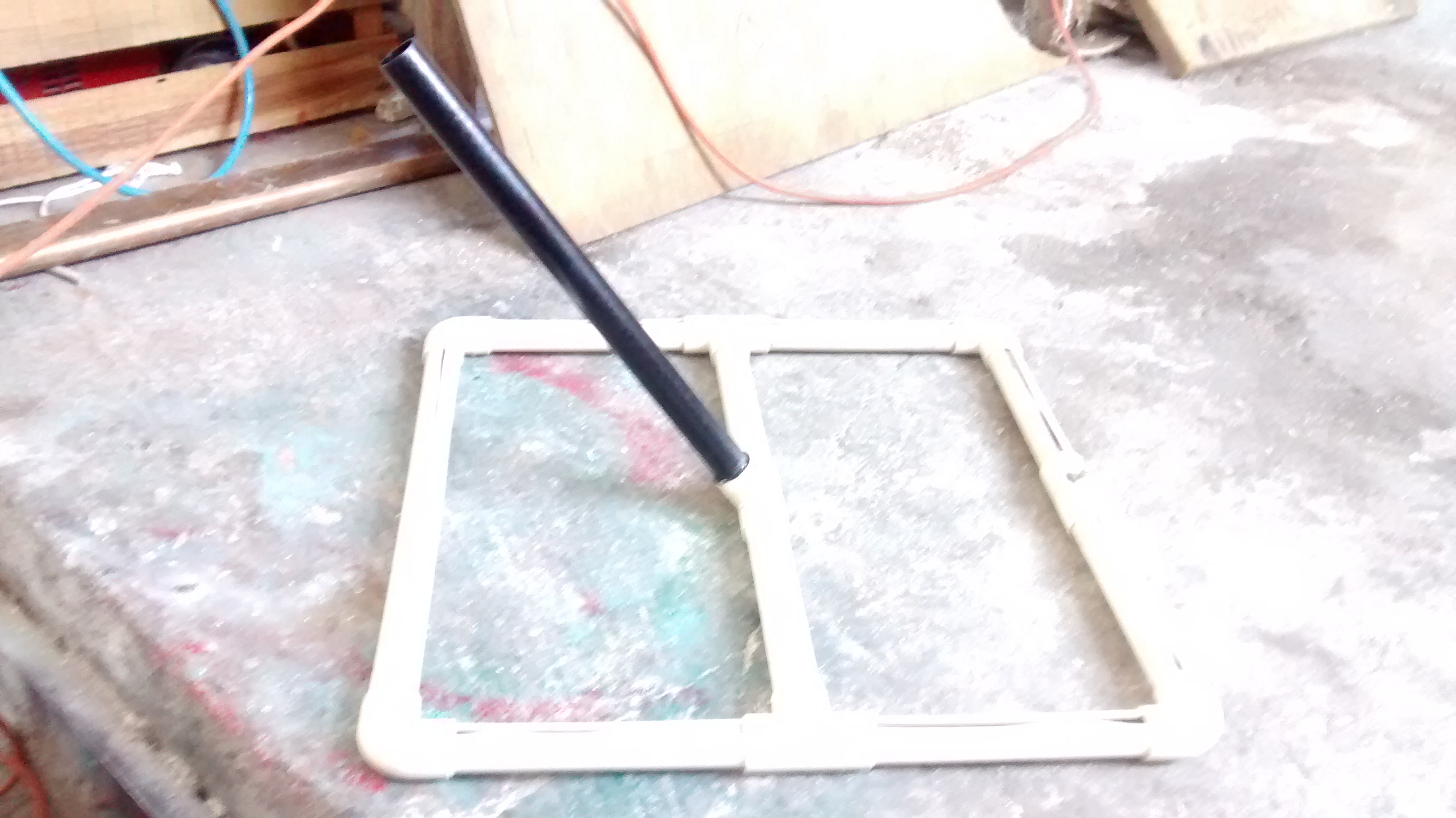

          • This is the coil Click image for larger version
ID:	343186Click image for larger version
              very good.i want buy opa637,but you say do not work for Dp2.are you sure? can explain more.
              and ad845 is around look like lf357, why it is not work too?
              please answer because i want buy one of them .
              first many thanks my dear friend Saromines Ramiel help me.the disk work me for 28cm,33cm,45cm,62cm coils( all around 400 to 550mkh and 2 to 4 ohm).just when near metal to the coil both led for me on and off.and i think it is normal
              but i dont test it with 110*110cm coil.
              and i want use 11nm80 mostfet .and do not find the best replacement .and search for stth1210d , because haven't my country.
              • With OPA637 device is silent. It seems that it works with GAINS larger than 5.
                Now, I don't know what is the gain in this design, but maybe this is the reason it does not work.
                With AD845 the device is constantly giving signal, perhaps the design is also not optimal for this OP AMP.
                Both parts are purchased from reputable dealer so I don't think they are cheap knock-offs.
                Maybe OP-Amp design pros can shed some light, but till then I don't recommend you buy any of those 2 ICs.

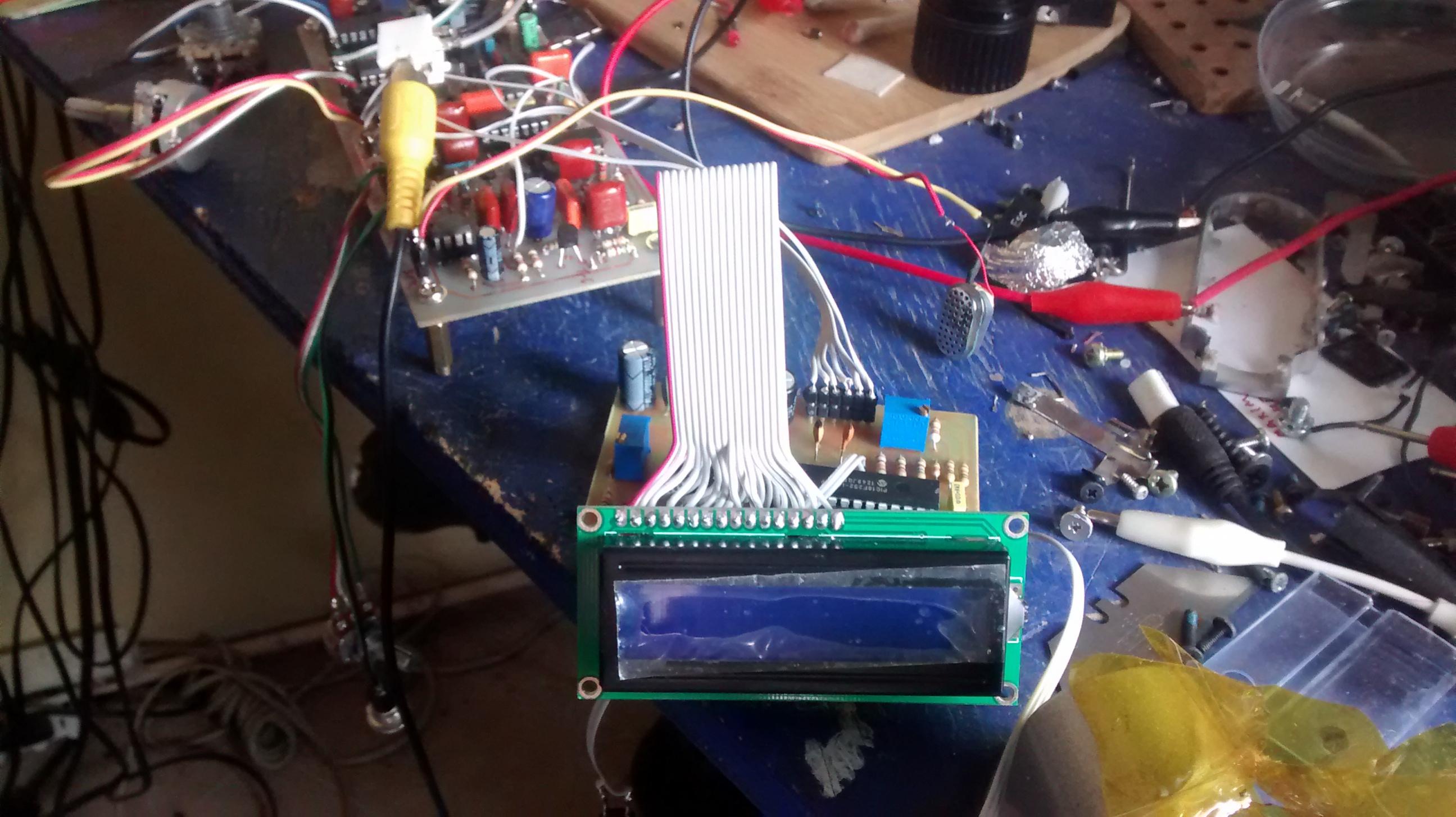

                      You are always welcome my friend,..I use schotcky diode on old PC monitor near HOT drive transistor, work the same for me..
                      • the device works well with default op amps. try also other jfet op amps you have they might work also. it works well indoors even though there are lots of interference sources and i dont see difference in changing frequency with the 100k pot.
