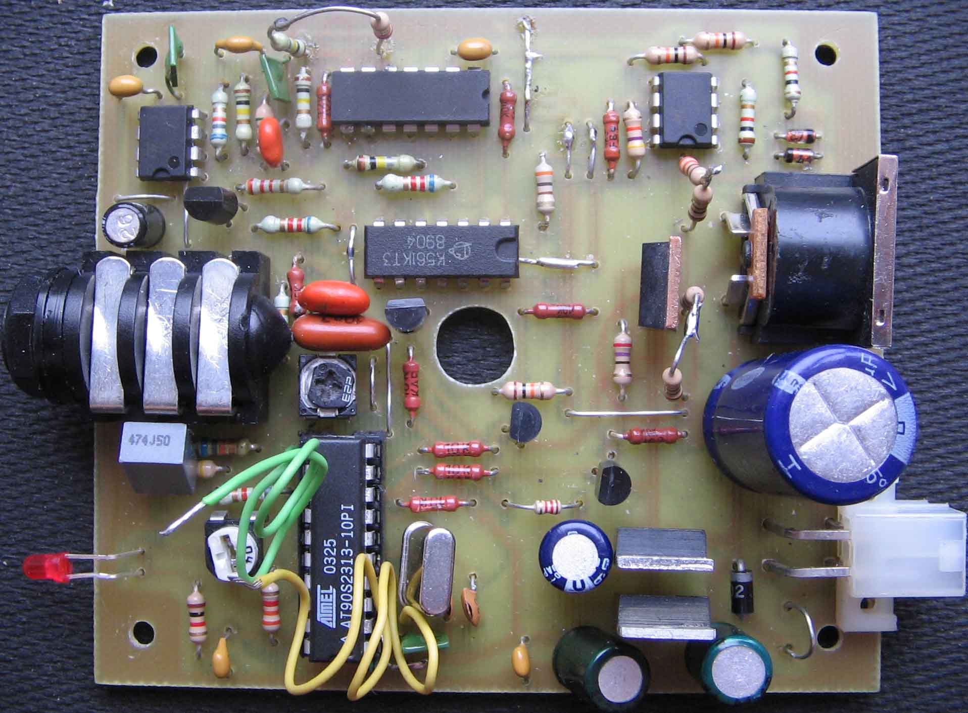

    Hi look it
    hi thanks
    please put for me the lcd pcbs and connection to this board,i download it from :
    thanks
    it is this pcb
      hi thanks
      thanks
      it is this pcb
      [ATTACH]26751[/ATTACH]

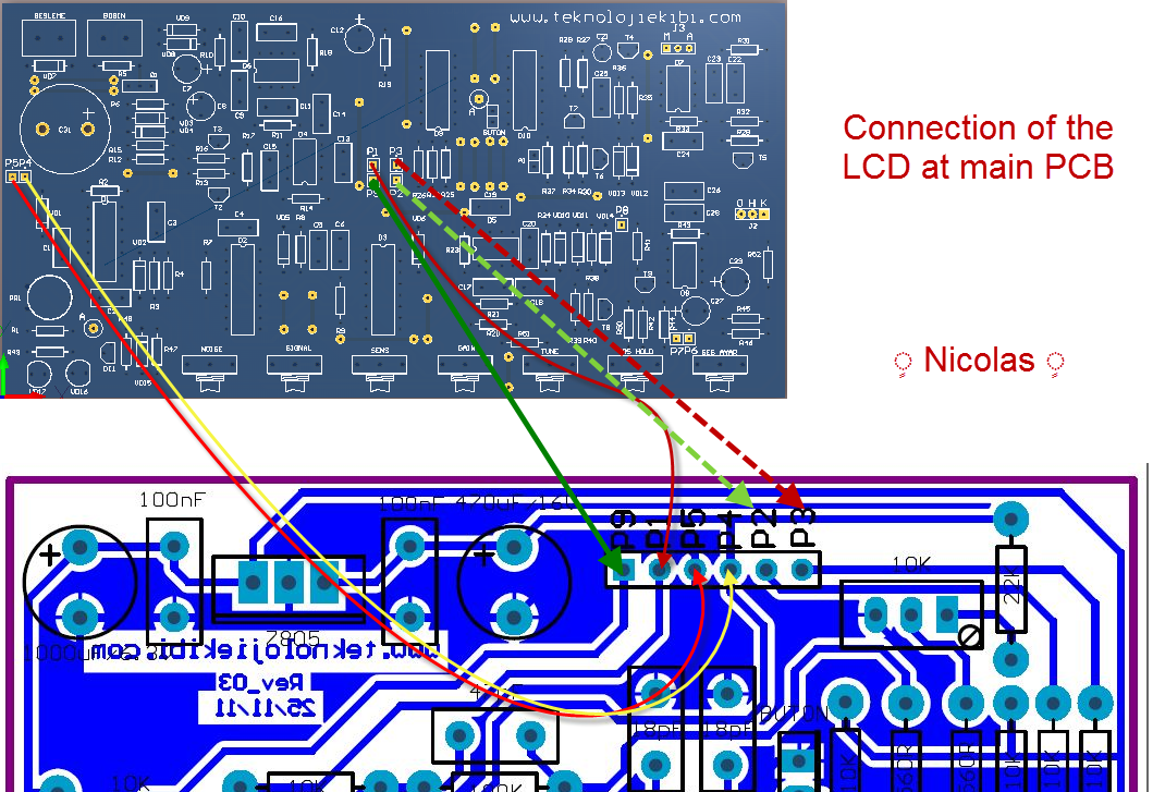

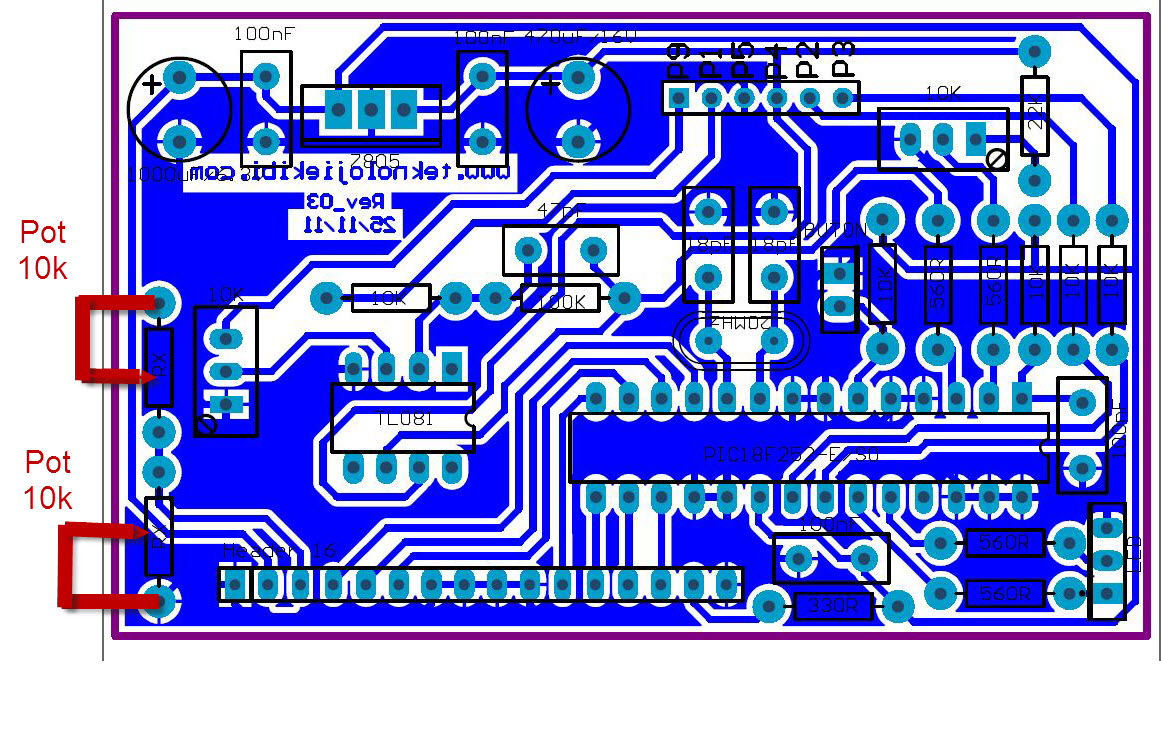

      Hi yes
      look it you find the connection.
      And make attention to change RX by Two pot 10 Kohm to calculate the values exactly for RX. maybe no see the program. Every type of LCD have values for RX
      Good luck friend
      nicolas

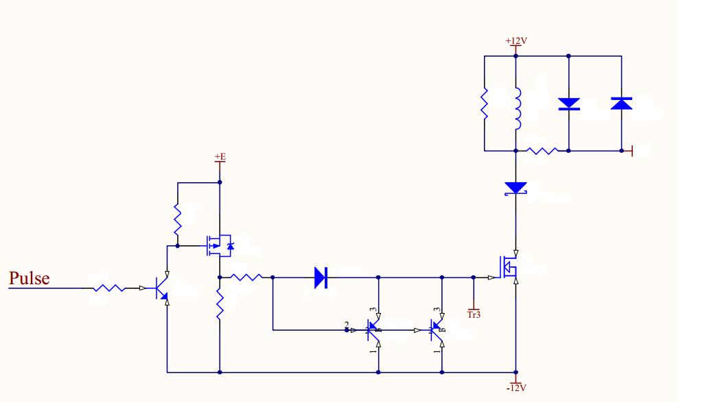

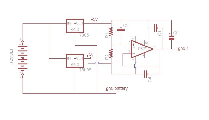

            • Good evening...
              Lately I have a notion that power supply for delta It is not effective..
              I have prepared a figure to see the THINK..
              what is your opinion about this ?? You might be better this way ..
Name:	G.S notion.JPG
              • non-working schematic. seems very strange for me. what you want to say by this? DP has good power supply and needs in only good batteries.
                no need to change power part, waste your time on something another.
                • Can you explain kt315 what is the operating voltage to amp ???
                  I'm confused ????.. is +5 v and-5v ??? is the +12 v end +2v what is ultimately..
                  • if reference level is -12V (minus clamp of battery) then for opamp we have +E=+12V, -E= 0,6+0,6 = +1,2 V
                    if reference point is GND then for opamp we have +E=+(12-1,2)/2=+5,4, -E=-(12-1.2)/2=-5.4.
                    I have to change reference level to +12V... this will be more right for this schematic... my mistake that I copied Bulgarian one straight out...
                    • GOOD MORNING KT315 Can you explain THE BENEFIT IN HIS POWER..
                      • a mos-fet gate has a comparatively big capacitance ~1000pf. if you want to encrease of speed of switching, from open to close state, you need also speedy recharge the gate capacitance. this your circuit must do it.
                        • in your kopilku znanij, drug.

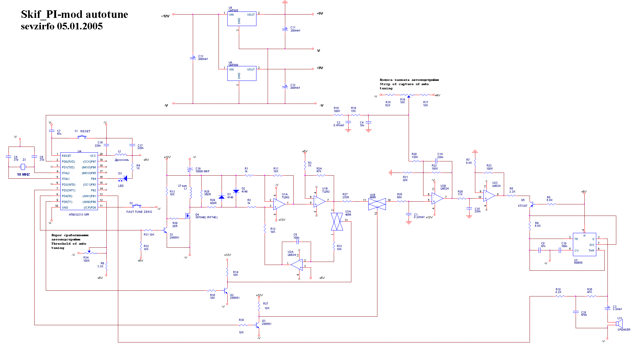

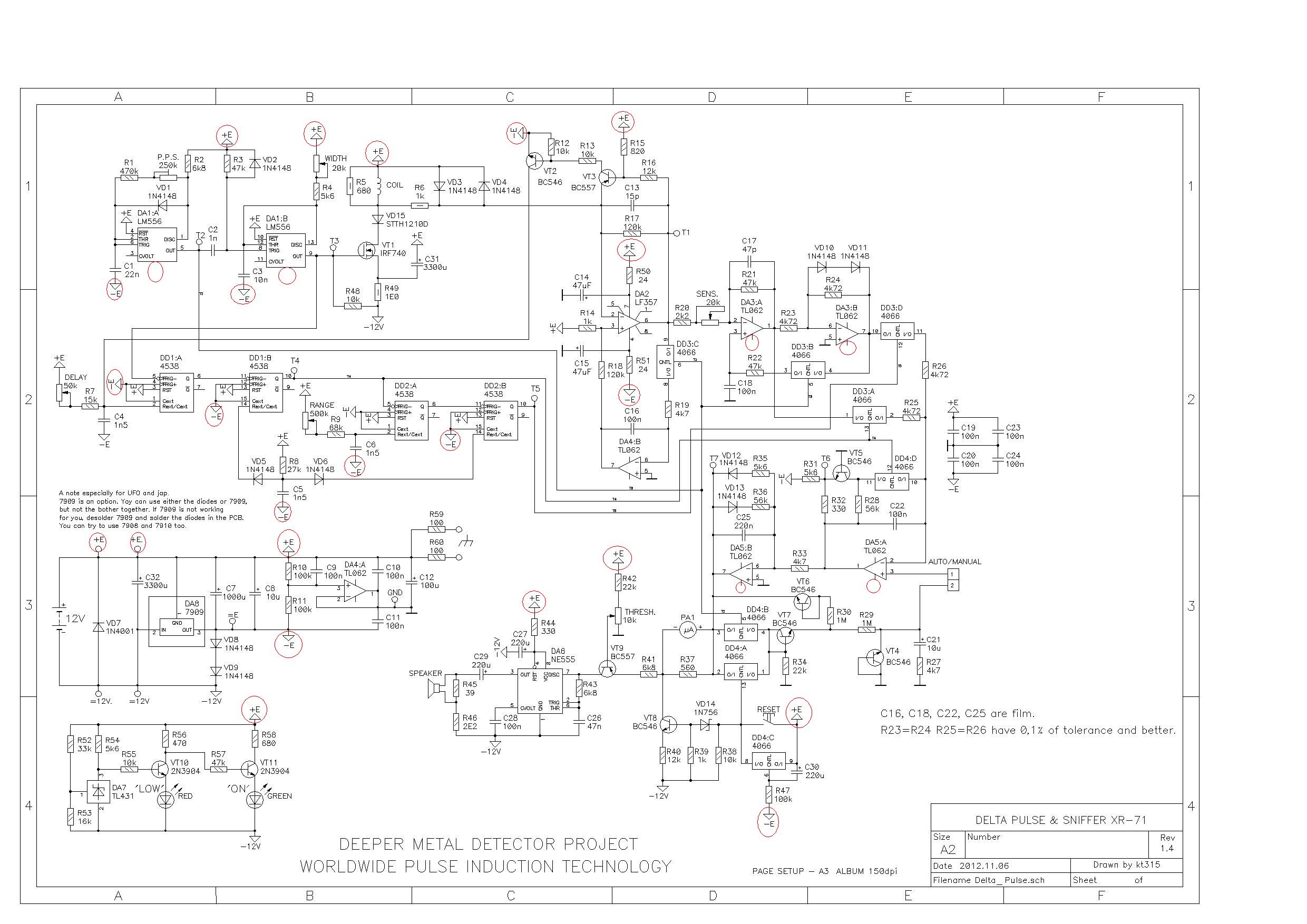

                            • DP on AVR has been released many years ago.( not by me!)
ID:	338104Click image for larger version

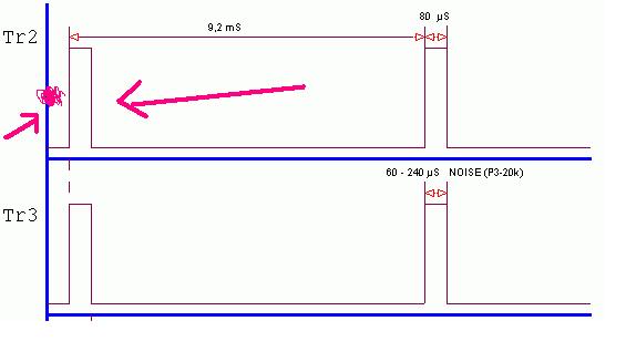

                              • KT315 what is the period of delay at tr2 amounts(us) is.. from the initial pulse ΤΧ (ΤΡ3)..
Name:	g.s Question.JPG
