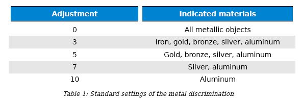

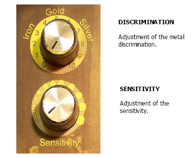

          • hi Nicolas, must still say additionally... Deepers 10DD detector has discrimination ability. but it is NOT the discrimination on principle of 'Ferrous-Non-Ferrous'. it is discrimination 'small target - big target', some threshhold that you can control by a pot.
              Hi Kt315
              Yes my friend I understand you good and what you mean exactly
              Look this for sample in rover deluxe >>>>>
              And yet we are very far from the true discrimination
              Good luck all

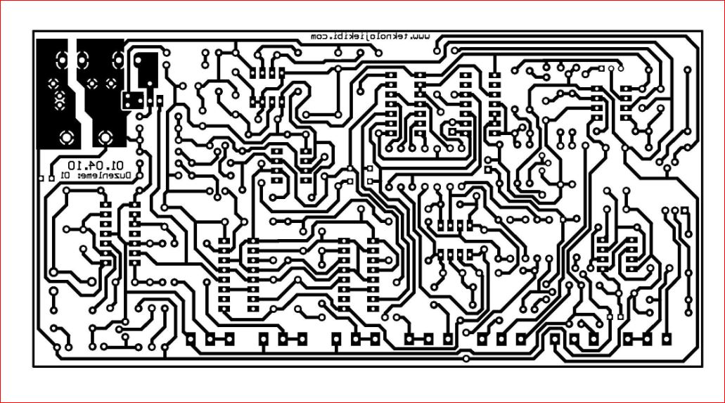

                  • Could someone please post the LAY file for this PCB. This is Turkish version of DP2. Your kind help is much appreciated.
