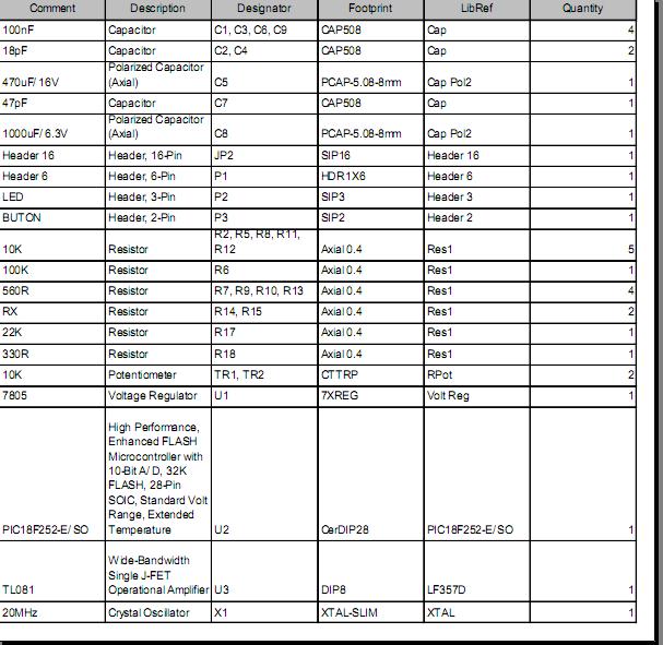

  • can you help me about the list of component for lcd

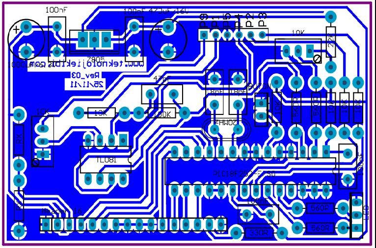

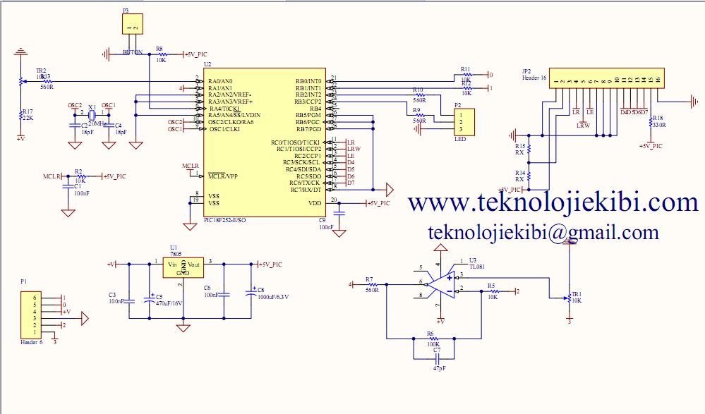

    • no szucs_g. p6 and p7 that i show on pcb and schematic use for lcd
      I attached some file for that lcd.I have delta pulse dircriminator lcd circuit too .i can upload here if you want

      • thank you for your reply but I need the list of component for this lcd

          Your pcb is delta pulse discriminator lcd circuit and i have its all data
          I attach a rar file for you and other users
          enjoy it

            what is the value of resistor RX and capacitor 1000uF 6.3V or 1000uF 16V
            sincerly
            • That resistor is for lcd backlight contrast .I use a Potentiometer for it
              and i used 1000uf 10v for that it is not important

                      • Question about connector
                        What are the correspondence points between main PCB and LCD PCB?
