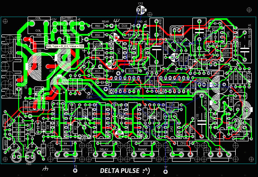

        Do you have any news from the PCB?
        KT315 when it will be finished
        • greetings too... at this step... labtec, i promise you you will get the pcb FIRST!

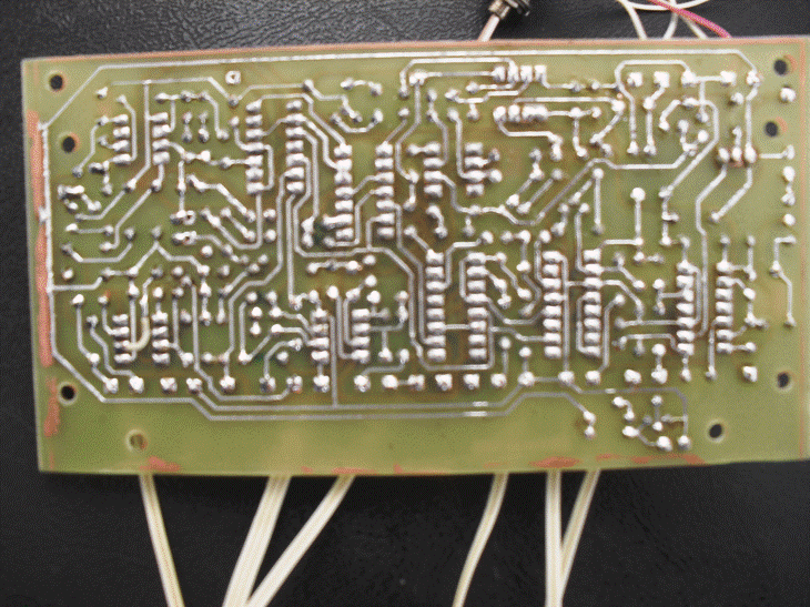

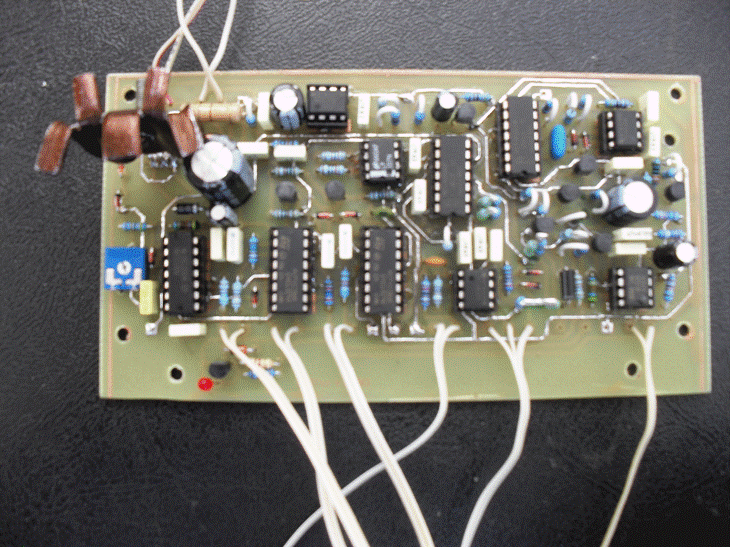

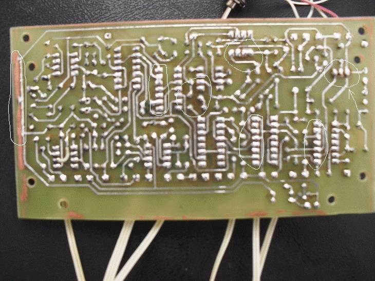

          • I finally made ​​my DP but I can not get him to work
            Behaves very strangely, between-12V and any pin on any IC has 12v?
            The speakers will hear approximately 1 sec. crackling. As it is connected to the device for resuscitation.
            Please help if someone had a similar problem.
            thank you

              • for 30 h does not sleep and does it work DP
                DP on my 13v is everywhere. It's impossible!
                I do not know what more I could do than to start from the beginning and examine and change all
                Does anyone who can write voltages should be on d4 d6 and since I do not have any DP who works with him, and to compare and I've never measured it
                where are you going to check?
                any help is welcome

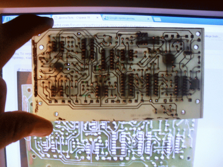

                • Labtec its not a very clear picture, but what is the light brown colouration on bottom of pcb ?
                  for example where its circled with arrow ?
                  • PCB is very transparent and is seen in the background component and solder wire has in itself enough paste to clean so she stayed. to the left is not completely removed all the copper but that's okay because I checked each point several times in a short.
                    I measured the voltage on the attery is 14.4 V, although it would not be that bothered
                    I'm really desperate I have no more idea what to do.

                      • Once again, I have reviewed the entire PCB and I have found nothing
                        . Online I saw that someone posted a picture of the finished DP with the PCB. Is it Any Good?
                        I think I'm going to break with a hammer shortly entire PCB and make a new one.
                        I'm so disappointed. I do not know what could be the cause.
                        as to measure the wire - 12v everywhere. At one point I thought it was a faulty multimeter and then took the new!
                        Do someone could tell me where the voltage on what components should be. I'm sorry I do not have an oscilloscope. There are online programs that operate through the sound card as an oscilloscope whether someone has tried some of that, and what are the results
                        Question for KT315
                        whether the final audit that you set on the previous post I good side if you do not find a solution to this tomorrow PCB throw away where there are no people and start a new
                        Now I understand people who use crutches and sinker in search of gold. preserve the time, money and nerves

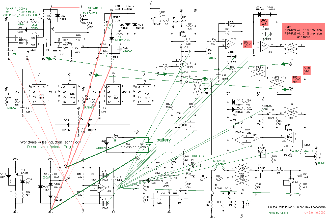

                        • Here are some voltages I think it was posted by KT315
                          • delta
                            Hello to all my *** friends These changes delta pulse circuit shown in an Iranian forum you will approve http://www.4shared.com/rar/oOxbYIrc/...ector_con.html
                              yes, it is mine. I gave this because someone looks on the schematic and sees nothing. this is why in new schematic I did connect all lines.
                              • I think I'm going to break with a hammer shortly entire PCB and make a new one.
                                your deep delusion is if you are soldering sockets for ICs thinking there is a contact. NOT. on board's Top Side the contacts are ABSENT you are NOT able to solder pins of the sockets at Top Side of board because that is impossible. in fabric made PCB all pinholes are METALLIZED but you fully ignore this fact.
