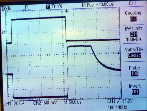

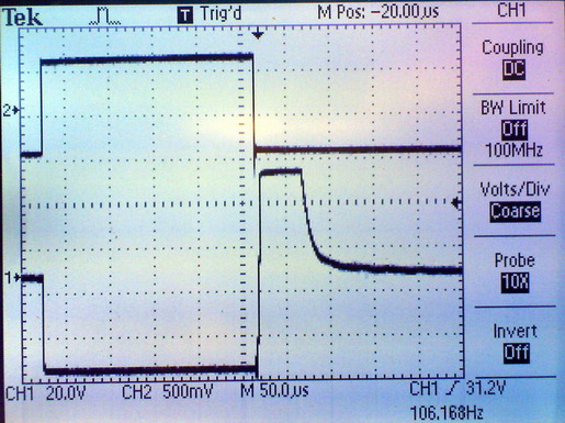

                • Hi Nelson
                  Your coil with 9 ohm can not produced instability.
                  Seem as you use wire with small diameter. Approximately
                  3-3.5 ohm will be good for delta pulse.
                  Trouble shooting without oscilloscope will be difficult.
                  You can see here amplifier out put waveform, pin 1 of tl062.
                  First pic. Without metal near coil .
                  And second pic. With metal near coil.
                  Width of pulse Wave form increase when metal near the coil.
