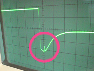

  • My coil is 4" (35 Turns) and the test got done indoor since it is free from most indoor noise. (bbsailor suggested to me)
    I tested different coils (350uH,750uH,1mH... also with resistor in series them) and I found that instability doesn't depend on the coil.
    I think that problem is around D4, but I want to know your opinion...
    I also tried with different frequencies. (100Hz,450Hz...)
    Thanks for reply Geo
    • I don't know why it has a such waveform:

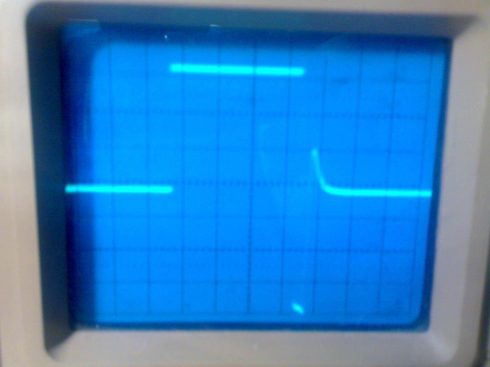

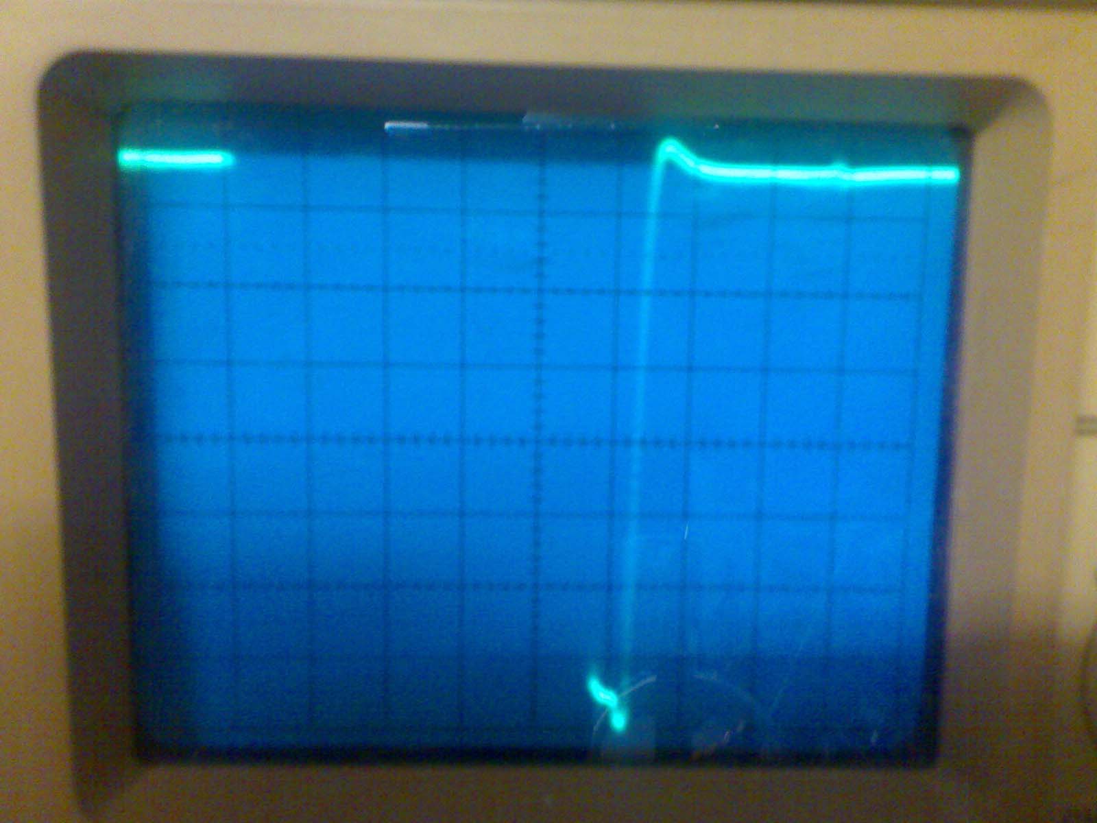

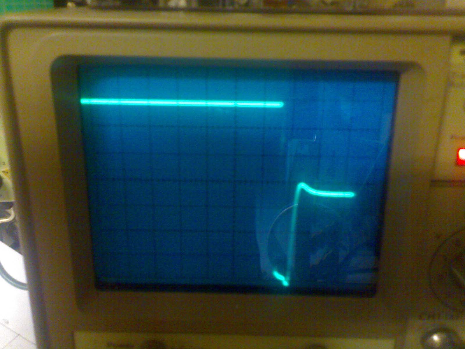

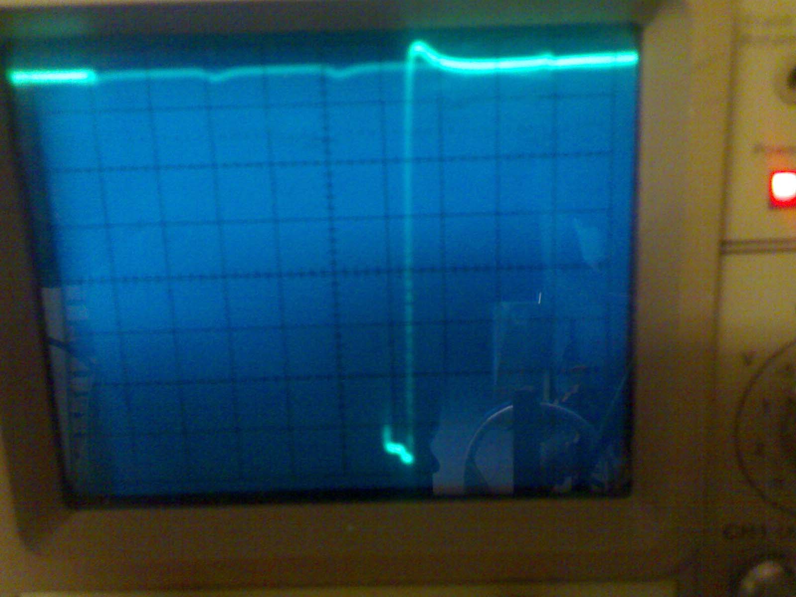

      • Hi 1843.
        I opened my DP and i took 3 photos that i attach here. The first is with the power at midle, the second with power at max and the other with power at min. The photow are with a 955 mH coil connected to the detector. It is absolute stable .
        Sorry for the bad quality of photos but they are with mobile phone
        • I forgot something
          Ohh i forgot...... My DP works at 350Hz and the coil (10 in) has 8.5 ohm resistor (without resistor in series), i don't remember about turns and wire diameter.

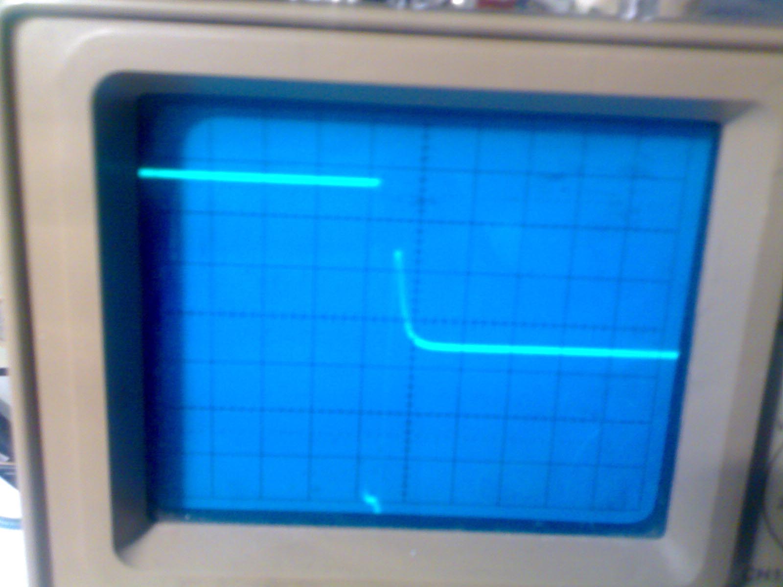

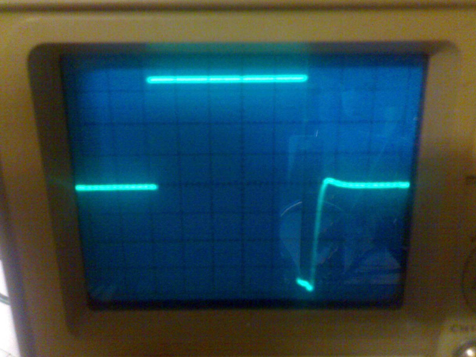

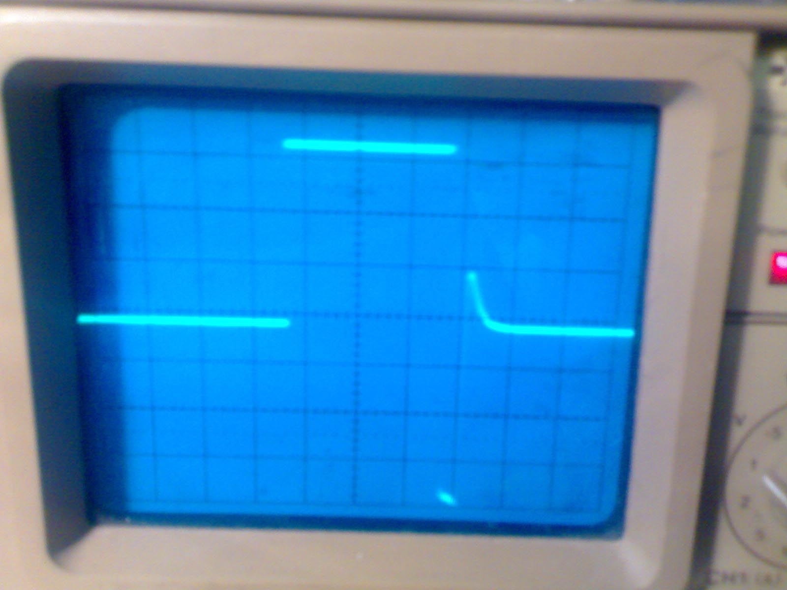

          • Big mistake
            Hi 1843. It was a bag with foil near the coil so the waveforms are not ok. I attach you 4 photos. The first 2 are with power at min and max. The other 2 are with gain at max and min (there is a change at the down place of waveform.
            • Your waveforms look OK...
              I will try to finding the problem...
              Many thanks dear Geo,
              All the best.

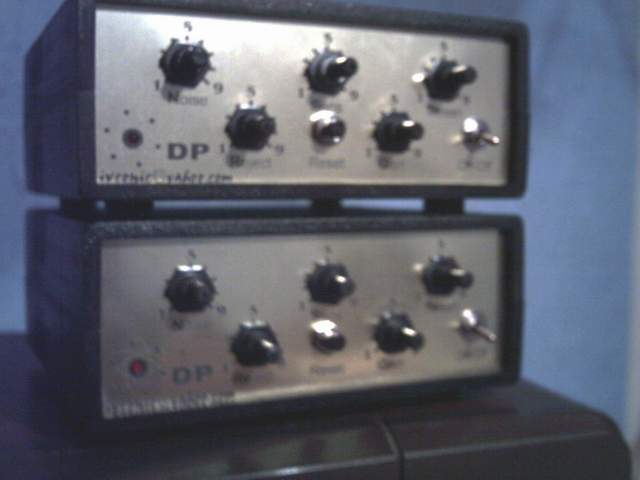

                      These days interest grows on Delta Pulse.....!?
                      So i made two more.....
                      It showed as best compromise between costs and performances...
                      I deeply advice everybody to make one....
                      Regards!

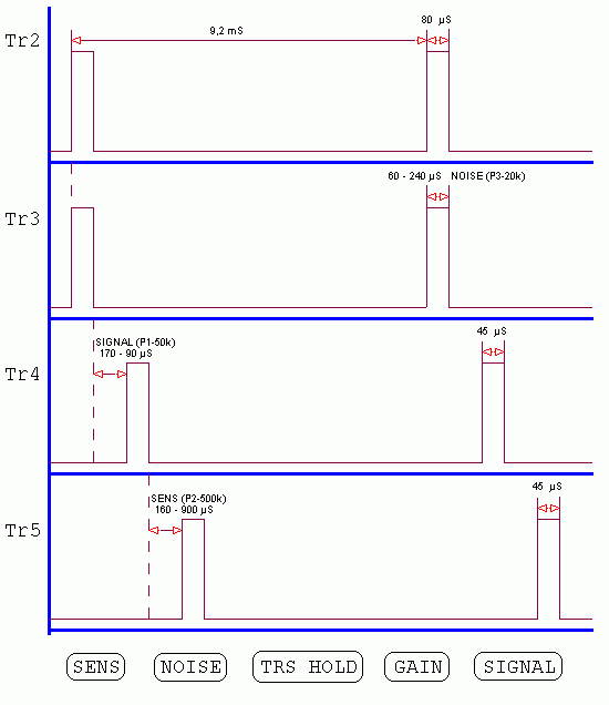

                      • Hi paulo. I attach you a file that i found today in my hard disk and it has waveforms from Delta Pulse (i don't remember where i found the file, but is very useful ).
                          thank you.
                          best regards
