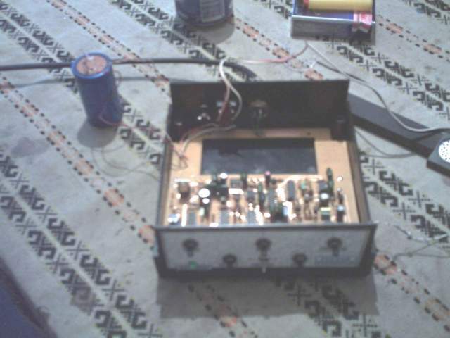

        • ABOUT delta pulse schema
          I built delta pulse . But it is not working properly.
          ı saw that there are 2 schema about delta pulse one of them there are connections cd4538' s 8. and 16. legs -V +V but one of schema not showing connection to this legs which shema is true?
          Geo or onebody answer this I will be glad.
          one more thing VD12 and VD13 connection ways different because connection of R s place changed new model pcb by kt315.
          I dont know it is important or not
          • I built Delta Pulse by chematic, where leg no.3 is +V and leg no.13 -V (453.It works.
            • Sorry, legs 3, 13, and 16 +V, 8 is -v

                • Originally posted by Satel
                  Sorry,
                  hi eroll
                  Satel has right
                  leg 3.13 and 16 +E
                  Leg 8 and leg 1 at -E (be careful not at gnd)
                  good luck

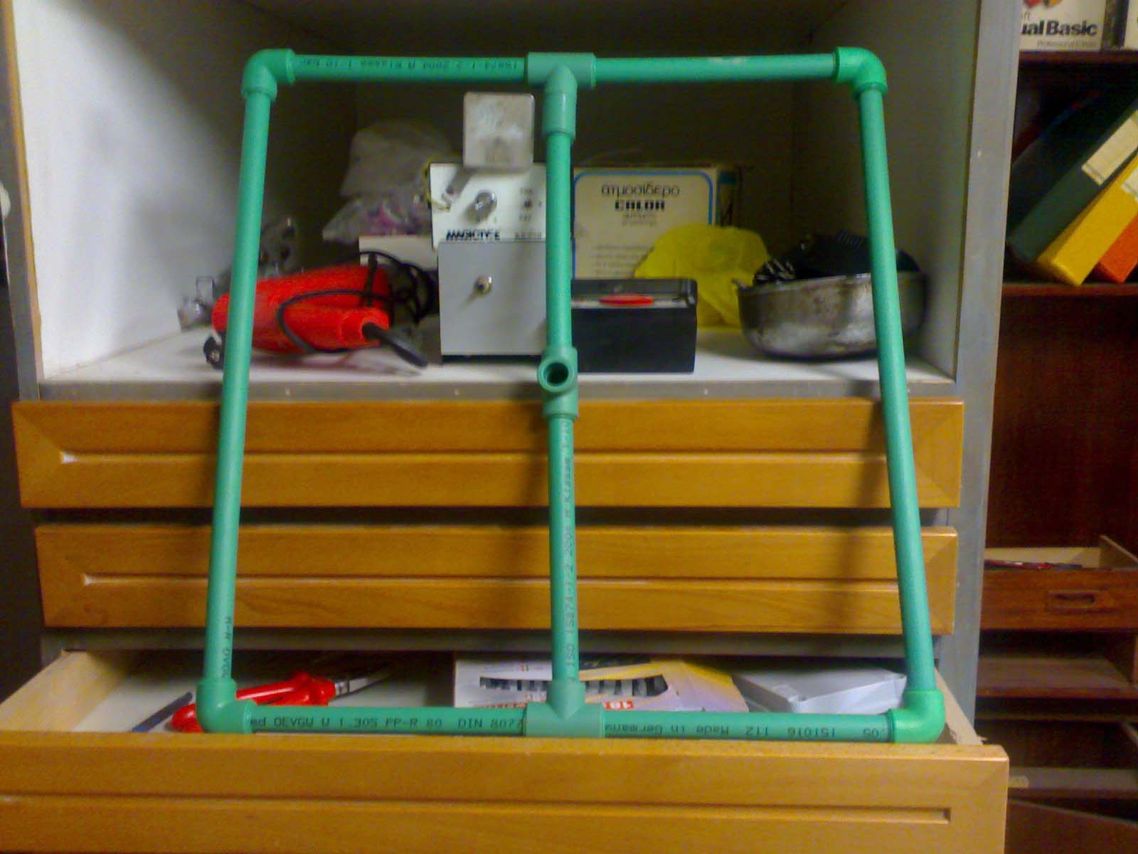

                  • This time i am building a square coil 60 x 60 cm. When i will finish it i will send the results.
                    • Nice...
                      Water pipes !!!! I made one simillar, but 30x30cm....
                      It is working good. I put 30 windings in it,0.4mm....
                      Good Geo !!!
                      • Originally posted by ivconic
                        Good Geo !!!
                        Hi. How you inserted the wire? I will cut the upper side of pipe and i will insert the wire. After it i will close the cut with thermo silicone. I will try with 2 winds. 28..30 turns for 100 hz and 12 turns for 400 hz. I will send photo.
                        • Using pipes is very interesting idea. The only thing I have in question is heat dissipation _if_ they are plastic, pvc. If they're metal then ignore this post. I believe plastic is a poor conductor of heat. So I'm just wondering how much heat the pipes can dissipate. Perhaps it will be enough, but I think the wires will be noticeably hotter than normal. As you know, heat increase wire resistance.
                          my 0.02
                          Paul
                          • Originally posted by pml
                            my 0.02
                            Paul
                            Good question. I did not think it by no means. The pipes are plastic and I do not know how much heat it can dissipation. In any case the increase of resistance will not be big for a increase of temperature of inductor at 20..30 degrees of Celsius. The experiment will show if exists problem.

                              • No problem...
                                I cut my pipes same as you planing..Only way to do it!
                                Don't worry about heat, no heat at all....There is 2.5 Amps current in my
                                coil and no heat after 30minutes....at least no noticeable changes!
                                I filled pipes with "pur penn" mass...
