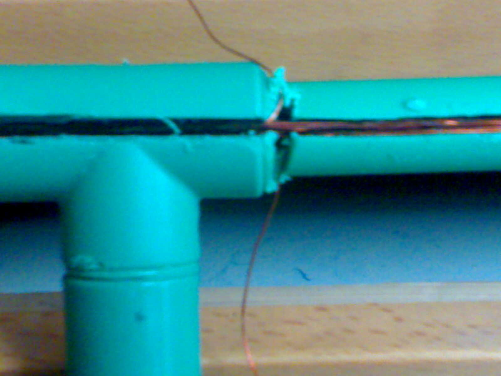

  • First test with 16 turns no good. I will come back again with second test with 30 turns.
