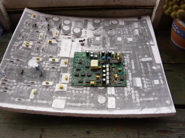

    can you write what the board sizes would be optimal in your opinion? what box you are planning to use? what mounting dimensions would be good in your opinion?
    I don't know sincerly , if you mean that the work is in progress ok we wait some days
                please post the new PCB

                    I have to do WITHOUT MISTAKES. it takes much time.
                    sorry for a delay. I have to solder King Cobra PCB back. People ask about coil tuning but without working board that is impossible. I am bursted between DP and Cobra in one hand is the PCB soldering, in another DP board in P-CAD.
