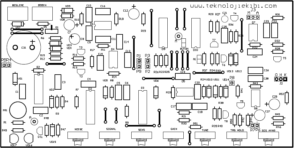

      Is this the right one?
        Alright, one other possibility I left out was a missing jumper.
        If I understood your first post correctly, you should stop thinking about
        replacing parts and instead start tracing wires on your PCB.
        Get out your schematic diagram, look at where you have +E and -E and where you don't, and then narrow down the defect.
        If you have a PCB trace diagram showing traces and jumper placement, that would be helpful in tracing the power loss.
        Hi
        no, my first delta is what you uploaded, that work just fine, but my second delta that i have some problem is this:
        • Yeah but see the point I was trying to get across is that a picture like what I uploaded is very valuable as a troubleshooting aid.
          So, if you decide to go troubleshooting your dead Deltapulse, don't you want to have all possible troubleshooting aids at your disposal?
          Well?
          Good hunting!
          edit: If you can't find the correct trace diagram you can still turn the board over and look at the bottom as you chase different signals for troubleshooting. But, it is a little easier if you have the picture to look at. Less gray hair is generated.
          It's just a single layer board so it shouldn't be too hard to find the problem. Even though my picture is not exactly right it might be better than nothing.
            Well?
            Good hunting!

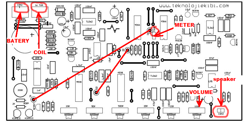

              • Dear friends,
                Please help me with connections of Delta Pulse. I soldered all components but confused where to connect Speaker, Coil etc. Should points labeled B be short circuited? A too?
                I have marked the points in the image
                Thank you !

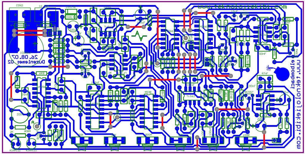

                • such
                  • Thank you mollax !!
                    Any idea how this version of Delta Pulse differs from the newer one in post #1338 ?
                    Are there much improvements ?
