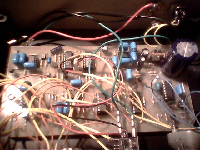

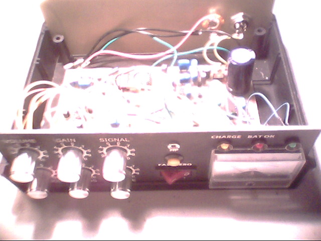

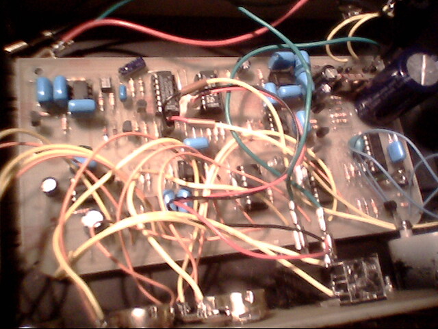

                            • My DP Pics
                              For KT315
                              Help me pls
