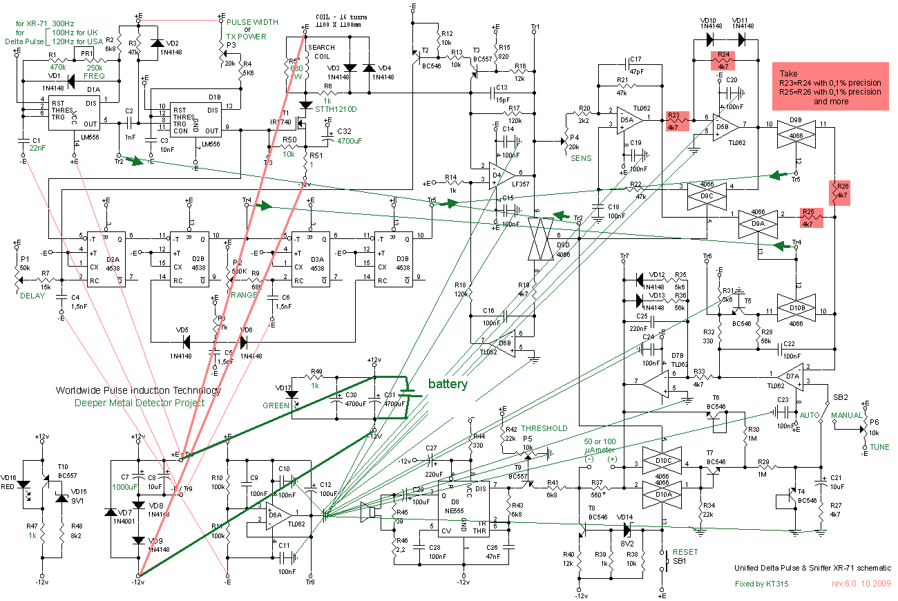

      • hi i maked double side bord by triti without battry checker but delta pulse note workng at all after making test i found that the ground isnt connected to negative of battery are this normal br!
        • salim, the Ground/Zero of the schematic is output of D6A. it is kinda a power supply voltage splitter. you are misleading. DO WHAT YOU SEE AT SCHEMATIC AND DO NOT TURN UP YOUR FANTASY HERE
          • sorry kt315 i maked simple side pcb succefuly but double side make me creasy i will check all track again plz delate FANTASY post thanks br!
            • check all according this plan

                    • D. PULS
                      Hi KT315! What are the parameters of the diode SITH121 OD ? I can not find it in the catalog.
                      G.L!

                        • Originally posted by georgi.g.zhelev View Post
                          G.L!
                          thinking you gives unright search data. STTH1210D
