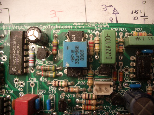

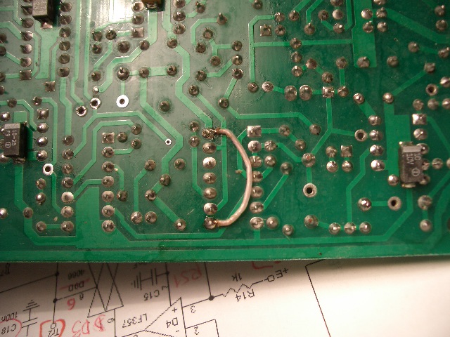

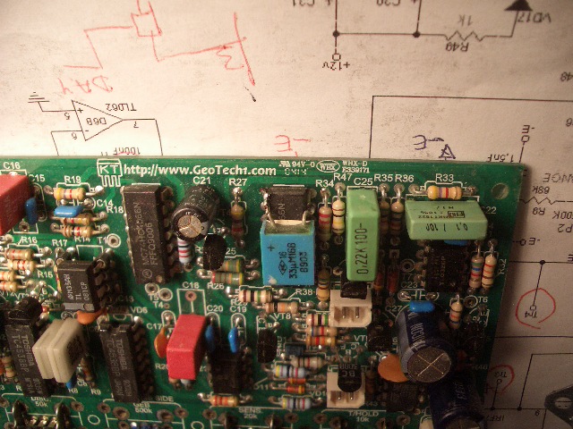

    • On the mod you posted KT should I just add the cap and just jump on the board you sent or is that for a board that's homemade
      • I suggest to make the mod at end when the board would be full tested and working. on your choice... DP will work without the mod too.
        yes, same board you got. to add a jumper on back side and the cap on top side to pins of the IC.
        • OK so I get it working first and if the mod seems like something I could use then I'll try. By the way that DVD is amazing.
          • yes. at these pics as the mod made on my pcb in final result.

            • Seems simple enough first though got to make it without big mistakes.
                [ATTACH]28867[/ATTACH]
                [ATTACH]28868[/ATTACH]
                [ATTACH]28869[/ATTACH]
                hi
                i add 22mikro like you , but LED red always on next burn the 1A fuse and VD9 and VD8 .
                  hi
                  you have to add all links, a resistor 100k and electrolytic capacitor. above I mean only my design, it has already some links, your turkish one has nothing.
                  you have to consider this factor.
