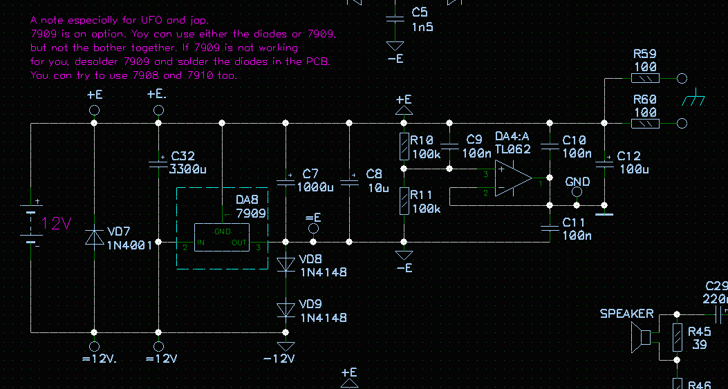

      • Originally posted by kazem2114 View Post
        Thanks but the things that you're saying , it looks like we have 2 voltage source
        one to give +12v
        one to give -12v
        because the voltage of negative prob of a battery is not -12v , it's like ground
        Am i right?????????
        There's no circuit for making -12v in the schematic
        -12 goes to your battery minus clemma. +12 goes to your battery +12 clemma. WHAT IS NON-CLEAR THERE FOR YOUClick image for larger version

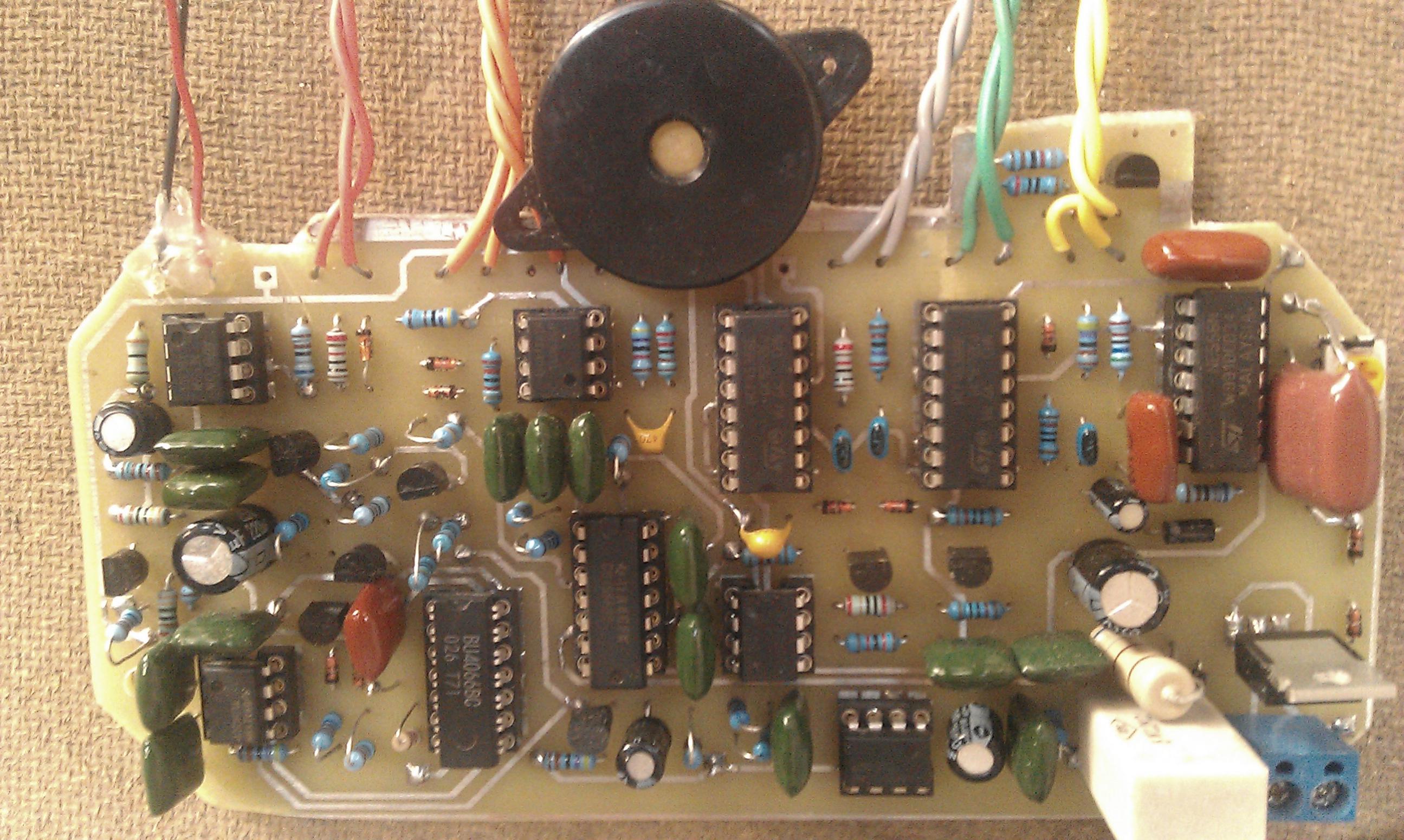

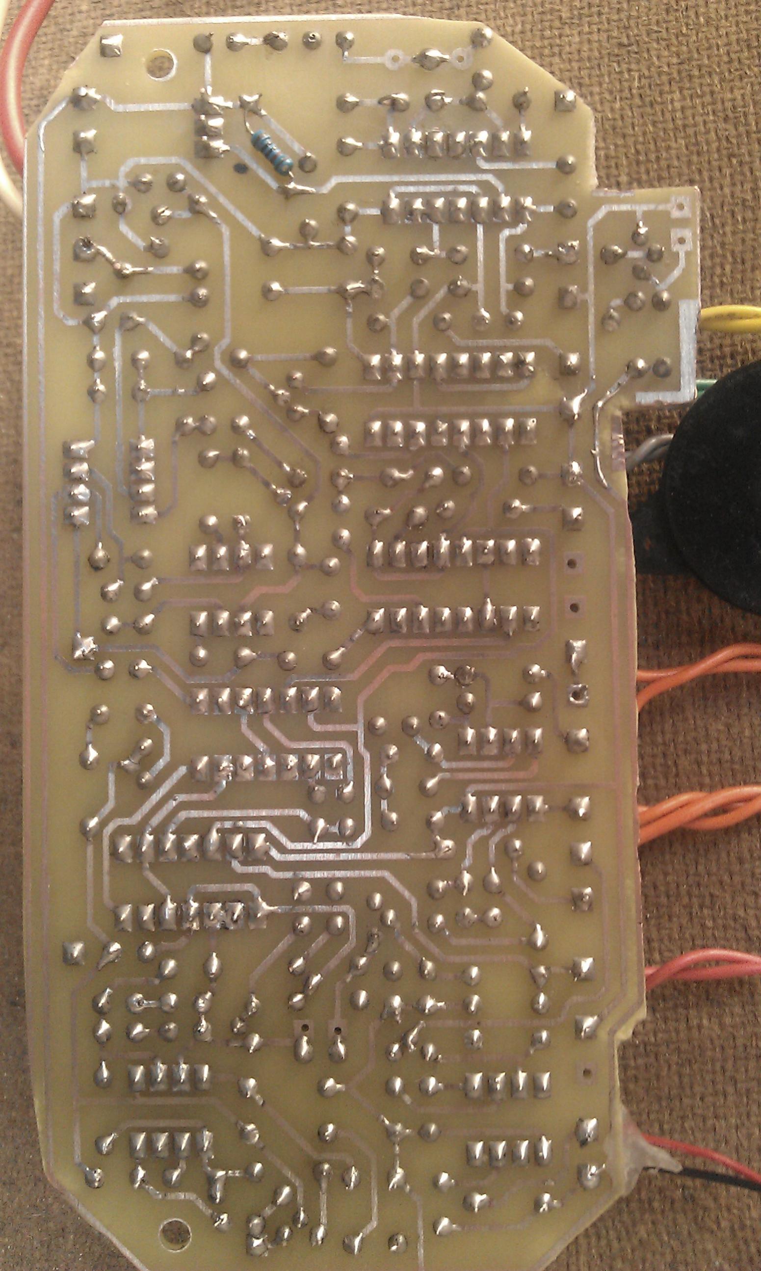

ID:	333560Hello dear KT315
              I used a this pcb , But has no sound ,
              please guide me

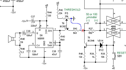

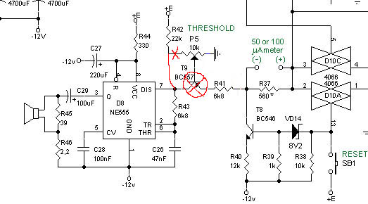

              • hi Belief,
                you can try to reach the sound via a way I offer. make like this you see on the diagramms and find the problem

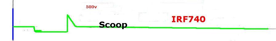

                        • Hi Freddy67
                          You can not use it for the following reasons,Different values ​​of voltage and resistance entry gate is too small 0.024 OHM BUT IFR740 IT HAS 0.5 OHM, you must modify the income by using Tr,R.Final value of the Volt must 600v.
                          best time
                          j.
