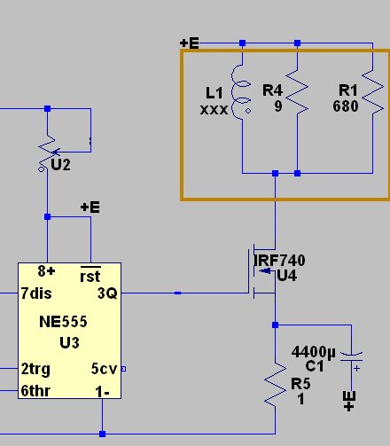

    i change mosfet to irf740 but when i start , ihave 2.15 A
    don,t have 150ma
    i think i must change my coil, is this true?
    my coil is 30 turn of 0.35 with 3.4 ohm resistant then i paralel with 9ohm resistant
    for 3 ohm coil
    can you guide me please ?
    Bad idea.
    You don't have a three ohm coil. What you have described is a 9Ω damping resistor across your coil and the 680Ω.
    So, you now have a 9Ω || 680Ω =~ 8.88Ω. That is equivalent to having a 8.88Ω damping resistor, as I understand what you described.
    By the way, when you tell us you have "x" many turns of "y" wire, you may have well have told us nothing, because you have left out the equally important (for the purpose of calculating coil inductance) coil diameter.

                You will be better off if you do not use enamel wire, (also magnet wire, lacquered wire)... it might go by different names, but all are similar.
                Enamel insulation is thin; too thin make the best coil because interwinding capacitance will be higher than with PVC or Teflon insulated wire. 0.35mm diameter is a good choice because it is not too thick. The Deltapulse can draw excessive current if the coil wire is too thick.
                Try to make sure your wire has [PVC or Teflon] insulation rated for 600V.
                For your 2.2 ohm resistor between the coil and IRF740, use a 1W resistor, otherwise when you turn pulsewidth and PPS up high, the resistor may get too hot.
                I still say you need 430 ohm damping resistor for best result, but that is only a guess because you need to use either trial and error (experimenting by using different resistor values), or else use a good oscilloscope, to make that determination with any certainty.

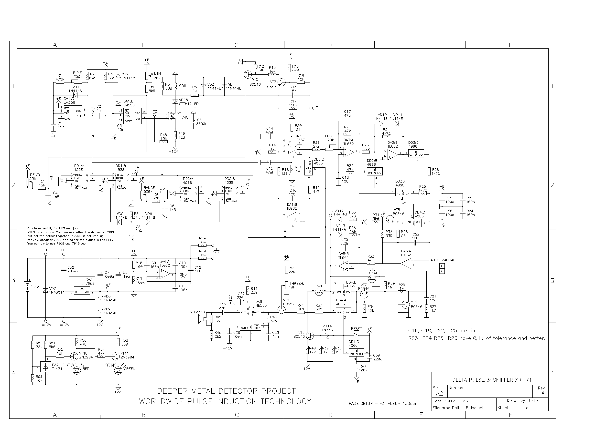

                      • hi kt315
                        thank you
                        can you say me how i can use from pr1-9 pin please?

                                hi, where you found or see pr1-9 pin? point me on the schematic.
