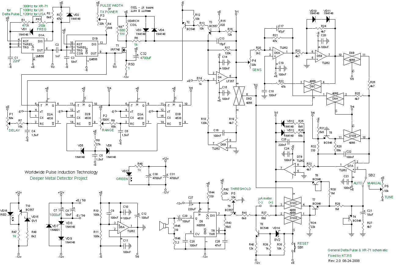

Delta Pulse
    has slow Slew rate low noise is well. for preamp will be not serve.
    but probably will be good for VLF's like TGS.
    anyway thanks.
    Uhm , yes... its slew rate is not much...
    I think that instead the TLE2071 is a fair better choice than TL081 today... do you agree ???

          • thanks lots everyone.
            refreshed cross referense list seems such
            D4 - AD744, TLE2071, TL081, КР574УД1, К140УД23
            D5 - TL082, TL072, LF353, LF412, TLE2072, TLC072, LT1057CN8
            D6 - TL082, TL072, LF353, LF412, TLE2072, TLC072, LF442, LT1057CN8
            D7 - TL082, TL072, LF353, LF442, TLC072, LT1057CN8, TLC272, TLC277, TLC27M2, TLC27M7, TS27M2, TLE2062, TLC2262
            HH
            • new updates of schematic
              • recheck the part list.

                      • Dear Kt315
                        I built a deltapulse but it doesn't work well, i change the parts and check all items but i can't find diffrence between my deltapulse and the pcb that is in the forum , i don't know where's the problem ; is the pcb and schematics of deltapulse in forum have errors ?
                        please help me for finding error free pcb and schematics of DP , i'm so confiused between too many shematics and PCBs
                        Best regards
                        Alex and another folks! I NOTE AGAIN. I DO NOT ANSWER VIA PM IF YOU ASK ME 'HELP SOS AND WHERE IS THE PROBLEM'!
                        if you have a good schematics, good suggestions, good releases, good updates, good tracing PCBs etc. on matter we discuss- WRITE ME WITHOUT A DELAY AS SPEEDY AS YOU ONLY CAN SPEEDY VIA PM VIA E-MAIL VIA A CALL VIA WHAT YOU HAVE OF!!
                        your problem Alex seems you do NOT read attentionally the postings as you must read. remember! - you must PRESICELLY LINE UP R25=R26 and R23=24. with MORE THAN 1% ACCURACY!
                        second what you have losed out. the working frequency must be ABSOLIUTELY PRESICELLY 100 PPS. or what you have industrial frecuency multiply on TWO. if you have 60Hz than you must have 120 pps.
                        take ONLY poliester capacitors with minimum loses for holding ones - C16, C18, C22, C25. NOT USE CERAMIC CAPACITORS HERE!!!
                        HAVE A HAPPY TODAY!

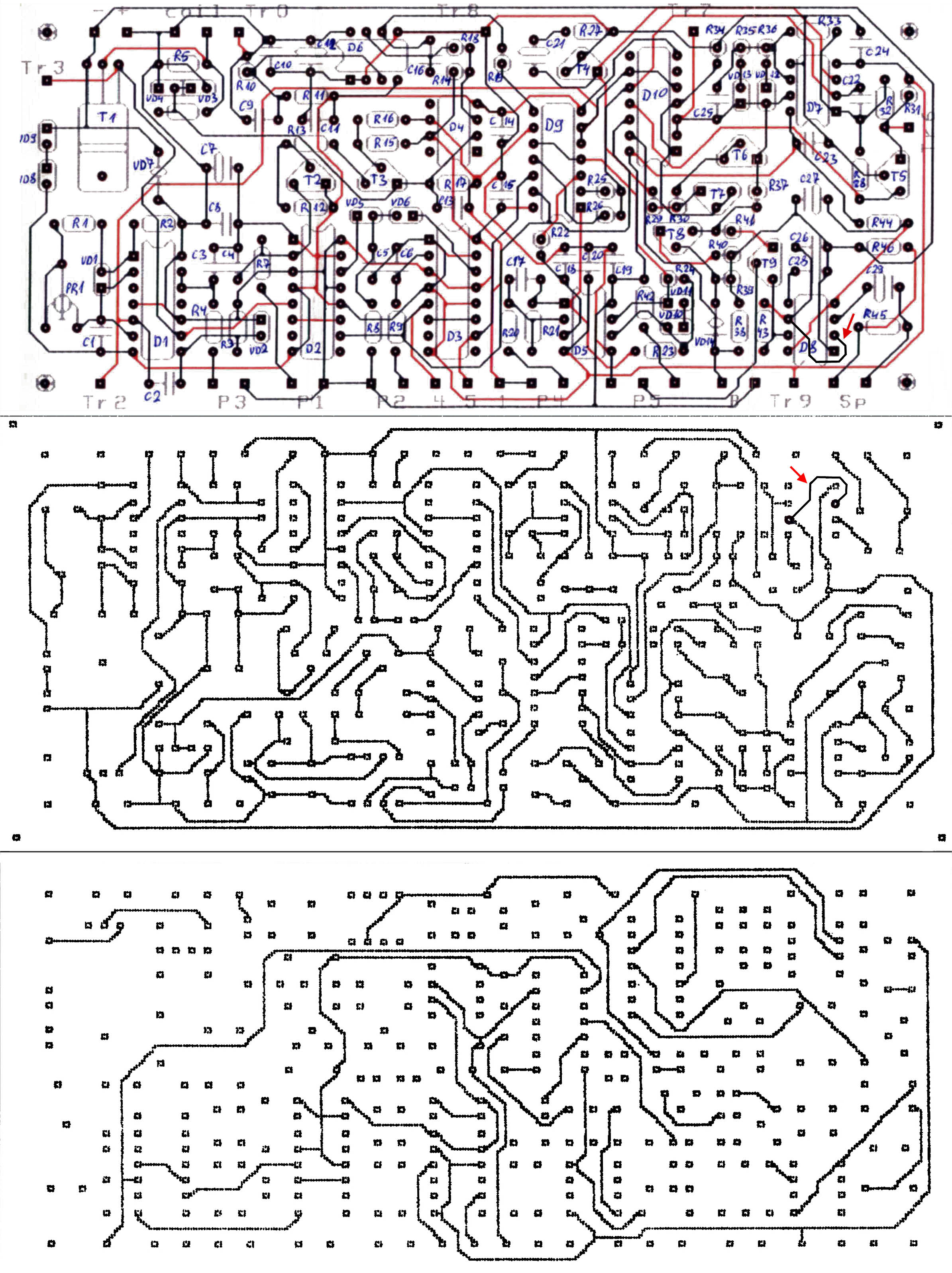

                        • Help around DP
                          Hi Dear Kt315
                          How are u today?Thanks for ur guide around DP.
                          Have u Final Fixed PCB(for ur fixed Schematic) for DP with PDF format?
                          If yes pls insert into forum.
                          and next can u attach a LCD for DP?
                          thank u again and goodluck
                          • Originally posted by batman1972 View Post
                            Hi Dear Kt315
                            hi. fine. thanks. the PCB layout is oldie and classic in form. I got fabrician PCB from camrade Treiti (NOT FROM ABAN AND GEORGIJ. WHO ARE ONLY PROMISING TO SEND BUT NEVER DO NOT PERFORM THEIR PROMISES!).
                            about LCD - I am not guru in it.
                            have a nice day
                            • enjoy. LAY file is SPRINT LAYOUT-5 of.
