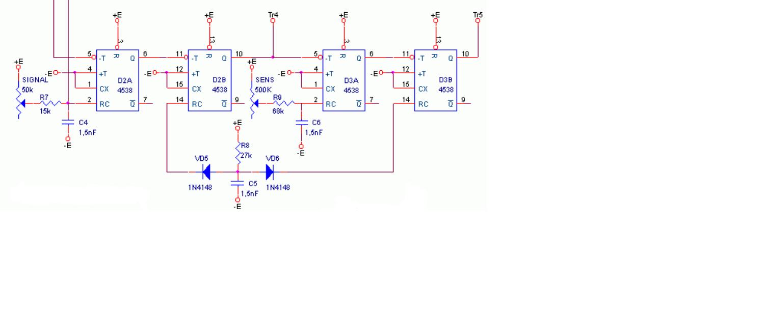

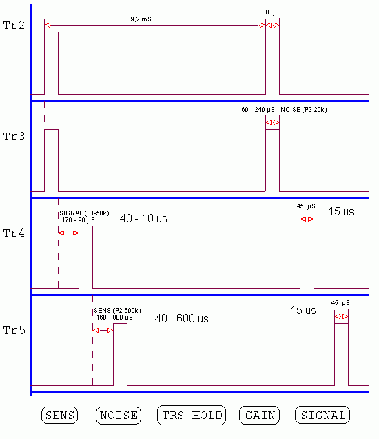

        • TR4 / TR5 versus component values
          I have checked the whole Delpa Pulse forum thru several times, but couldn't find what I was looking for. The timing of TR4 and TR5 in my DP are different form the often seen timing diagram. Values of my DP are in large numbers in the diagram below. I use 4528s instead of 4538. I believe they are the same, the 4538 being just a bit more precise. The data sheet of 4528 gives formula t = R*C*0.3, where t is pulse width [s], R is resistance [ohm] and C is capacitance [F]. When I compare the values from the formula to measured ones, they are of same magnitude. So, I believe the component values in the picture below match with the data sheet formula.
          What would be the values for resistors and capacitors around the two 4538s to get the timings like in the diagram? Yes, I could find them myself. I'm just wondering if I have missed the correct component list or if the timing diagram is of a DP with "tuned" performance.
          All hints appreciated.
          • can you digitally shoot all markings on the capasitors C4 and C5? is not clear from your comment what you did stay on your PCB really.
            • C4 and C5
              I can't take a picture right now, but the capacitors are 1.5nF. I have been playing with components since 1980., so I'm pretty sure. I also measured them with my capacitance meter.
              The funny thing is that the formula in the 4528 data sheet gives the same result as measurement with the oscilloscope.
              Could it be, that 4528 has some undocumented feature which makes it behave in different manner from 4538?
              I need to get 4538s, I just built the DP from the components I had on stock.
              • Could it be, that 4528 has some undocumented feature which makes it behave in different manner from 4538?
                I think it is a cause. 4538 gives me a diagram accordingly to original one.
                • Originally posted by Mullihaka View Post
                  Off the top of head, I think that 4538 devices have a direct t = R * C ratio, with no 0.3 factor involved. (And, by the way National Semiconductor's CD4528 datasheet states: t= 0.2ln[Vdd-Vss](RC).) Little details could make a difference.
                  Look up natural logarithms to find out how to apply "ln".
                  But also, not all 4538 devices are the same. Besides having a slightly different timing formula ( compared to NS CD4528 ), some " 4538 " manufacturers specify minimum values for R, or C, or both. It is a good idea to read the datasheet for any specific device that you are using instead of generalizing! MC14538, CD14538, HCF4538, and CD4538 are all very close - but there subtle differences.
                  There is no "the" 4538 datasheet unless you are being specific. That probably goes for 4528s also!!
                  • Thanks a lot! Just found the same factor "0.3" in the 4528 data sheet. Better read the data sheets first than jump straight into experiments. No harm done, only couple of days spent.
                    • from these proportion formula you can divide 45us/15us=3 and on the digit to multiply C5 (or what you want to change).
                      for example. C5=1,5nF*3=4,5nF ~4,7nF
