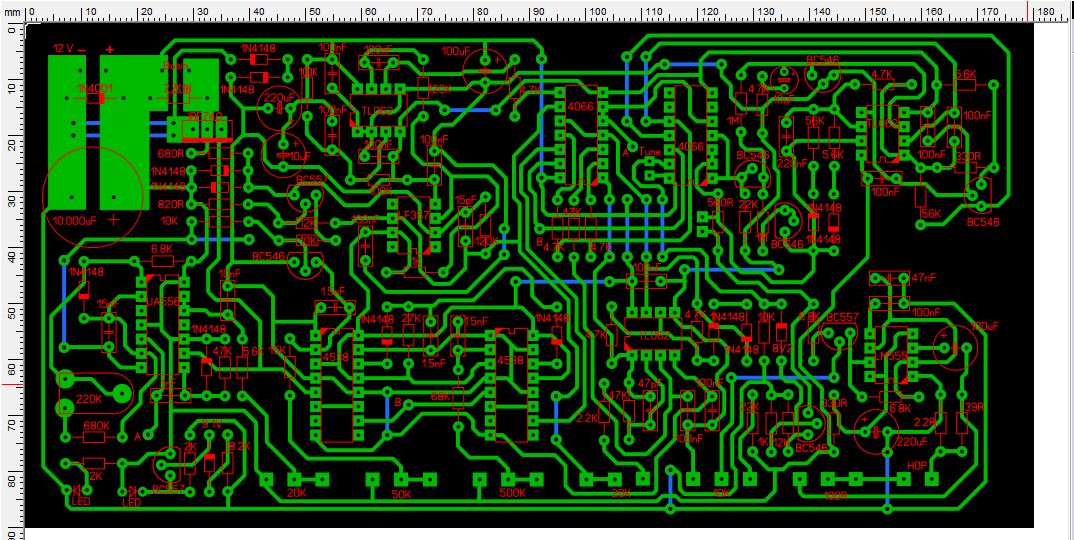

  • i recently built single layer delta pulse Click image for larger version
Name:	milan kraker.JPG
    The detector produces very very long tone after detecting a target. Sometimes the tone is nonstop unless i use the reset button.
    Has anyone else experienced the same thing? How this can be corrected?
    • i suspect this/turkish layout has 2-3 fatal mistakes. if you need a success without electronics basic knowledge you certainly must use just checked layout copied in thousands pcs.

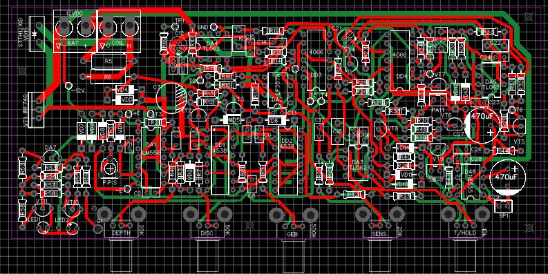

          • My delta pulse rev 5 is not detecting anything and beeping nonstop.I have checked voltage on +E 12v and -E 11.78v. T2 is tuned to 100Hzs.
            The problem started when due to poor detection depth i installed DSEI1210A diode and changed 100v ceramic capacitors C23, C24, C19, C20, C14, C15, C11, C9, C8 with 100v polyester due to poor. I have changed all ICs Replaced ceramic capacitors but the problem

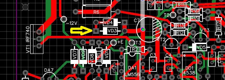

              • Delta pulse is giving nonstop tone and not detecting anything at all. I remove the MOSFET and the diode but it is still beeping.
                • Originally posted by chuubaba View Post
                  Hi chuubaba.
                  If your IC (LF357, TL062) seats in sockets, try to take out each of them, only one ic step-by step and see what happens. At first take out D4 (LF357), or desolder Sensitivity resistor, or one leg of R20 if you not have sockets on the board.
                  Often this problem may be coused by broken diodes 1n4148 (low quality) and D4, or simply by fake D4 op-amp.
                  • Originally posted by Vadim18 View Post
                    Hi chuubaba.
                    ..........Often this problem may be coused by broken diodes 1n4148 ....................
                    Thank you Vadim18. The 1N4148 diode located at VD3 was faulty.

                    I am sure you have very good understanding of this DP PCB and you can suggest a fix for "low detection depth" problem with big coil. I am using all components as written in BOM for rev 5.0 Click image for larger version
Name:	My DP REV 5.0 PCB.JPG
                    The frequency is 100Hzs. All resistors are 1%. MOSFET is 740 and VD1 is DSEI2010. Damping resistor is 680R 1W. Coil diameter is 400mm inductance is 396uH. Coil and connecting cable resistance is 6.7R. The entire PCB and POTs are inside a special metal box to block EMF . I can detect the iron in my concrete roof from 3 meters. A stainless steel pot size 95mmx105mm at distance of 76CM.
