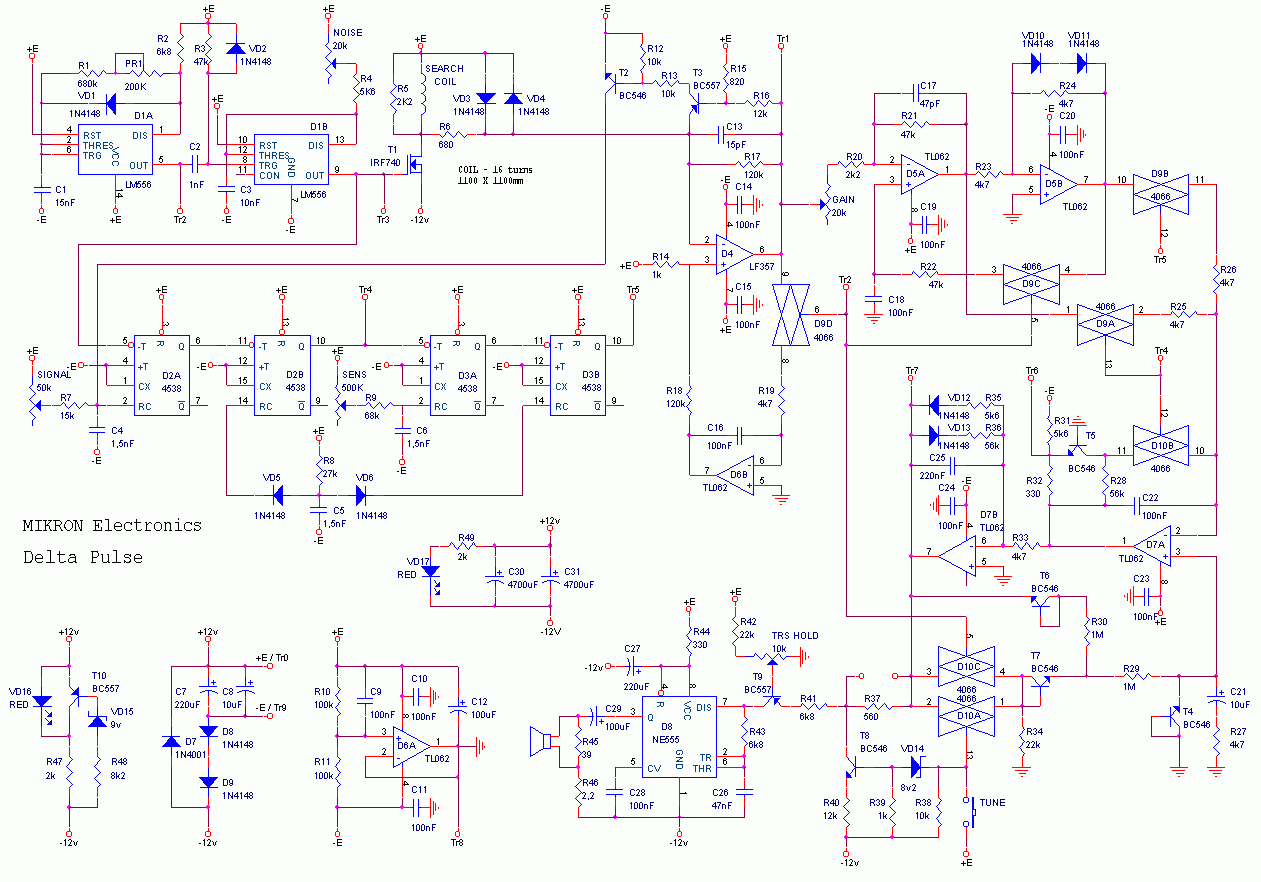

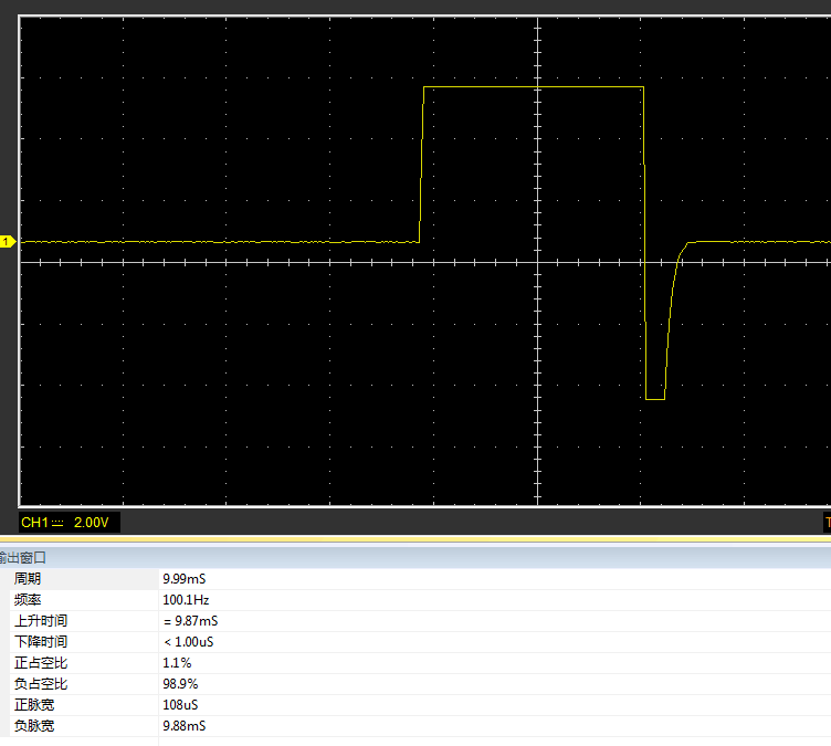

            On the issue of damping resistance.
            With the same coil, I used an oscilloscope to test the LF357's pin 6 waveform. The damping resistance was 278Ω, and the test IRF740 output required 180Ω, which is correct?
            Thanks in advance.
            Test video attached
            My job is sales of automotive coatings, and my hobby is radio, so the testing environment is relatively simple.
            • to reminder you that damping resistor in original schematic is 2k2?
              • The 2.2k resistance is too far apart.
                I think 278Ω is OK, I will continue to test this problem and make adjustments in conjunction with field tests.
                thank you for your reply.

                      I plot the XR-71 schematic, check for errors. It is often difficult to check my own work.
                      • if you draw in big CAD there is always method of the checking either schematic or pcb.
                        • Currently found two errors, updated and then send the schematic
                          • xr-71.pdf
                            I found 5 errors and modified it.
                            The schematic references the kt315 version.

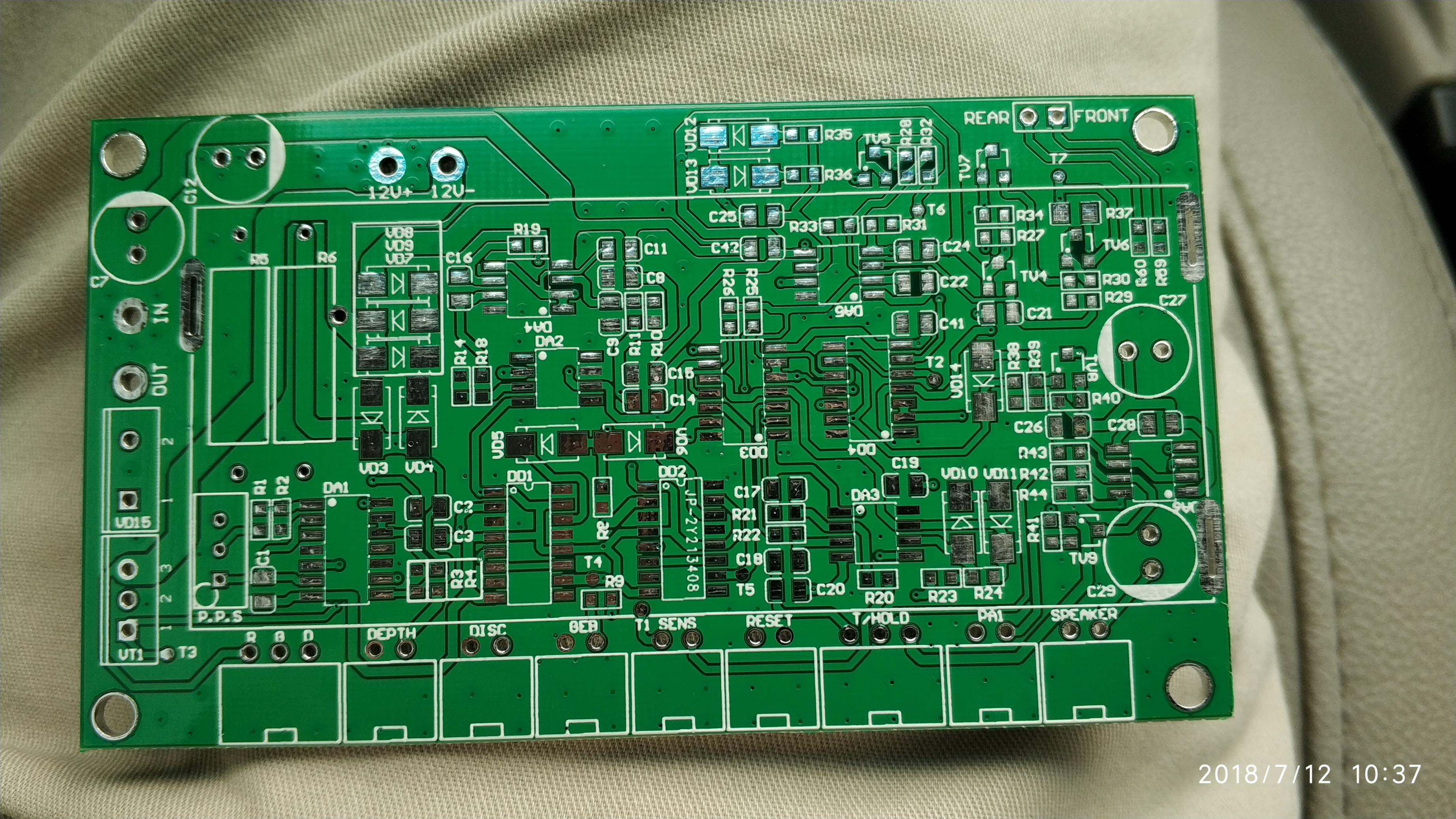

                            After the check is correct I will design the smd version of the PCB
                            • Dp/71 smd version is completed, the effect is very stable, there is no large coil test yet, the test distance of a copper coin is 30 cm for the current 23 cm coil.
