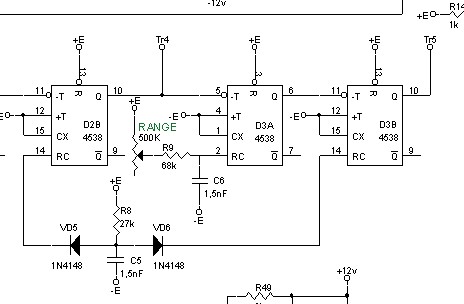

  • uncorrect i think. must be approx 45us. you have to check... op lala i can't use my schematic
    be cause i do not see your board to answer right.
    • I never saw this configuration of the CD4538 as monostable and the outputs marked with TR4 and TR5 I observe a square wave of 3uS
      Carlos
      • ok. give pic of C5 i could see the value.
        • also i think you do not set a knob of timing on your scope in fixed position. thats why you get wrong width.

              • Originally posted by Carlos View Post
                Carlos
                this configuration gives sure equal SAMPLE WIDTH for both TR4 and TR5. we need sure symmetric widths.

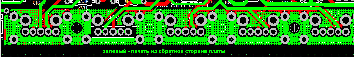

                  • pcb back side mirrored, as you see it
                    • Originally posted by Andi68 View Post
                      I do not Need a Bara any more.
                      I want to build a detector that finds a 1Gr gold nugget at 70cm depth
                      me and Andi want more depth on 1g of gold. 70cm. ok we can tune DP on this work.
                      tune FIRST DELAY to its minimal 15us. change R7 to 820-910pF. R7 to 7.5k. decrease R8 and C5 to decrease a STROBES' WIDTH to 20-25us.
                      • tune DP to 300pps. change C1 to 10nF and R1 to 160-180k.
