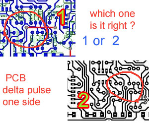

                      • Hi Hl54
                        You can see two various drawing Schematic diagram for delta pulse at this thread.
                        One from micron electronic and another drew by good friend Vladimir in proteus area
                        These two are ok and without error.
                        About pcb , I don’t build tow layer but single layer is ok . I change some section of
                        Singel layer pcb that you saw the version of it in this thread .
                        And my result with 40 cm diameter coil in air, can be detect soldring grease box with
                        6.5cm dia between 70-90cm.

                                PCB image
                                HI! KT-315
                                I DECIDED TO BUILT THE DELTA PULSE AND I PREFER YOUR PCB DESIGN. SO THAT I NEED THE PCB WITH COMPONENTS LAYER.
                                IF YOU HAVE THIS PLEASE ATACH HERE.
