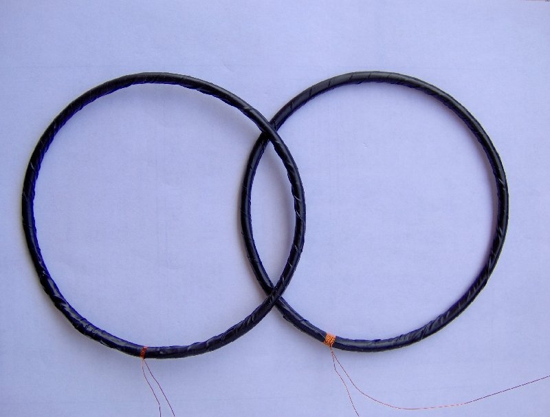

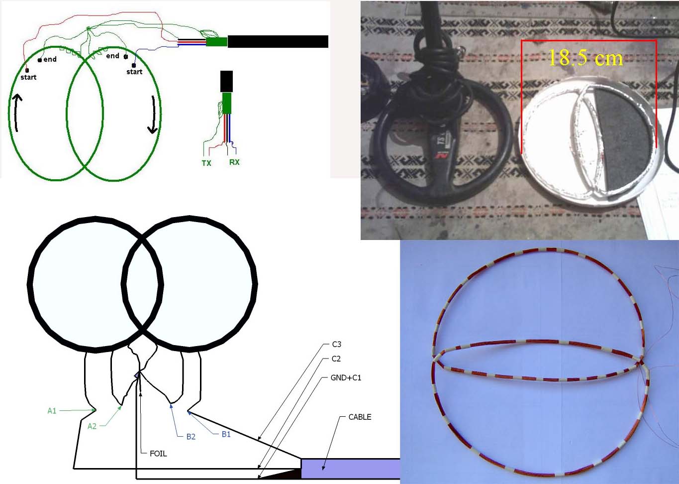

    my intend these Pictures duple coil instead one coil.
    is it enough two Pictures good ?
    those coils are for gold scan.
    • Hi hl54.
      Photos are OK But..........
      Delta Pulse is designed for mono coil use.
      A DD coil or a OO coil are not for gold detection at PI detectors.
      They used to cancel at a degree the electromagnetics interjections.
      At my country i used DD coil with PI only once that i wanted to detect a place under a HV line (400KV).
      The photos that you attached was for a VLF detector (from Golden Sabre thread) not for a PI. So for the Delta Pulse try a mono coil.
      If you want a detector to discriminate gold then maybe a VLF is better

                  • Hi all
                    I wonder can we use computer IDE cable for making coil .
                    connecting wires on IDE cable to get coil
                    it contains 40 wires.if we use 2 ide cable get about 35-40 cm radius
                    if somebody want to try...
                    Erol
                    • Hi, i made a coil with a form like this, the base of the is 35 cms and the front side is 25 cms of pvc. I also used pc net cable (8 wires).
                      I place 3 turns inside the pvc form and i made 6 wire joins, this gave me 535 uF.
                      The results are excellent. 1 cms coin is detected at 15 cms. A 2 cms coin at 28 cms, a solder grease can (6.6 cms in diameter at 40 cms) a metallic fence at 1.5 meters. What can i said? I m realy satisfied with delta pulse.
                      Now i m looking for a good case and to do some real field test.
                      When i have the time i will post my coil pictures.
                      I also tried a 19 cms round coil with good results for smal and medium side metals.
                      Nelson

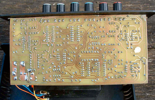

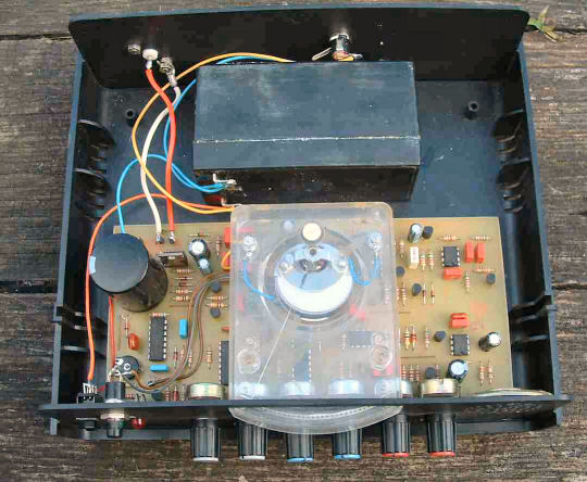

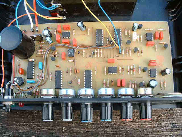

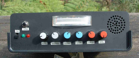

                      • Hi,
                        I finallly finished my DP.Working fine,first tests shows a coin at at least 25cm , 45 turns 0,8mm on 25cm form.
                        I have found pictures posted by others usefull, so here are a few ones...
                        regards,
                        Fred.

                            • Hi
                              Thanks,
                              I post here the files i have used.They are not from me , they were on this forum.But i repost anyway, i think it is easier.
                              The PCB and files are 100% OK,except the Volume pot that works reversed.Not a big problem, and easy to correct.
                              I wish to thank the author of the PCB .Nice job.
                              Fred.
                              • Hello Fred.
                                Thanks for the foto's , now go for gold
                                Regards.
