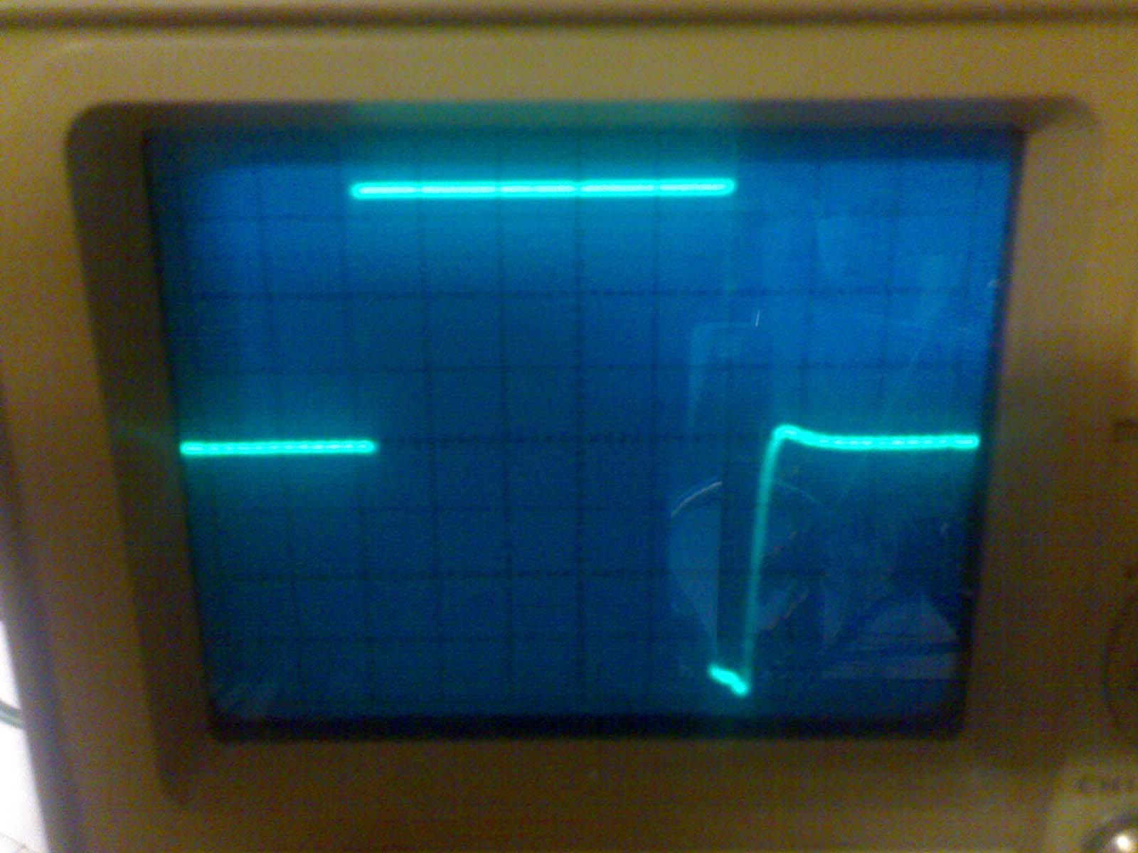

        • Channel 1, 20 Volts/d ???

          See attached picture, channel two show pulse on gate irf740.
          (upper waveform)
          Channel one show output of amplifier, pin 1 of TL062.
          (lower waveform )
          The Channer one is 20.0 V... I believe that the PIN 1 of TL062 can't go to more than 5-6 Volts ????
          Some body have another wave forms, my DP have problem now, I need. For example, the PIN 6 LF357... ??? All TRs ???

          • Hi
            diminute ,Tek oscilloscope had probe multiplayer button with 1x, 10x, 100x, 1000x ranges
            Please see again picture probe multiplayer button set on 10 x, thus your real voltage is
            20/ 10=2volt per section, amplifier out put level are 8.8 vpp.
            • Originally posted by aft_72005 View Post
              Hi
              OH!!! thanks.
