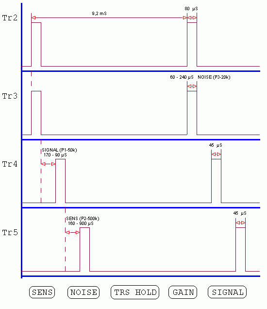

            • help with DP
              Hi! all
              I finished my DP (elbombaci PCB) and...not work very good. It can detect a coin (25mm bimetal) at 2 cm only.
              Gold...nothing.
              I experimented a variety of coills, change frequencies and...same thing!!
              Have someone for help me please?
              DIRCEU
              • Hello
                pls look page 16 .Check Pcb error picture on page .
                Check your diodes.if lf357 getting hot change it.
                Erol

                  • Delta Pulse
                    Dirceu , Time to get out the Oscilliscope !! Check Q1 if its getting hot. Check your supply voltage and also your potentiometer connections and solder joints. With oscilloscope check where signal is missing or not enough gain . Your at the best part of the project , Getting it working !!! Do not give up , the Delta Pulse is a Good Machine ...Have a Great Day !! Eugene

                      • Hi DIRCEU
                        anything new with your DP? I have same problem, detection is poor.
                        • Delta Pulse
                          DIRCEU , DONT FORGET ALL THE DIODES , MAKE SURE THEY ARE NOT BACKWARDS , LIKE I DID MANY TIMES .... Eugene
