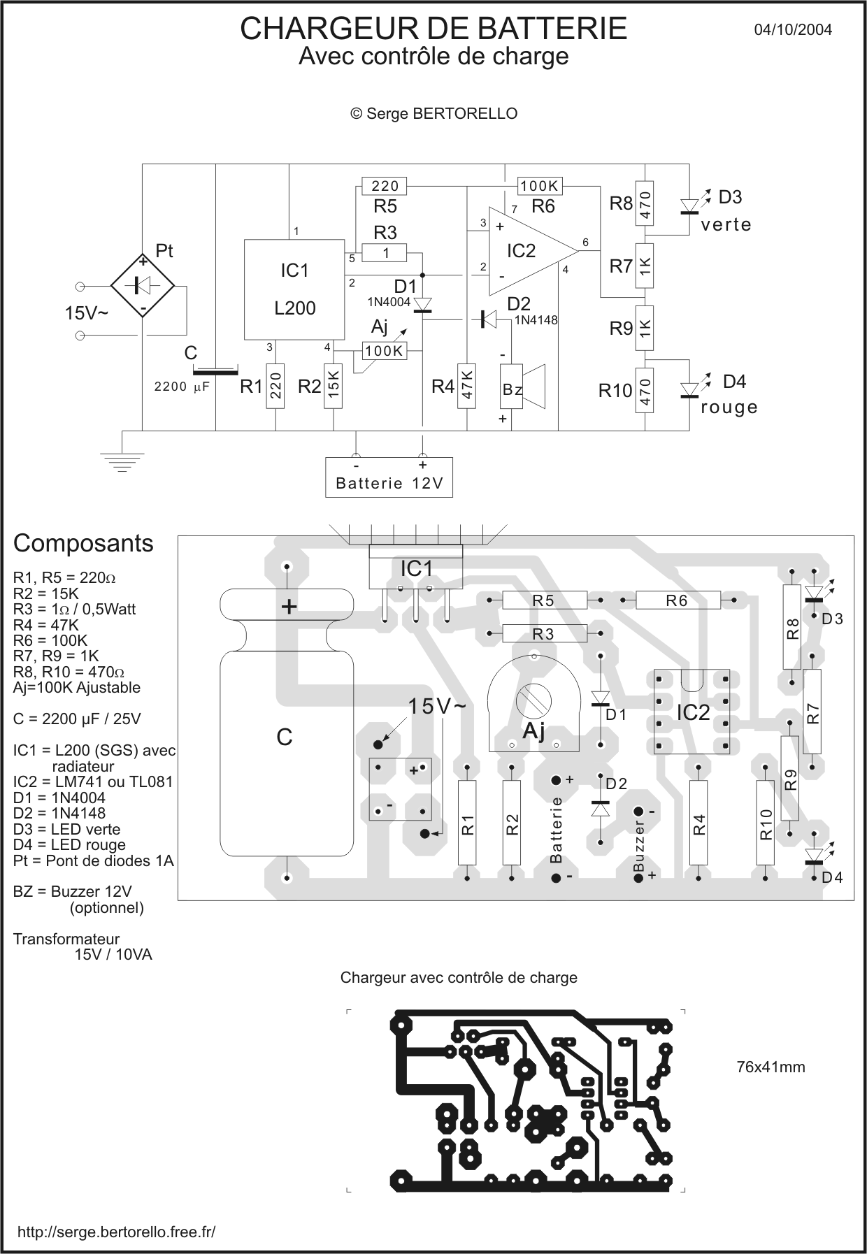

    hi all
    a have this charger schematic i have all components except L200 can i replace with LM317.how ?
    thank you
    best time

    • Hi pigeon
      try
      best time
      j. chargeur%.zip

        • Originally posted by jap View Post
          Hi pigeon
          try
          best time
          j. [ATTACH=CONFIG]22487[/ATTACH]
          pls give a password on the ZIP. tia
            Hi pigeon
            try
            best time
            hi Jap
            I try this
            thank you very much
            best time
            P.
              password is "jap"

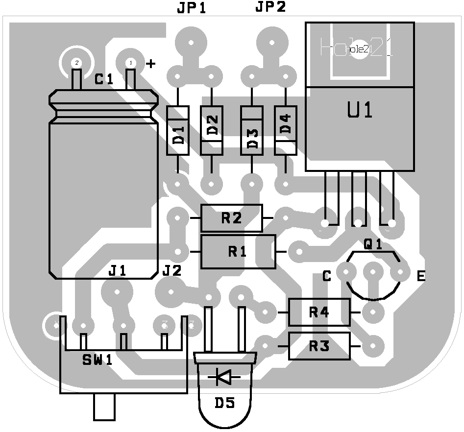

              • thank you jap and maikl. here is a charger schematic White's uses for XLT, DFX etc.
ID:	334342Click image for larger version
                  Hi pigeon
                  try
                  best time
                  hi jap
                  can you give me the exact mounting resistance AJ 5k?
                  thank you very much
                  best time
                  • Hi pigeon
                    Simply look at this drawing and u will understand the value required of R adj.Click image for larger version
                    best time
