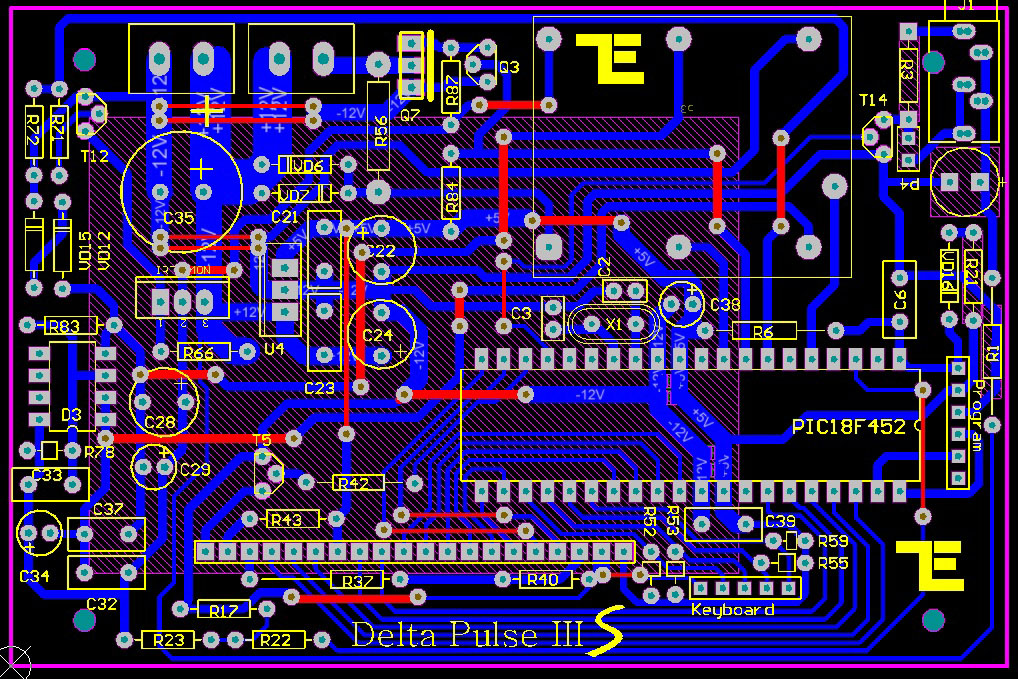

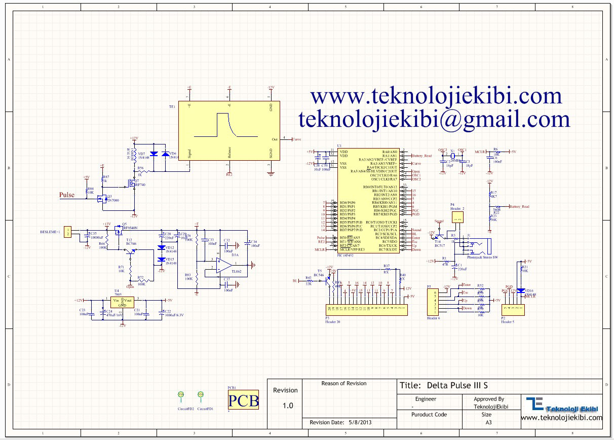

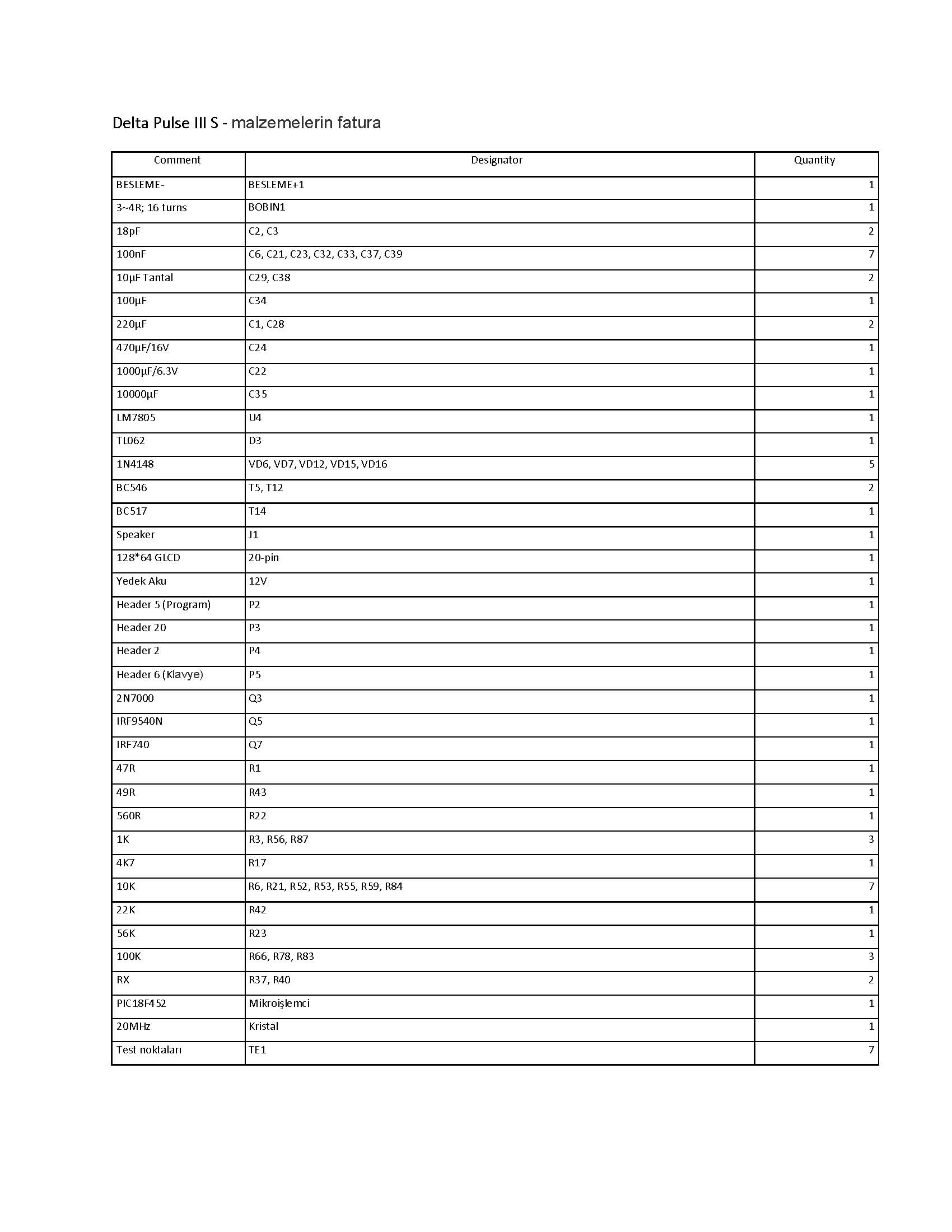

            Hi Alonejax
            I think that there has been an improvement in the development of the Delta Pulse 3. As you very well know, this version of the Delta Pulse has suffered much from instability problems and is very sluggish in its detection response.
            The turkish site has posted some information on a modified Delta Pulse 3 which is now called Delta Pulse III S and the circuit is reminiscent of the Crazy-Star-1 lite version. If the Delta Pulse III S is able to discriminate between ferrous and non-ferrous metals as well as the Crazy-Star-1, it promises to be an excellent metal detector.
            I post here the PCB, circuit and bill of materials for anyone who may be interested in it. However, we will need the hex file for the PIC18F452 microprocessor. Hopefully, someone out there may be able to help us with this. I hope that the software for this promising version of the Delta Pulse III S will not be a 'crippled demo' but a version with, say, 500 on/off cycles like the PIM-2 detector, so that the amateur detectorist can go ahead and build this one.
            Obrigado
            Ciao
            Speedy_G

              • Originally posted by Speedy_G View Post
                Hi Alonejax
                Obrigado
                Ciao
                Speedy_G
                [ATTACH]24877[/ATTACH][ATTACH]24878[/ATTACH][ATTACH]24879[/ATTACH]
                Hi dear thank you for posting and reply for evryone. But this is not the right place to put this here. 'cause like that we will
                the disarray member.
                You can put only this link is its correct for guide the member
                Nicolas

                  • Originally posted by Nicolas View Post
                    Nicolas
                    Hi Nicolas
                    I agree with you totally. Considering that the Delta Pulse 3 has been a no-starter from its inception, I suggest that one of you so-called Gurus begin a new thread for the Delta Pulse III S and take it from there. Any suggestions who might do this?
                    Obrigado
                    Ciao
                    Speedy_G

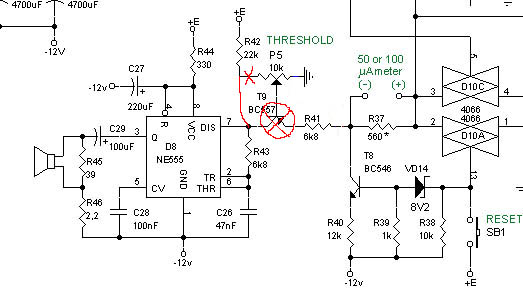

                          • Hey, anyone can help me, delta I no sound, unable to detect metal, LF357 output signal with pulse output, 556 normal, 4538 tenth foot no pulse output. When I touch T5E pole can be gained when the short sound, when I took the T2 has a very good voice can detect metal, return the T2 triode and tracking problems like the original, where the problem, I want to check there

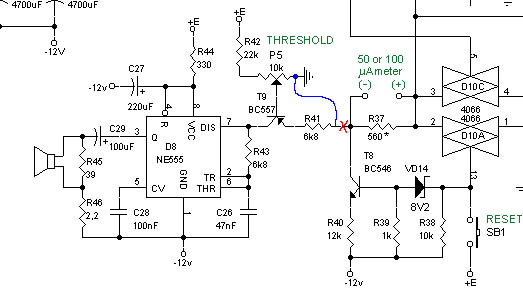

                            • try these ways
ID:	336278Click image for larger version

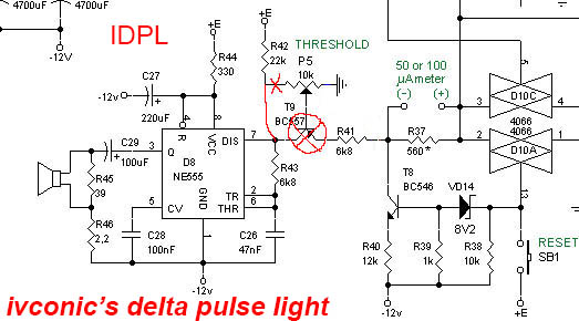

                              • .... and may be this
