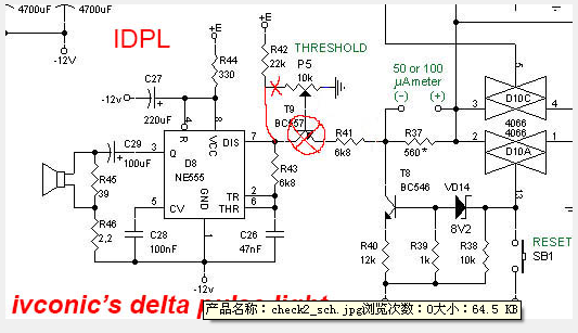

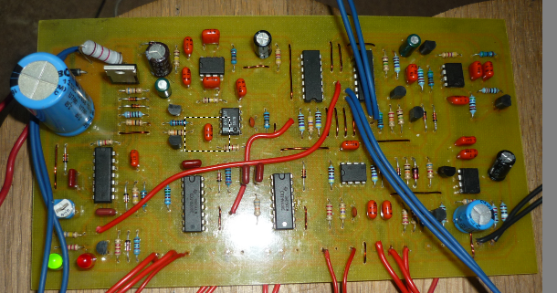

  • Hey, anyone can help me, delta I no sound, unable to detect metal, LF357 output signal, 556 foot ninth pulse output, 4538 tenth foot no pulse output. When I touch T5E pole can be gained when the short sound, when I desoldering T2 has a very good voice can detect metal, welding T2 triode when problems with the original, the problem in that, I want to check there
    • Thank you KT315, pulse sound according to this can be based on, touch T5E no soundClick image for larger version

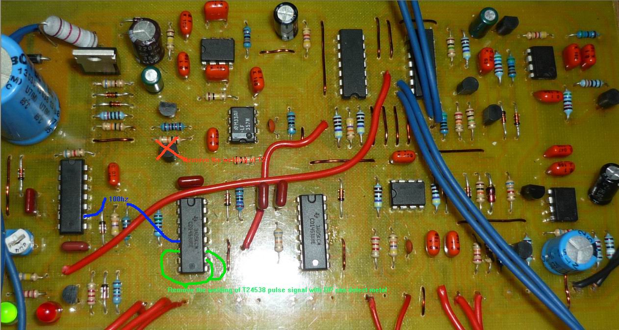

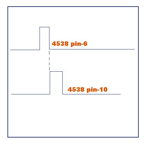

        • Hi, who can help me, my Delta 556 feet 9 Pulse Output, 4538 10 feet without pulse output, I check there

            I do not know if pin-10 signal will be longer or shorter than pin-6 signal... my point is that the pin-10 signal directly follows from pin-6.

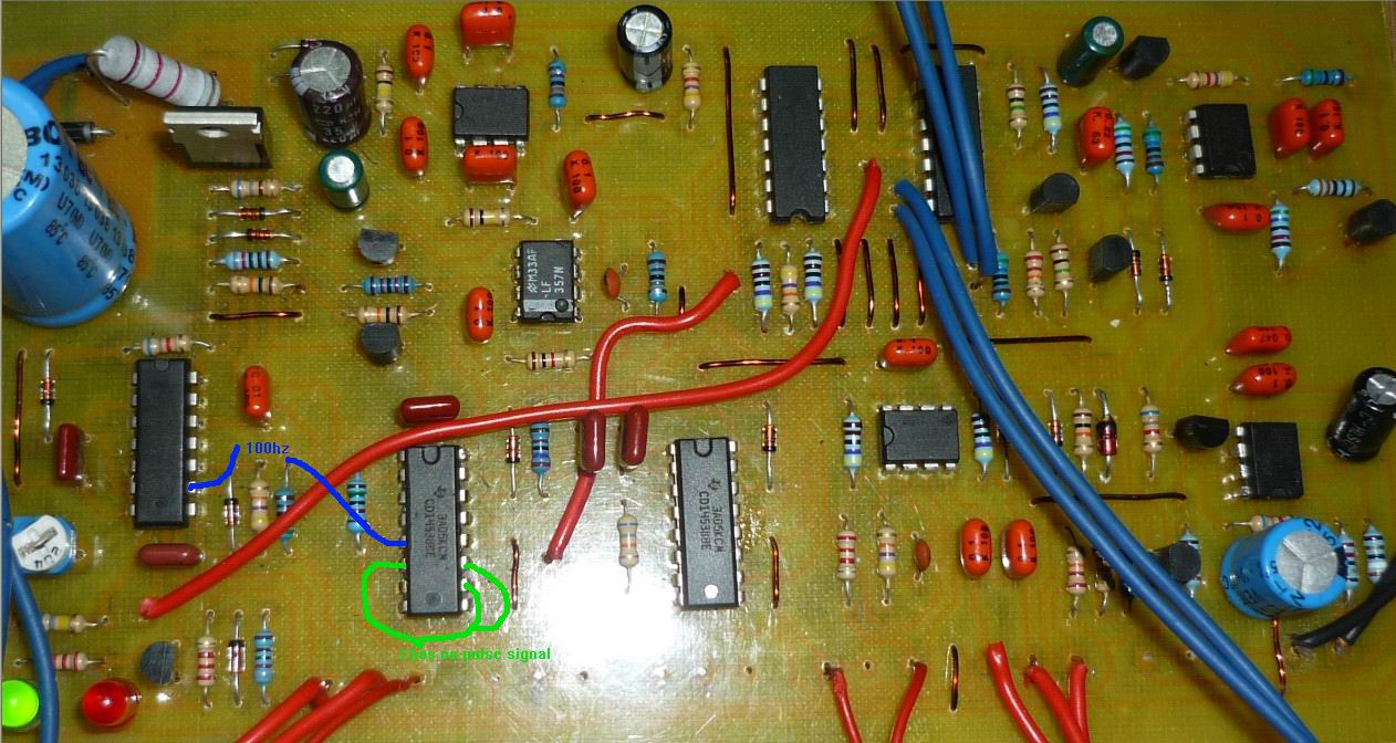

            • 4538 sixth tenth foot no no pulse signal, only the sealing off T2 or T3 can detect metal, the signal is not stable, and no pulse t2t34538 weldingClick image for larger version
                pin 6 is DELAY timing (variable value). pin 10 is STROBE LENGTH FORMER (fixed value). in both cases, in both 4538's.

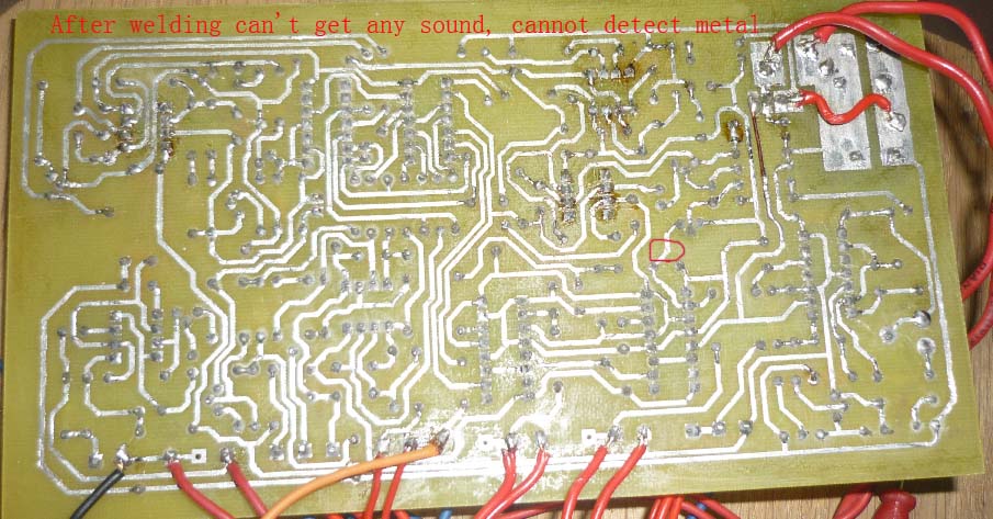

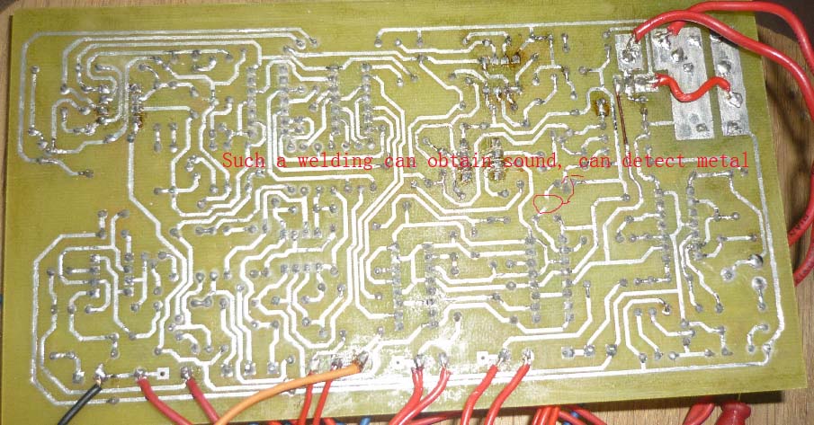

                • Welding can be sound, can detect metal but not stable, after welding can't get any sound, does not matter, can be detected by the metal, how be to return a responsibility, I should check thereClick image for larger version
