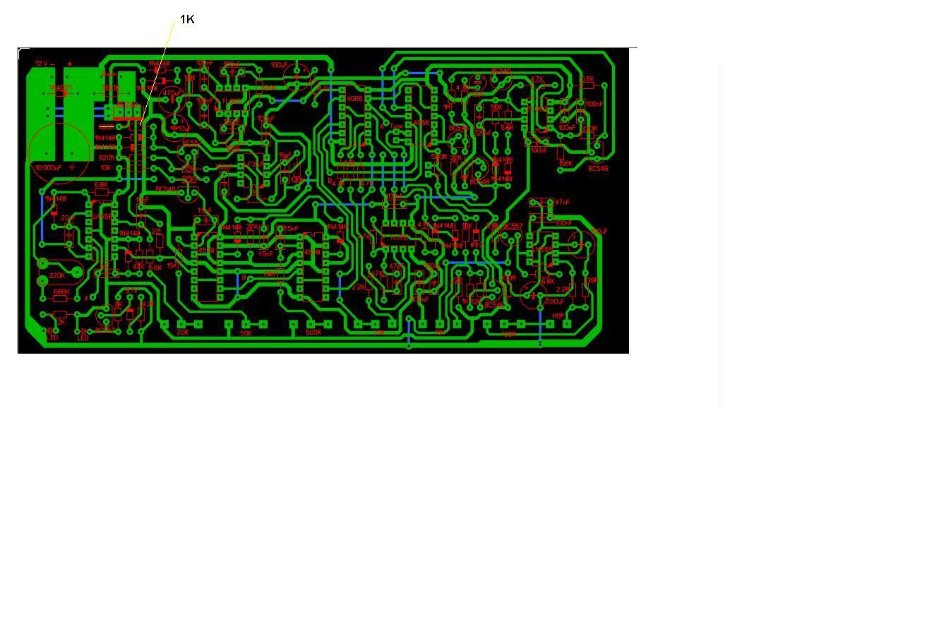

              i hange these value :
              R49 :
              i get 70 - 92 hz for PPs so i change it by 560k
              if i change it by 100k i get 200 - 600 hz
              which mode is best 100k or 560k?
              which frequency give more depth ( 100 or 500 hz )
              SENS :
              for more sens for gold i change R7 and R9 to 10k . who can help me more ? how can i get more sens ?
              Depth :
              my detection is not well a coin(2.5cm ) in 17cm , and i need data for main coil and Damping res.
              my coil is 0.7 mm and 495mkh and damping res is 560ohm.

                  I do not understand, "my coil is 0.7 mm."
                  In the photos you sent me by email I can see that the coil is 20 Cm in diameter.
                  That power supply is using?.
                  Something is wrong with the reverse voltage (47 volts. Should be 400 to 500 volts).
                  Perform tests with a battery of 12 volts Gel, fully charged.
                  Sensitivity of 17 cm for the currency, it is a good start.
                  I apologize, R6 should be 1K. Deputy scheme.
                  Jose
                    my means tickness is 0.7 volt
                    no i use 12v ,7.2Ah battery (seald lead acid )
                    it is true , because i put prob on *10.so it is 470volt p-p
                    i am sure it is bad . another friend get 27 cm with same coin but i try today and get 23cm and it is yet bad ( i think )
                    in my photo that i send you my damping res is good ?
                    for more sens for gold i change R7 and R9 to 10k, i replace them ??
                    EDIT :
                    Which resistor better for damping coil , carbon composition Resistor or Wire Wound Resistor ?
                    • Mohandes
                      17, 23 cm, sensitivity is a good start. Not to say that this right, I think deve reach 30 cm. for a coil diameter of 20 Cm.
                      What remains in my view, is to improve the coil, and resistance cushioning.
                      495 uH coil seems high, reduce bueltas to achieve a 400 uH or less. The coils I got good results fueror made ​​with Cat5 cable, in many parts of the forum discussed as perform them.
                      The best value of the damping resistor is obtained experimentally, the ocilogramas seem fine.
                      As mentioned before:
                      To reduce delay time: R7 is 8.2K; C4 is 1 nF; C6 is 1 nF.
                      Assay coins, start with 300 Hz and 150 ns for TX, try higher frequencies, but be careful not to overdo the TX pulse width.
                      470 volts flyback, is fine.
                      Jose

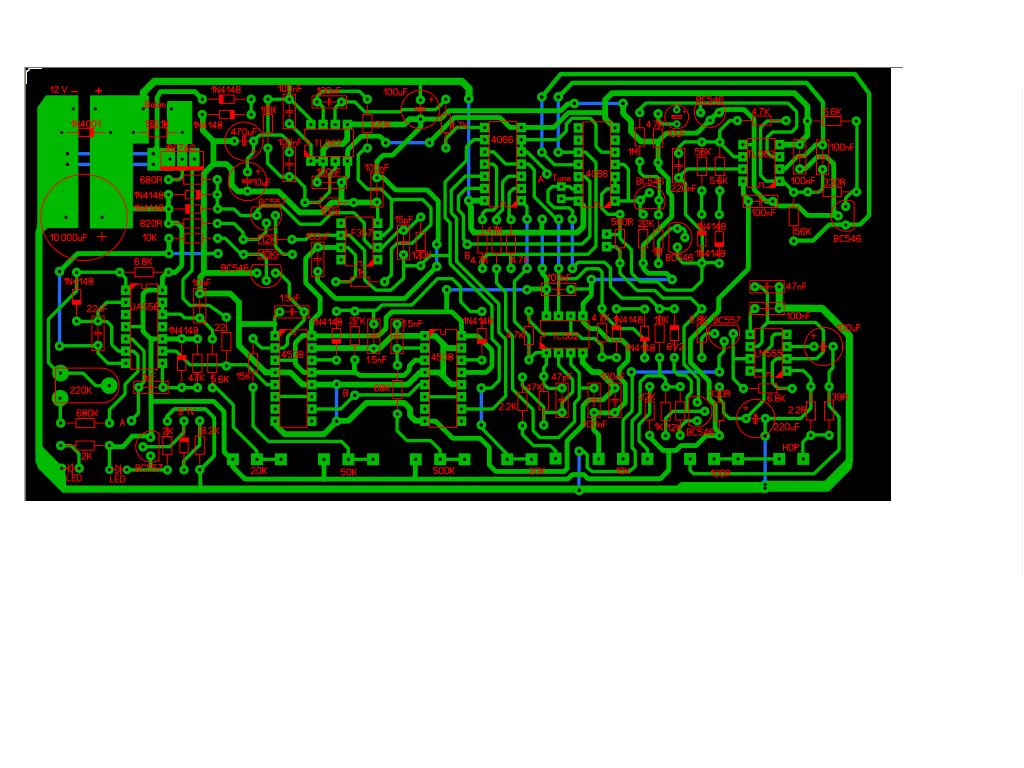

                            • silk mask
                                silk mask
                                thank you very much
